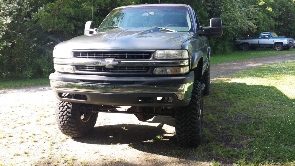

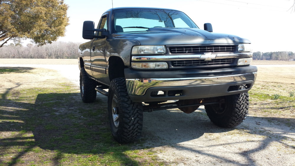

Here's some recent pics of it all cleaned up with the new to me Goodmark steel cowl hood!
Looks good man! You should mail your old hood to user "blaze" since his is the same color but has two fist sized dents in the front.
I've thought about selling it...but knowing my luck something would happen to this one. He's got your old truck, right?

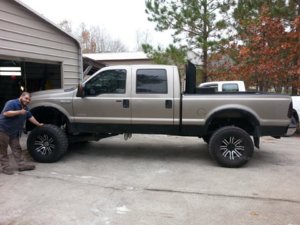

From about 7:30 Friday night until somewhere around 5 on Saturday evening four of us pulled a trans out of a Silverado, I swapped in my locker, and we put a 6" ProComp lift on my cousin's 2005 F250. All nighters aren't so bad with some good company and entertainment. :rockon:

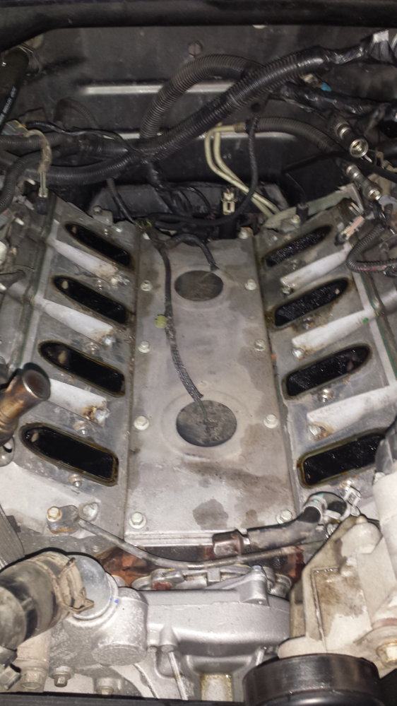

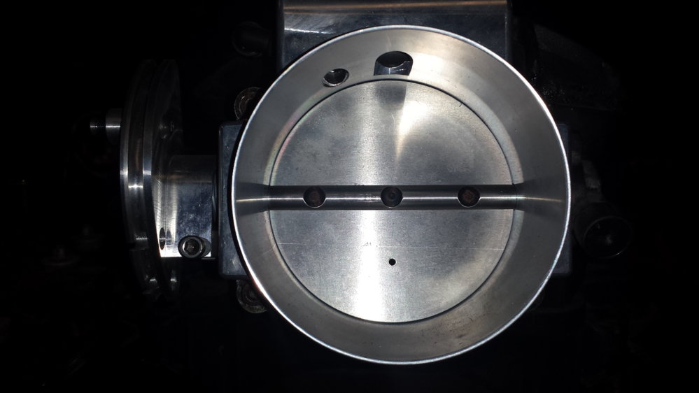

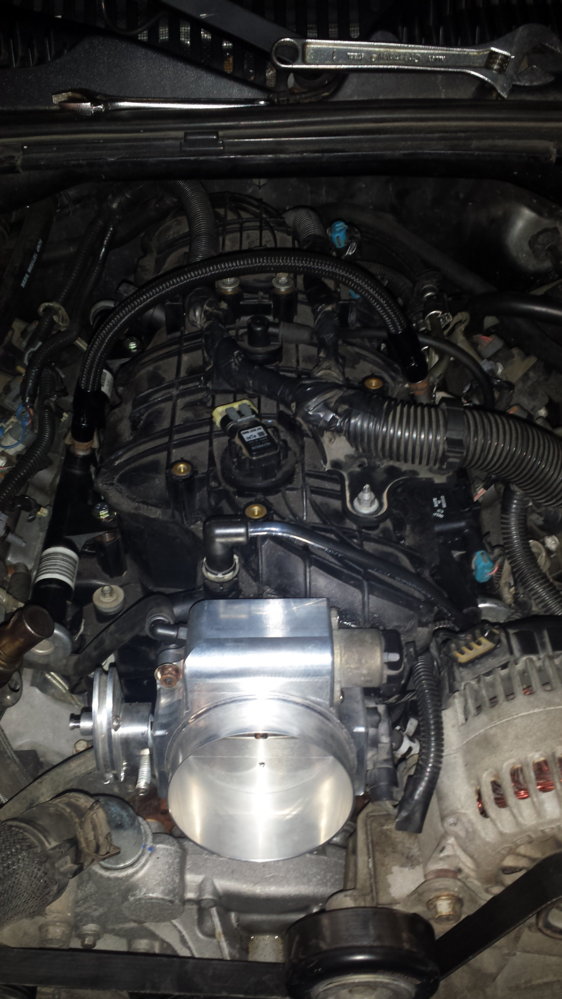

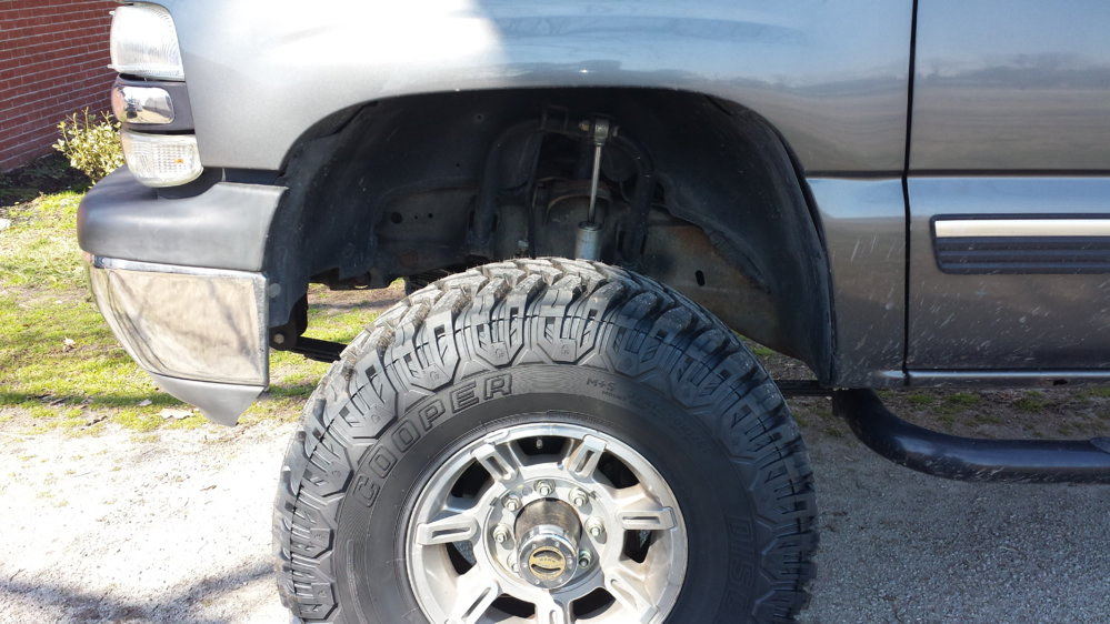

Been a while since I updated. I picked up some new tires; I went with 37x12.50-17 Cooper STTs and I love them so far. I also FINALLY got around to swapping the intake manifold and throttle body. I bought a stock TBSS manifold and a ported TBSS manifold. I went with the ported one on the 6.0 and a Nick Williams 92mm throttle body. Without any tuning so far, it's a completely different animal pulling through the lower RPMs. I'll try to get some pics of the modifications I had to do to the fuel rails, fuel supply lines, fuel rail crossover, and the intake piping. All in all, it turned out nice and looks fairly stock!
The next things on my list are a front driveshaft and long tube headers. I finally found some that will fit around the rear spring hangers and still clear the front driveshaft. After that I've got some 4.56 gears and I need to set up a panhard bar in the front.
I'll get some pictures soon!
I finally thought to get some pictures. Here's a few of what I did under the hood a few weekends ago, but oddly, I didn't take one of the finished setup with the 4" intake pipe I made. There's also some of how the truck sits now. Enjoy!
The intake and throttle body have made a huge difference. I'm anxious to see what the dyno says, but I'm going to wait to get long tubes on before I bug my buddy to use his dyno again :D It really makes a holler when you give it some skinny pedal and it takes much less pedal to get the RPMs I want. The tuning parameters changed quite a bit as well. It was very interesting to see how much more air is running through this motor with such a simple swap and it makes me realize how restrictive the stock truck manifold and throttle body can really be!
I also have a front driveshaft on order for this truck as well as my buddy's old Dodge. Both shafts are getting a 1350 CV, 4 bolt flange with a 1350 joint at the axle because both trucks have been kind of a pain in the ass to get the front driveline angles anywhere near what would be ideal. So, screw it, if I can get the operating angles I need...then all I need is money to make it happen :rolleyes:
Please ignore the dragging ass of my truck....it's not on purpose! The shackle flip is next on my list. I'll be moving the front axle forward an inch as well as adding another inch of lift. The 37s are a little tight against the back of the front fenders and the side steps.

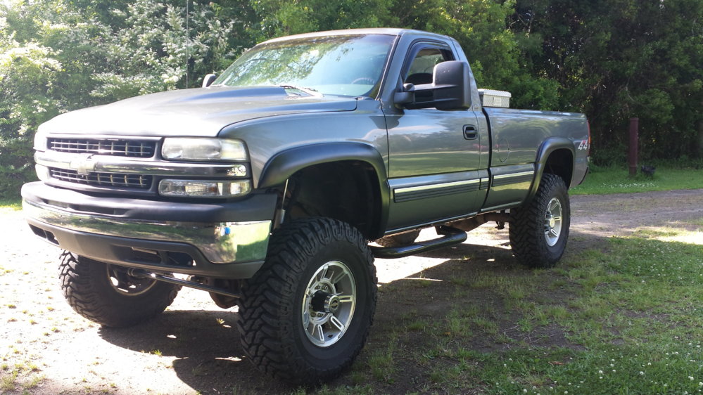

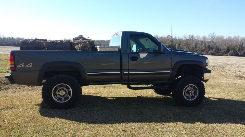

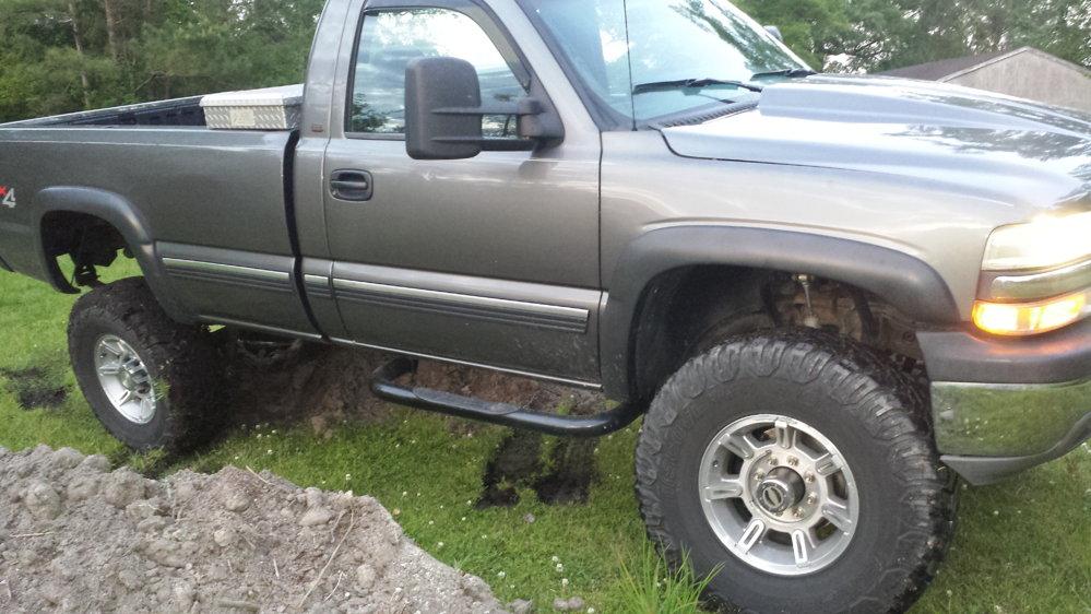

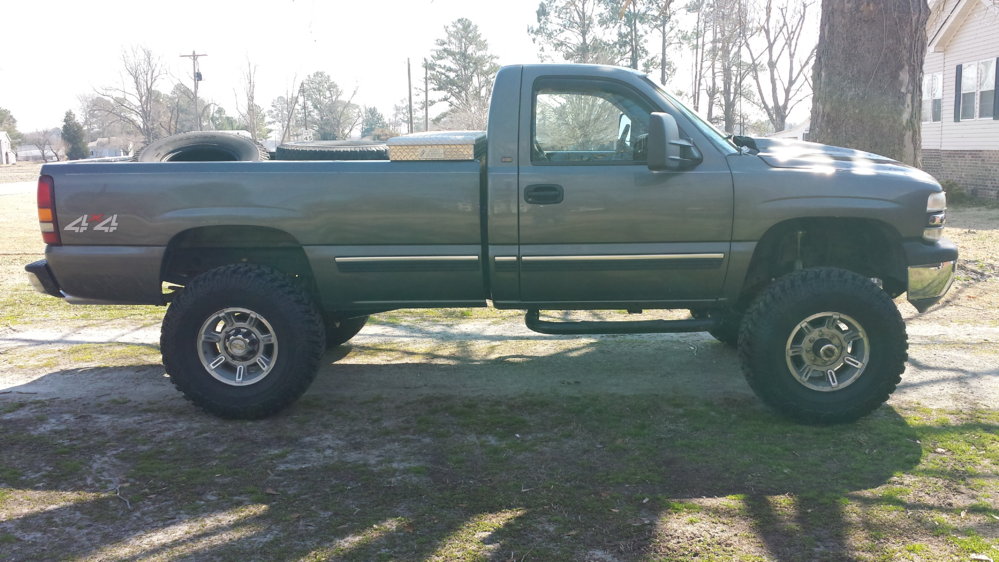

I realize that I've been slacking terribly on posting any pictures of this jewel. So...I'm going through my phone and posting a handful of pics from the last few years. I've done quite a bit of work to this rig and it's come a long way. It's still my DD and is doing well.
Since the last updates I've added:
Pacesetter 1.875" long tube headers, 3" exhaust, high flow cats, and a DynoMax Welded dual in/dual out with an internal X pipe
Moved the axle forward some more
Shackle flipped the rear with 6" USDR shackles
Added a Super Flex u joint at the front axle to keep the joint from binding
Picked up some fender flares on Craigslist

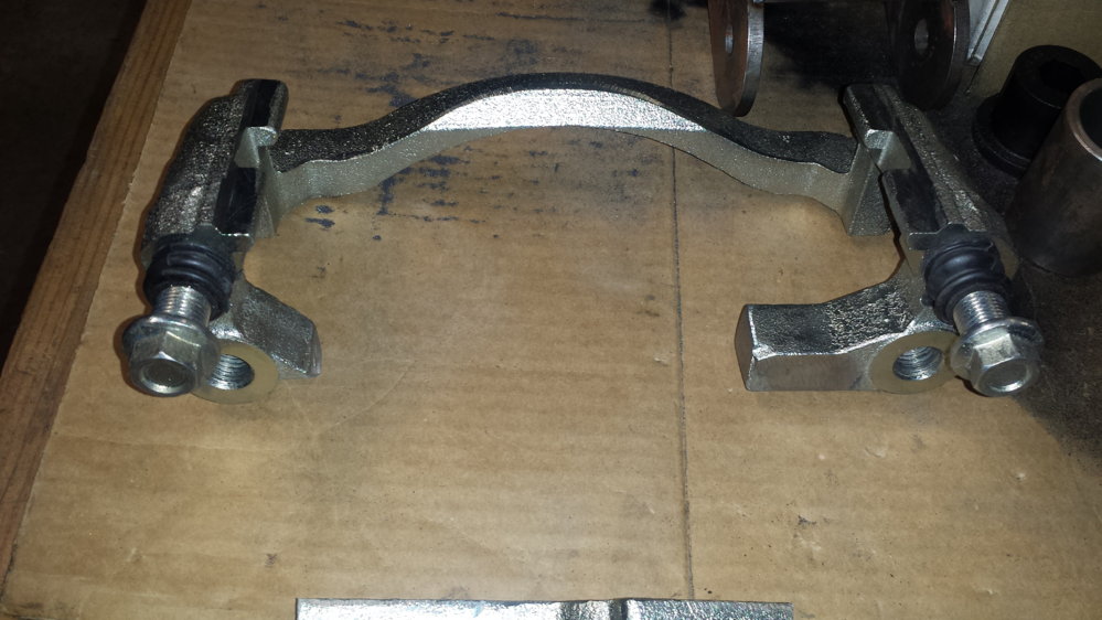

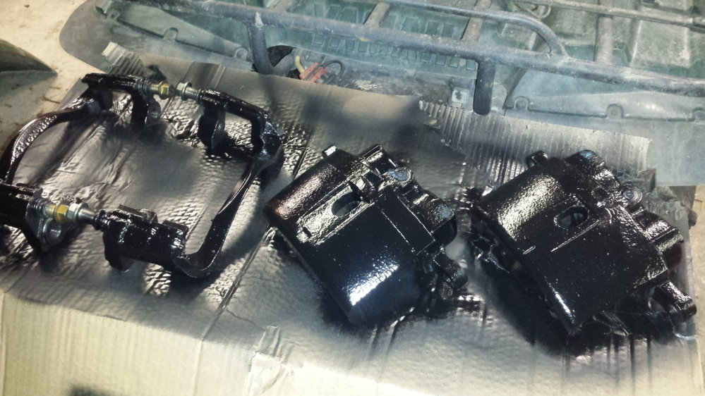

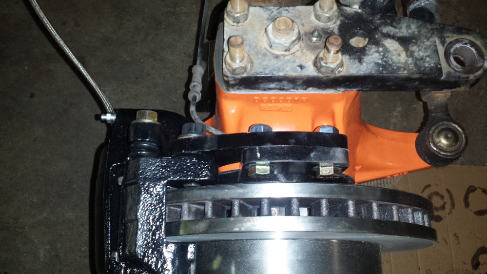

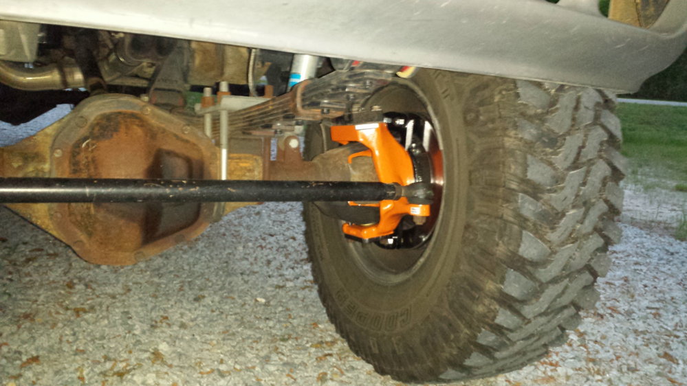

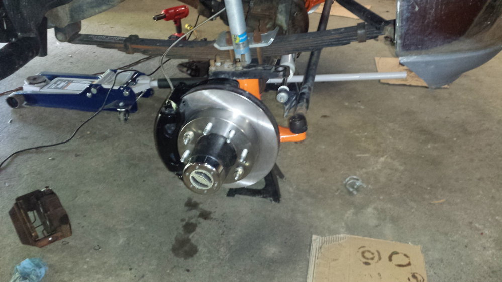

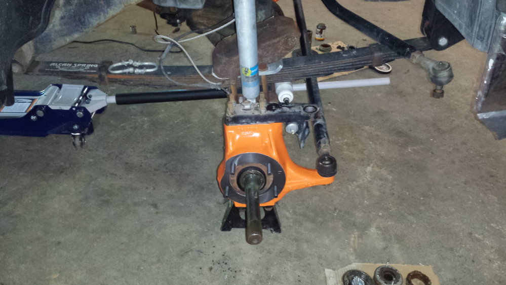

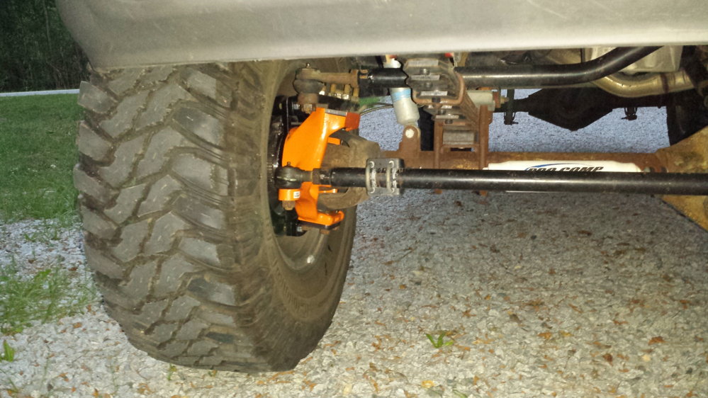

Front spindles, wheel bearings, Reid knuckles, WFO 2500HD brake swap (everything from the inner Cs out is brand new!)
LS Performance Wiring 05+ electric fan wiring harness

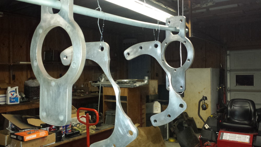

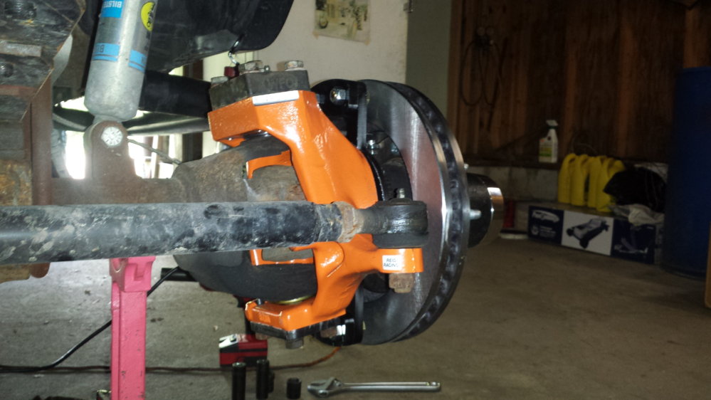

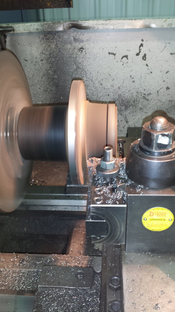

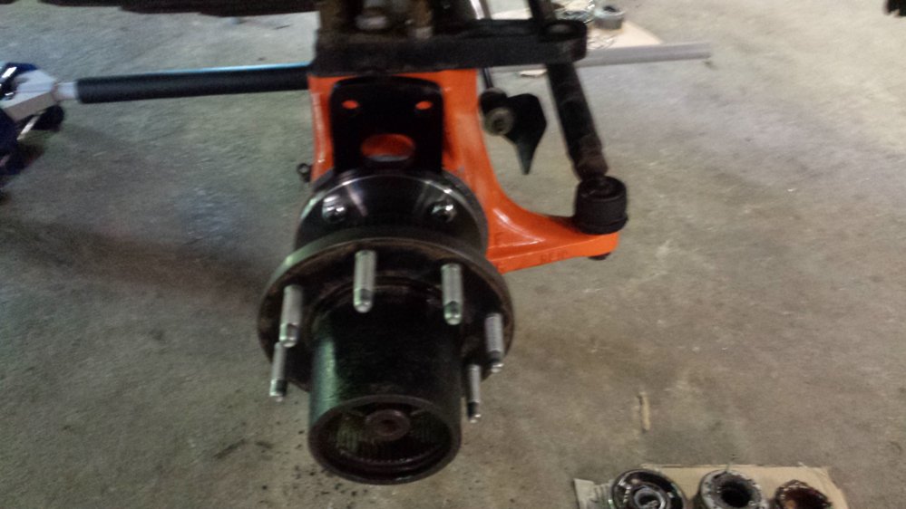

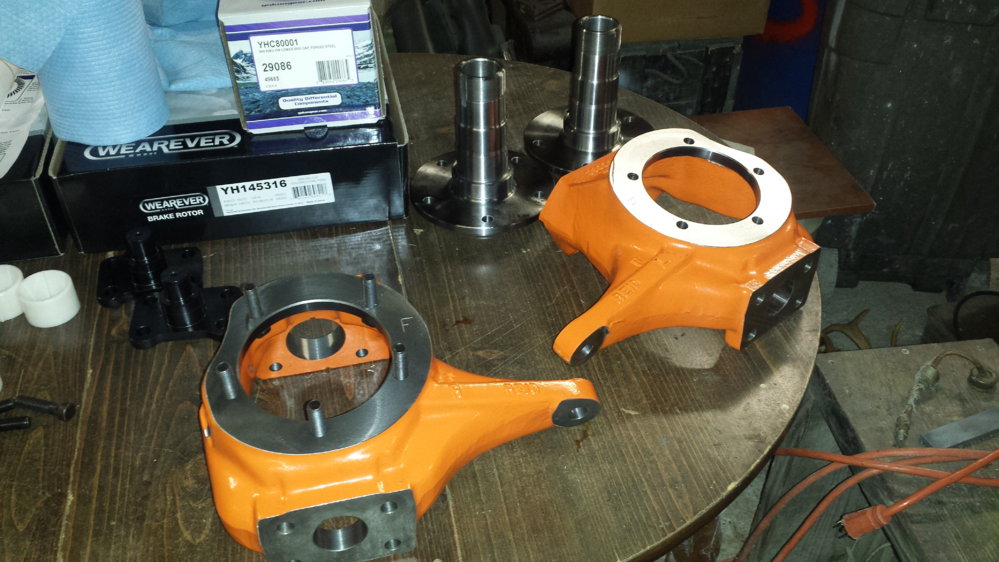

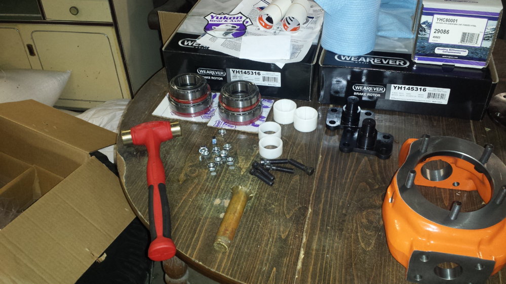

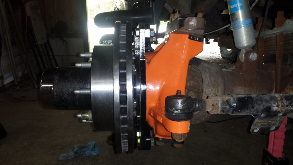

During the large amount of front end work done for the brake swap, I did a little machine work and finally swapped the front hubs over to 14mm x 1.5 studs to match the rear which was a pet peeve of mine and now all of the studs/lug nuts are the same. The ABS is fully functional as well and now all of the brake components are readily available at any parts house and I have a much better array of pads and rotors to pick from. It's also very nice having a slide off rotor now.
The stock 1/2 ton master cylinder works very well with the 2500HD calipers, surprisingly. A 1/2 ton uses a 34mm master cylinder bore, whereas a 2500HD uses a 37mm bore. It works so well right now that it's not a high priority, but eventually I'd like to swap to the larger, 37mm master cylinder to really match all the rest of the brake components.

I wish I had done this brake swap months ago. The Ford dual piston calipers really sucked compared to this new setup. It'll actually (damn near) lock the brakes up now. As big as they are, you'd fully expect that from them.
