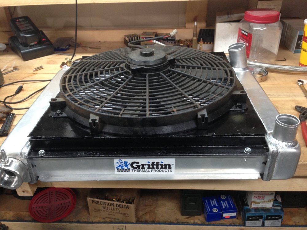

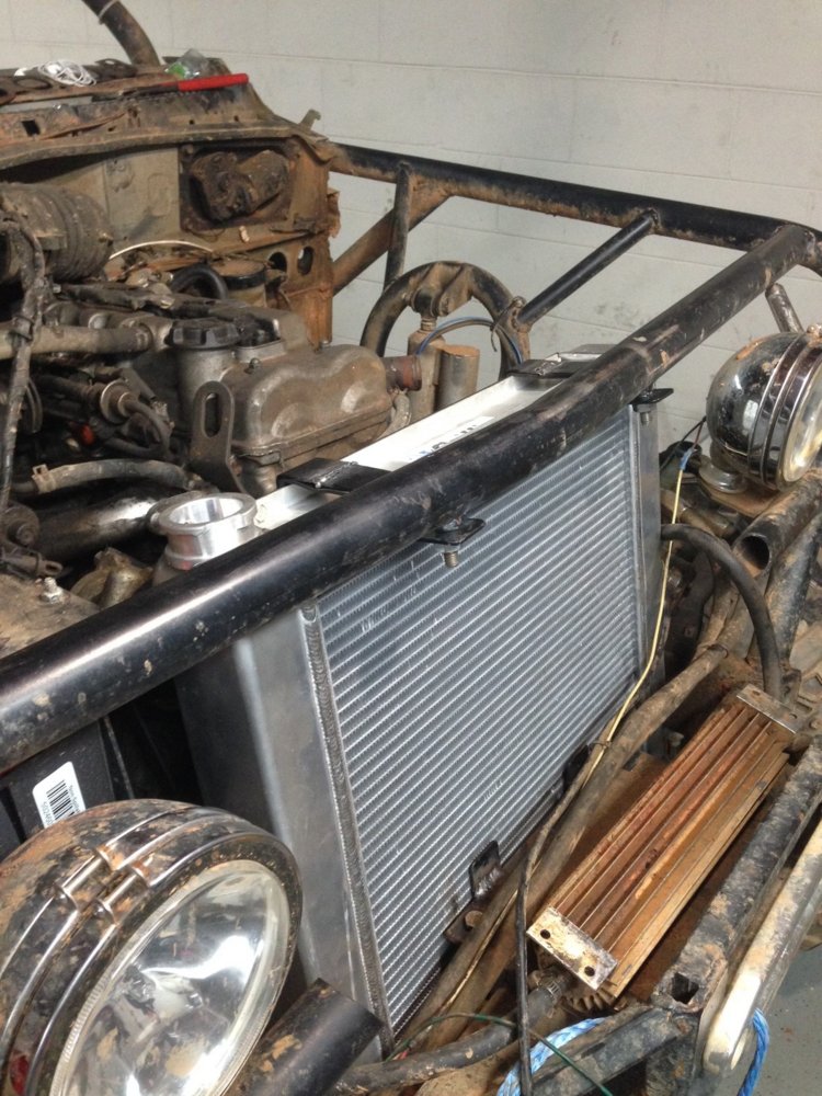

It is a universal radiator from Griffin originally made for a Dodge I believe. Drivers side inlet and outlet. Built a fan shroud out of some angle and 1/2" square tube. Adapted the massive outlets to the stock size with some exhaust pipe reducers. Stuck it in there. Not a whole lot of room left...

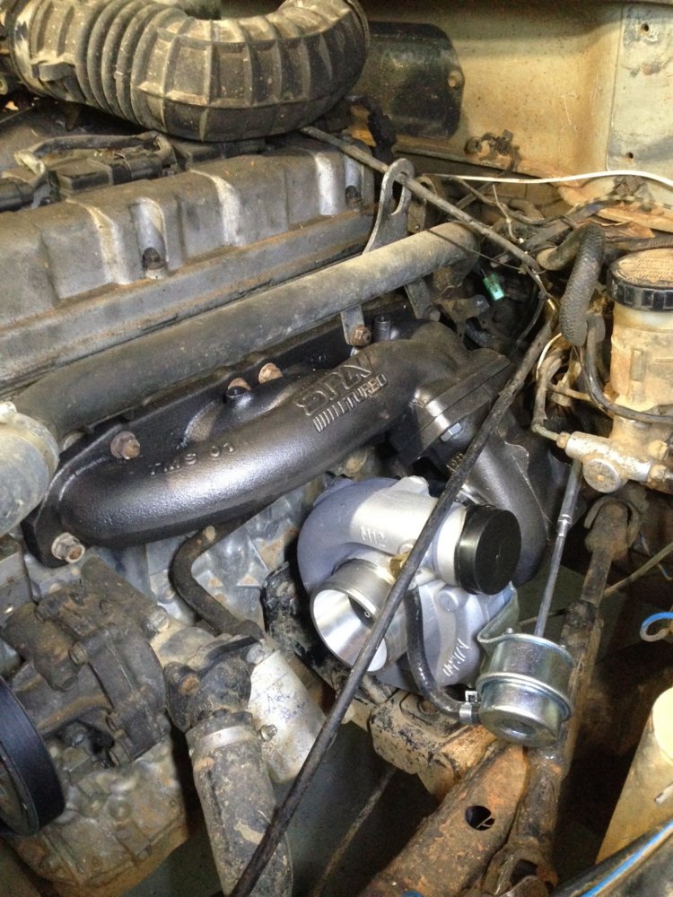

The manifold was the main hang up on the turbo for a year or so. Everywhere I would find that made one would disappear off the internet. My friend finally came across one made by Spa on ebay with two left. That availability started this whole thing.

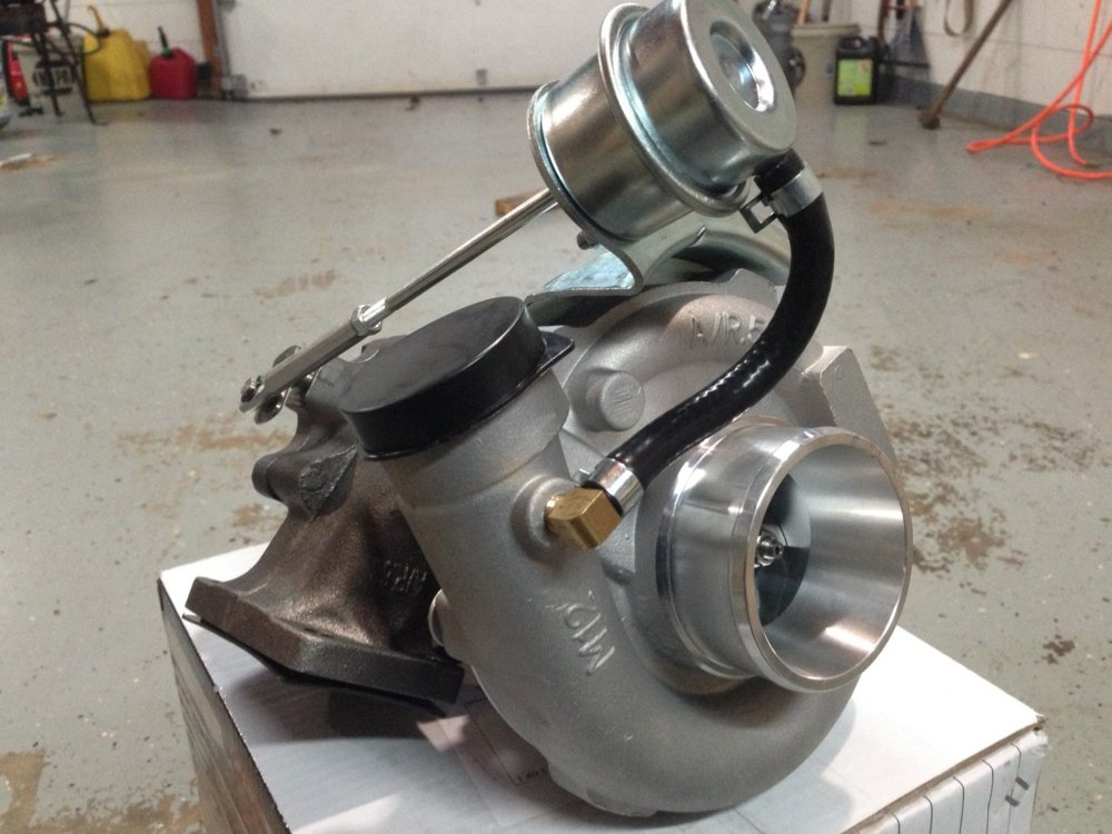

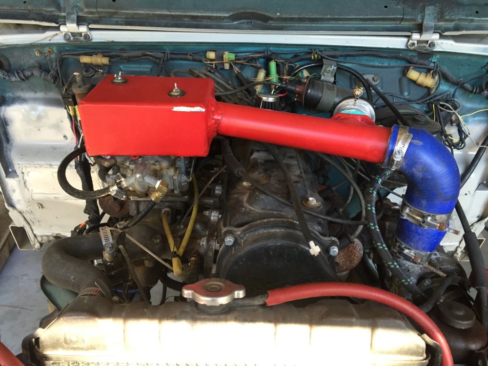

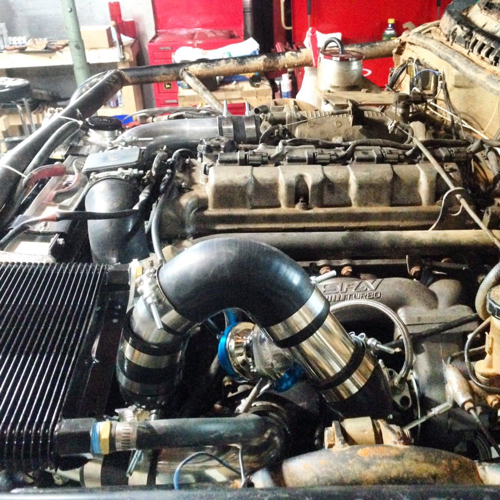

The turbo is a T04E ebay special, with a line kit that came with the oil feed inlet restriction in it. Essentially a T3 turbine and T4 compressor hybrid. Spent a day or so routing the charge pipes etc, ordered a pancake style oil cooler adapter and cooler. Decided to run a blowoff valve right after the charger, and blow through my mass air flow. Seems to work okay.

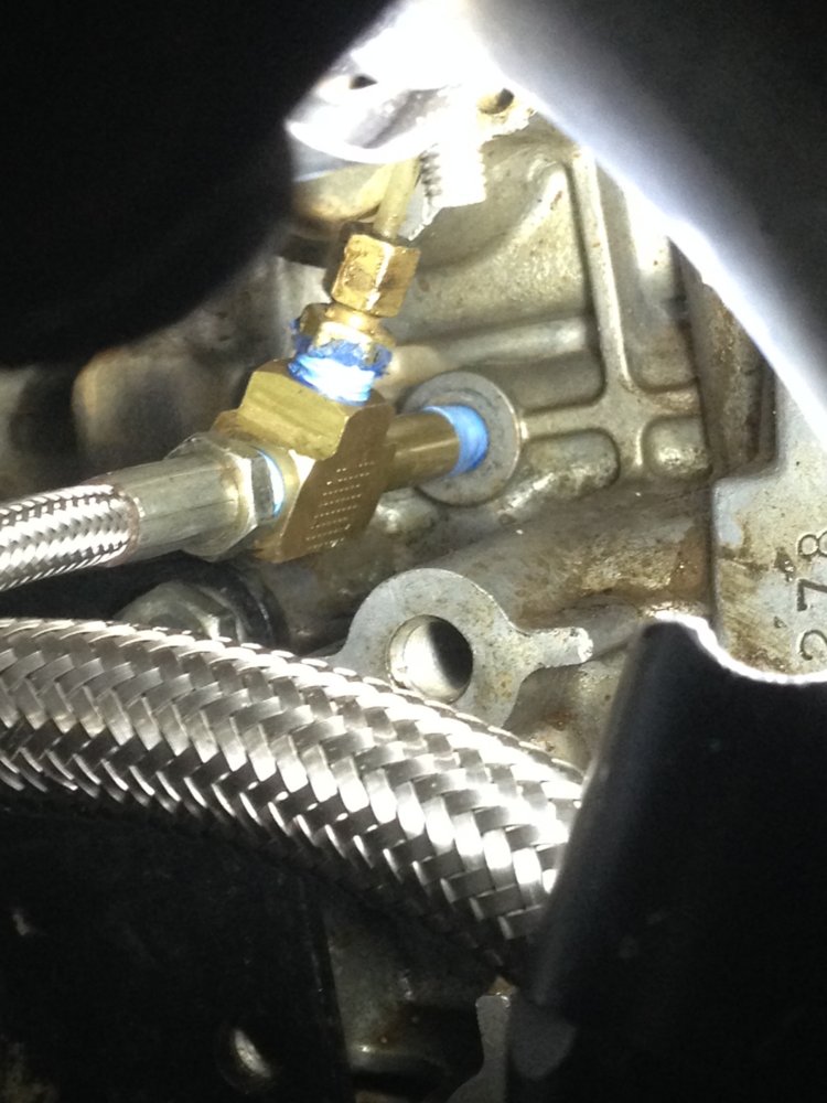

First test drives gave me a killer oil leak at the oil supply fittings. I used a 4way splitter so I could run my oil pressure gauge and supply the turbo. The plug in it leaked like a siv, so I found a tee and extension to make it easier to work on.
The other issue was on boost, when chopping the throttle, I would get a fairly decent blue cloud of oil smoke. Didn't even think about the PCV system. Disconnected it, ordered a moroso oil separator. Should be here today.
I'm hoping the finish the exhaust today and get the O2 and wideband installed so I can drive it without wondering if its gonna ka-splode. I'll just know its gonna ka-splode...

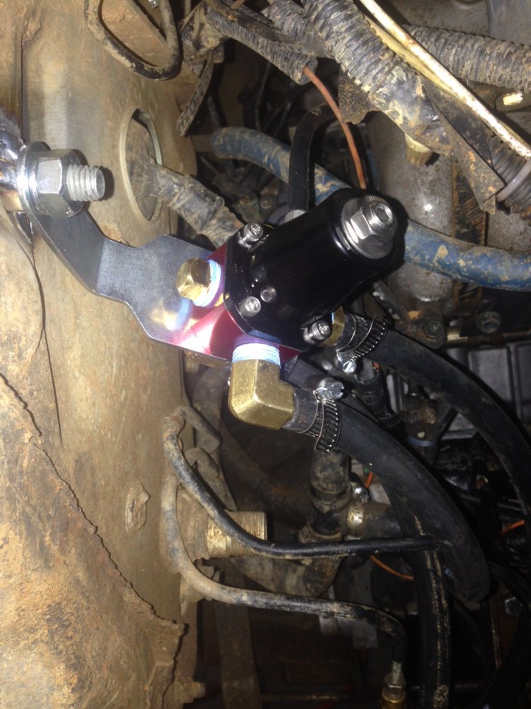

Found out that wrx injectors fit nicely into the stock rail. Factory injectors are around 280cc. WRX ones are 440. Practically drips fuel out of the exhaust pipe lol. Got up Saturday and put the blower motor resister in the ground of the fuel pump. No help. Unholy richness, of course until the charger lights up...
So I ordered an adjustable fuel pressure reg from summit to back the pressure wayyyy down. If this doesn't make it acceptably driveable, it will be an AEM 4cyl standalone system pretty soon. I'm kinda torn on the clutch as well. Looking at the centerforce models. Anyone know if the dual friction is crawlable? Can it be rubbed or does it just grab? Clutch is fine until full throttle hard shifts in high. Then it slips.

Got the adjustable fuel pressure regulator installed. Now it will idle without melting your eyes out of their sockets. It'll even drive down the road without coughing when hitting the throttle. Still a little rich down low and on cruise, and leans out hard at the extreme end of the rpm band. Drivable, even relatively beatable. Just not beatable by my beating specifications :D
