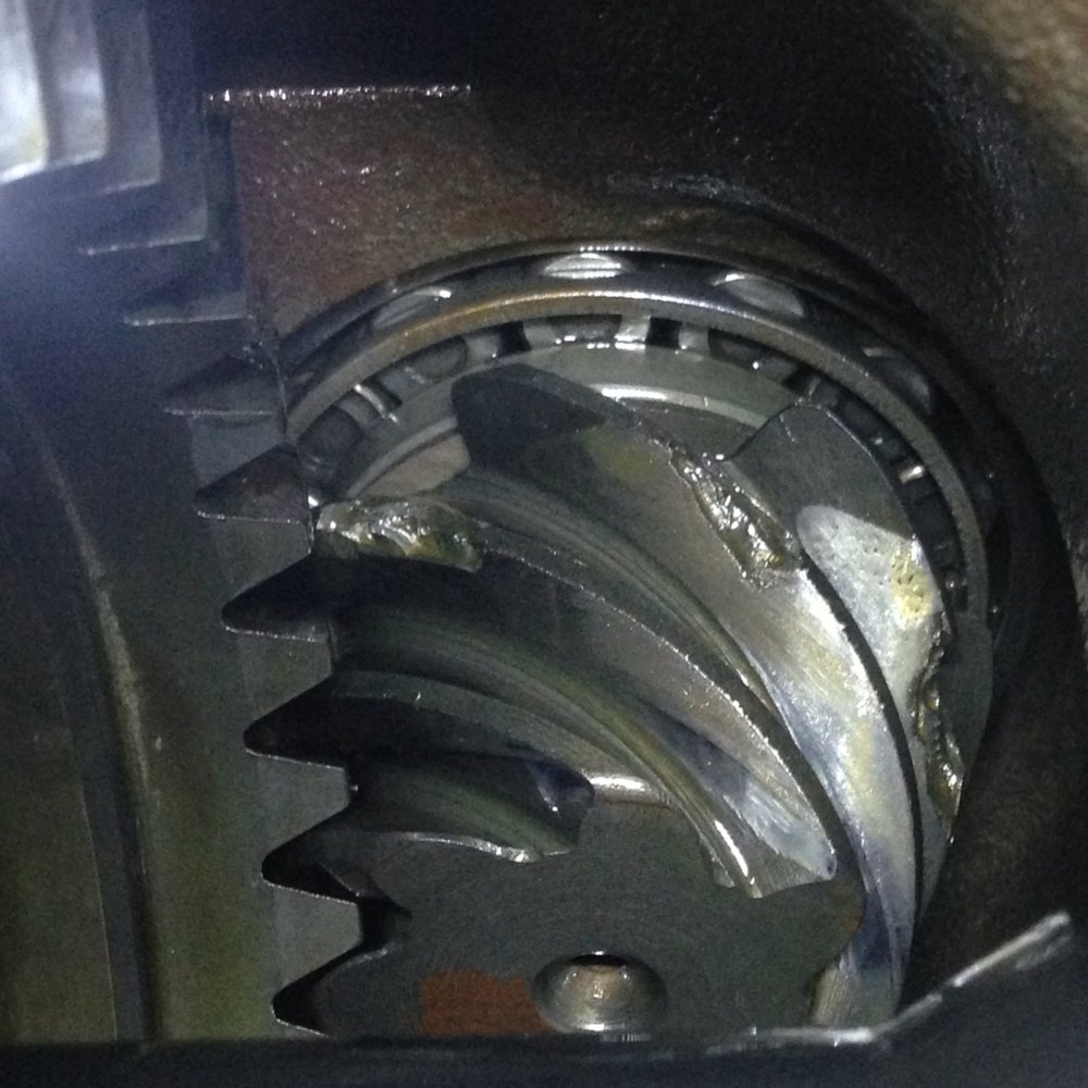

On a totally unrelated note, while joy riding and putting around the neighborhood, I've been noticing a metallic clang when changing directions and some roaring when at speeds. I've noticed this a few times in the past, but hell, its a pile of junk so whatever. I guess it was about time to change the fluid in the rear diff... IMG_5362.JPG

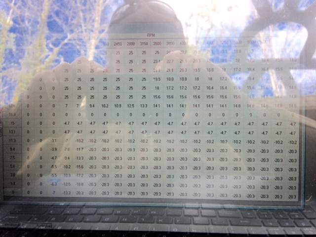

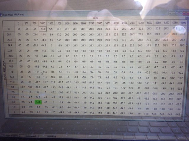

I spend a majority of the day stalling out rich as hell, flooding etc when trying to crawl things, revving it to clear the fuel out. Super irritating. Called him Monday and theoretically, he's refunding my half of my money. It had multiple dead spots in it even accelerating to full throttle. The bottom end was a joke. Wide open, while it did run well, it was running almost 10.5:1 instead of around 12:1. Still a rich top end. Down low, it would peg my gauge rich. This is his "tune"... all $400 worth of it...
I spent about 2 hours Sunday afternoon tuning it myself, just driving around the property with a laptop and draggin the brakes etc. Running much, much better. Bottom and top end. This is my tune as of now.
See a difference???
