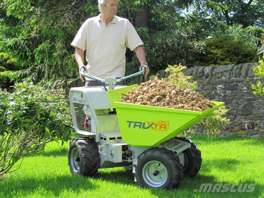

I’m thinking of building this for my wife. I think it’s a great concept to move feed or squares around our small farm and keep her from having to lift heavy stuff when I’m not there.
On this note I’m in the market for a riding mower to rob drivetrain parts off of. Looking at only needing a running motor and hydro trans. Also a poly tub dump cart/trailer.
Do you have to steer it manually? Looks like it could really wear your arms out, and be extremely difficult to maneuver if a front tire is in a hole or against a rock or something.
I must be something obvious here, what advantage does it have over putting the "donor" cart behind the "donor" mower.
Way easier to get the load where you want it to go. Most people can’t back a trailer. And this can fit into a much tighter space.

I saw it and thought it looked cool while serving a purpose on the farm. Manual steering, yes. Reinventing the wheel possibly. Giving me a project to see if I could make it work, also yes. Who knows, but I want to try to take it and make it a going project that will help the wife do the fame chores here at AK47farms.
Ps. And she hates backing up the mower and lawn cart we already have.

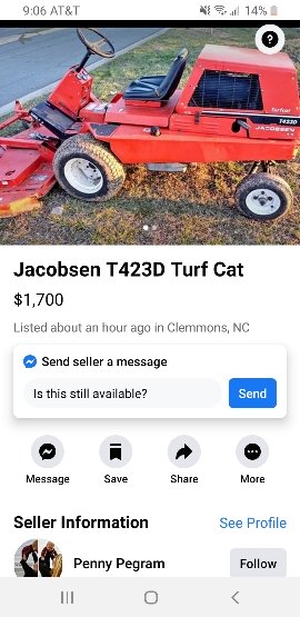

I plan to build something similar to this, esp for hauling firewood.
Here is another interesting one:
