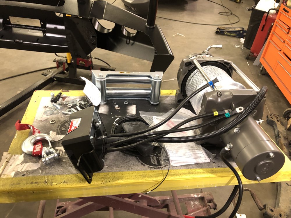

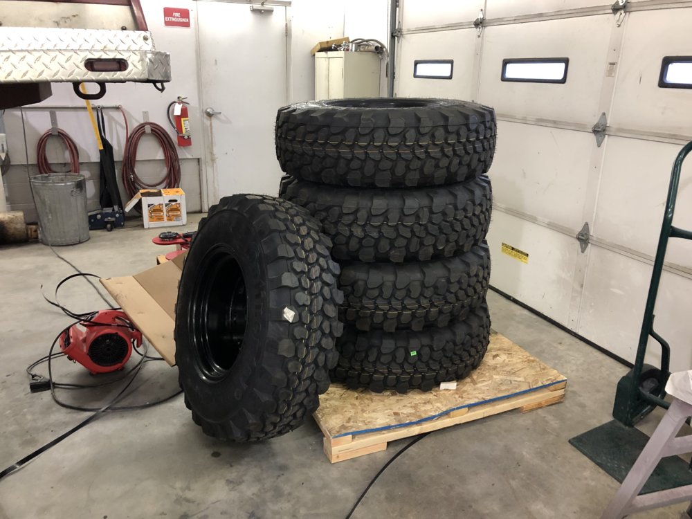

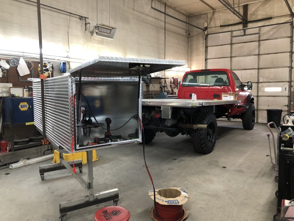

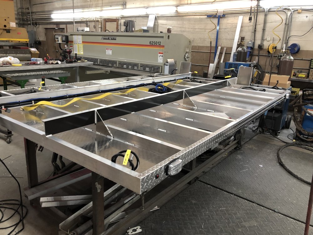

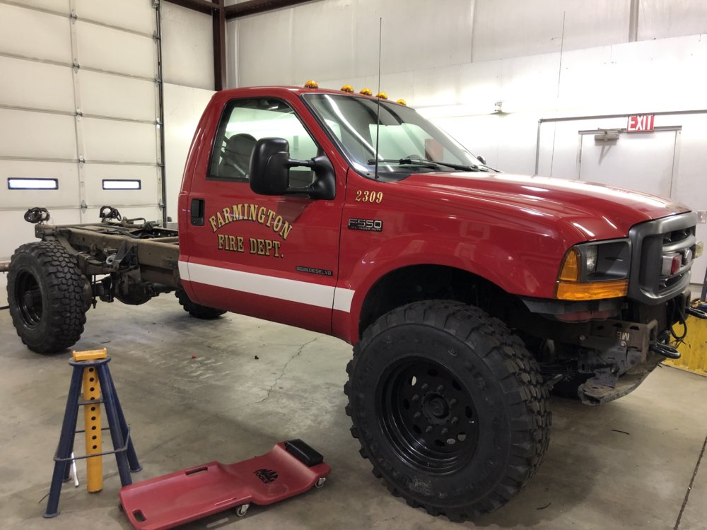

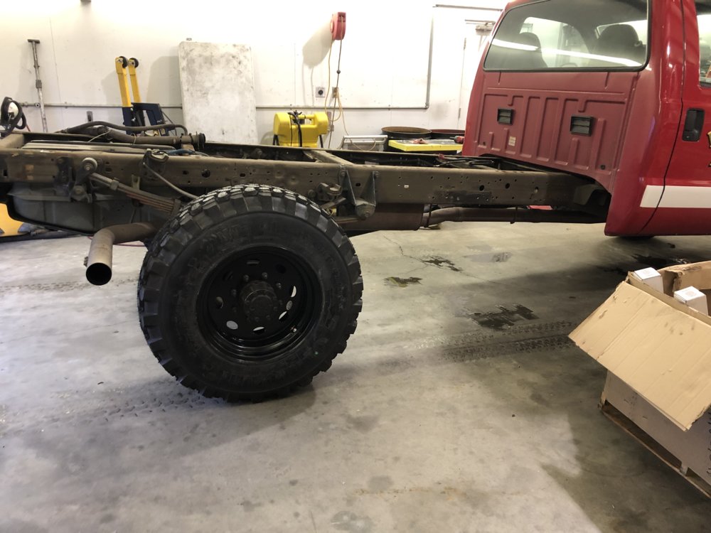

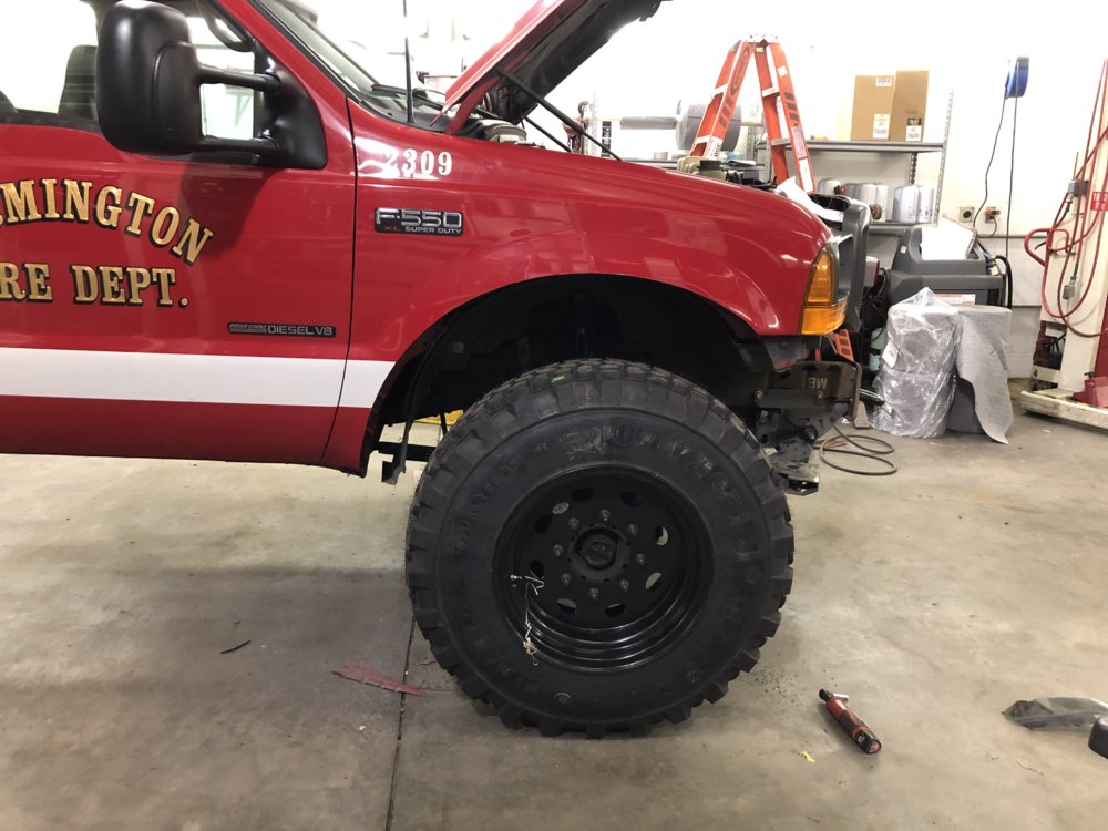

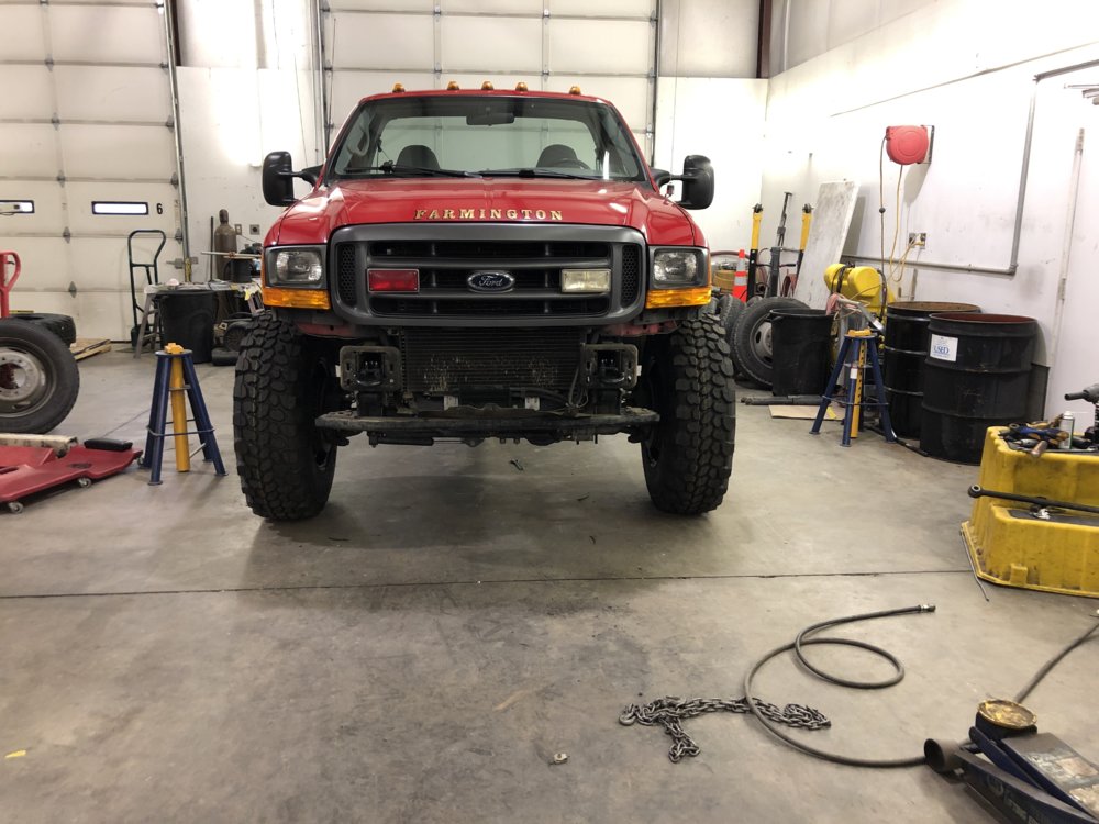

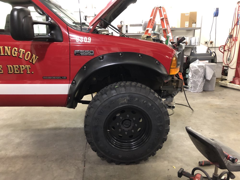

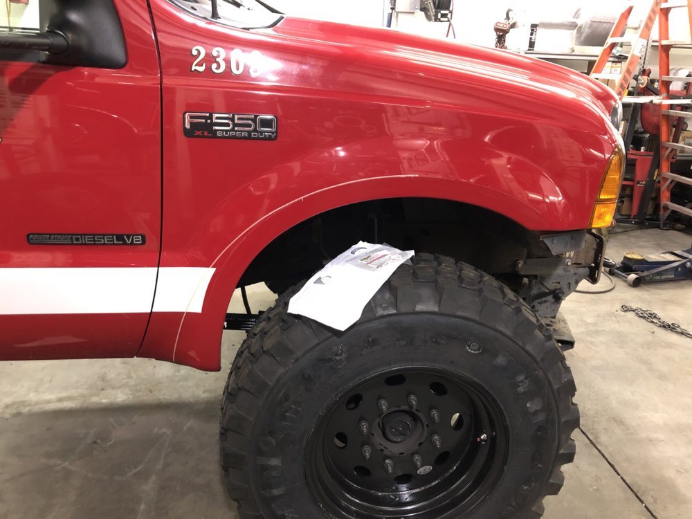

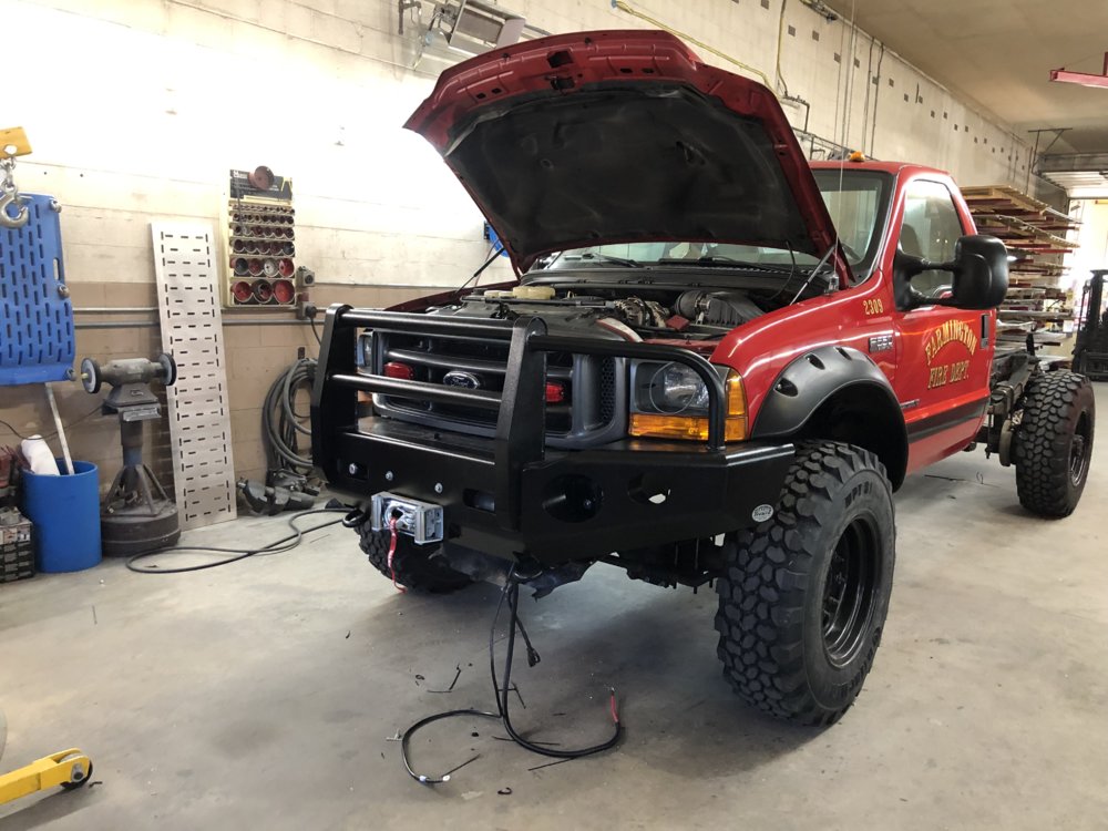

So for a long time now at work we have tried to persuade the powers that be to build a real brush truck. Well all or the stars have aligned and finally get to do one.
01 F550
7.3
335/80R20s
4” lift and a lot of trimming

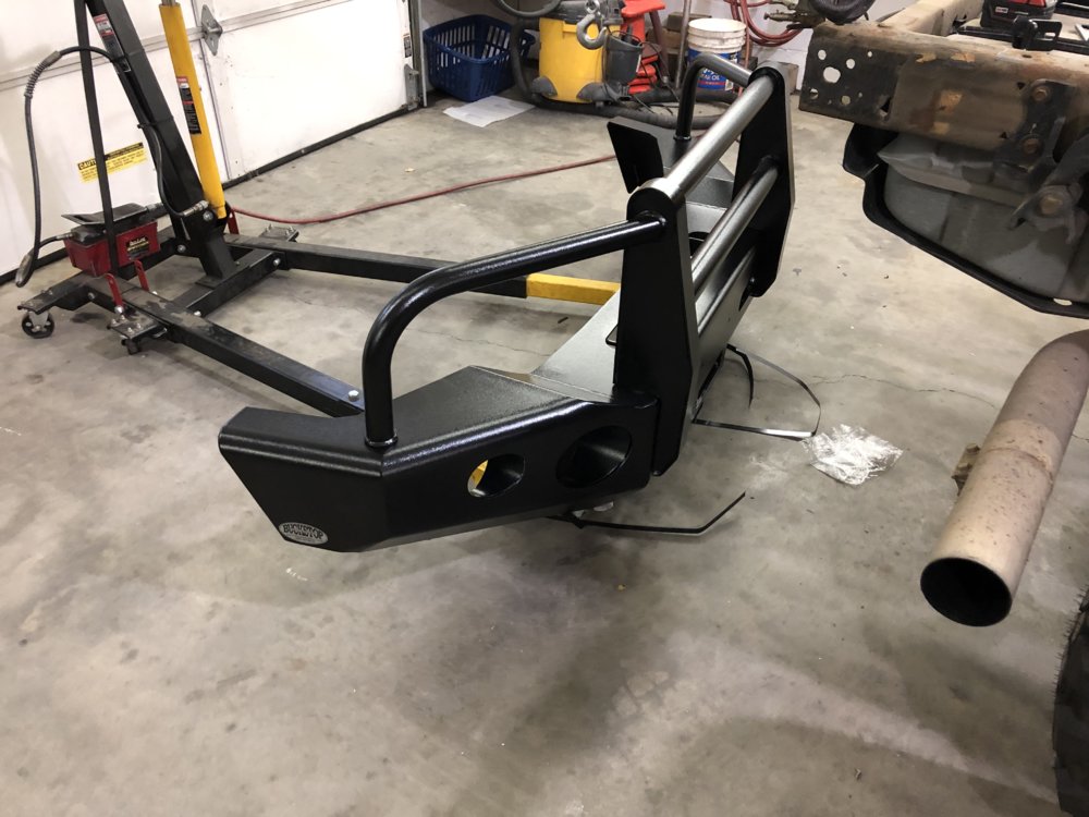

Buckstop bumper and M12000

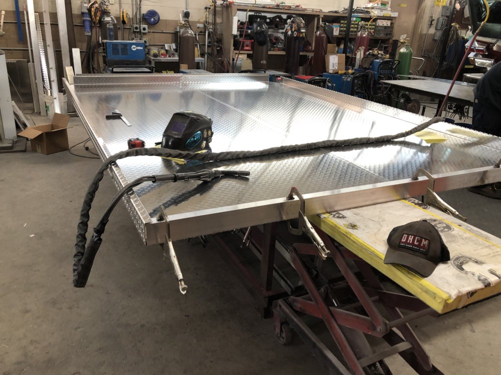

Aluminum flat bed and 300 gal skid unit.
Gonna be a sweet water squirter.

Looks good. And I'm still jealous. Who makes the wheels?

Any plans to upgrade the headlights?
Awesome build!
Sticking with singles all around? If so, after you keeping the drw hubs up front.
Yea it’s a super single kit. The way the wheels are offset you have to keep them on or else the tires wouldn’t turn far at all plus the wheel pattern on a 450/550 is quite a bit larger than the 1ton stuff. It is a little wider in the front than the rear naturally.
Truck is looking mean for sure.

335/80R20s. Says it in the first post. They look like Continental MPT 81s to me.
Edit: Damn! They're expensive! I want a set for my CUCV though...
