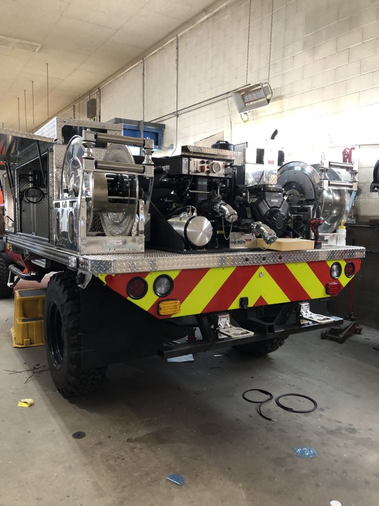

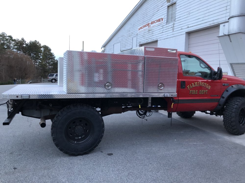

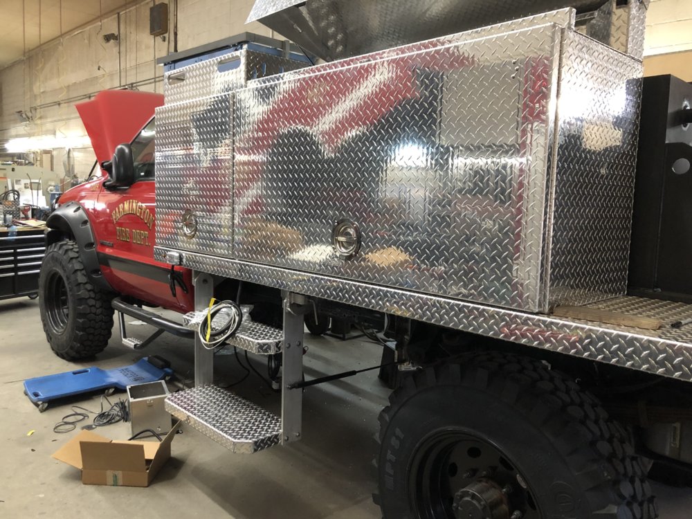

Got some of the boxes mounted Friday. Hopefully get the skid unit started soon.
It'll still be easy to get to the stems since they're 20s. Definitely looks badass.

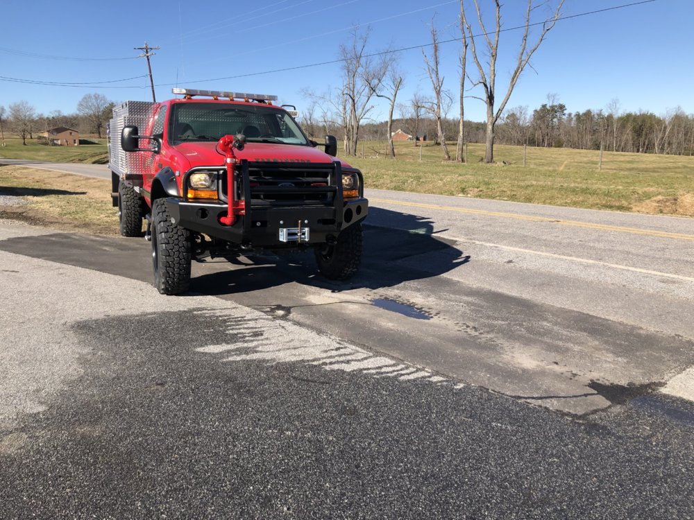

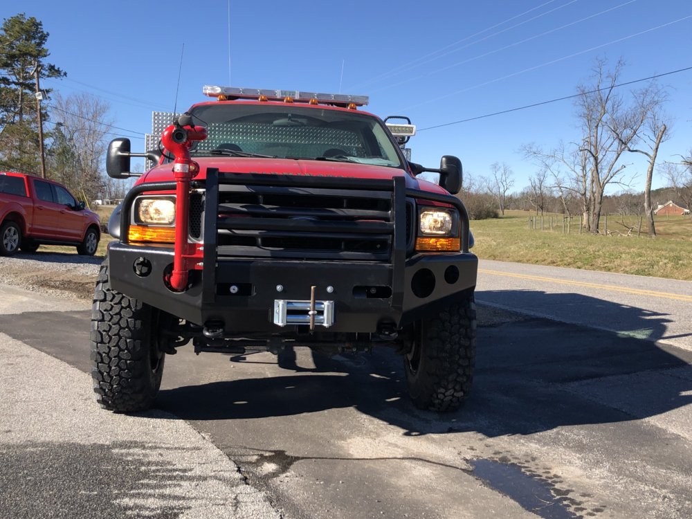

Sorry it’s been a while. Got a couple more things done. Things got a little crazy at Christmas time :)
Couple things I don’t like so far, for this to be a kit the bumper doesn’t seem to be clearanced enough for the tires at full turn. They almost hit just sitting on flat ground. May have to address that. Other than that that no other glaring issues.

The load rating on these are 6700#each so it’s more than enough for the gvwr of the truck. Probably not gonna worry about the LSD, it more than likely won’t see much off-road. Also did your bumper have the extra brace the connects to the front spring bolt? I don’t know if they changed anything but the one we have looked to be pretty beefy.

Bumpers are generally mounted to the frame horns, which may be full of Factory holes. How it's mounted is everything!
I doubt the bumper manufacturer, considered the Over-sized tires! Cut & Tuck!
They should, it’s all built by the same company and sold as a package. I guess we’ll see.

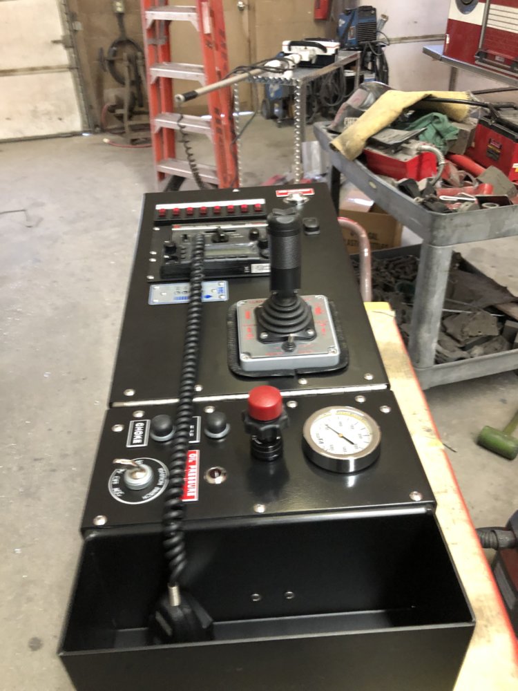

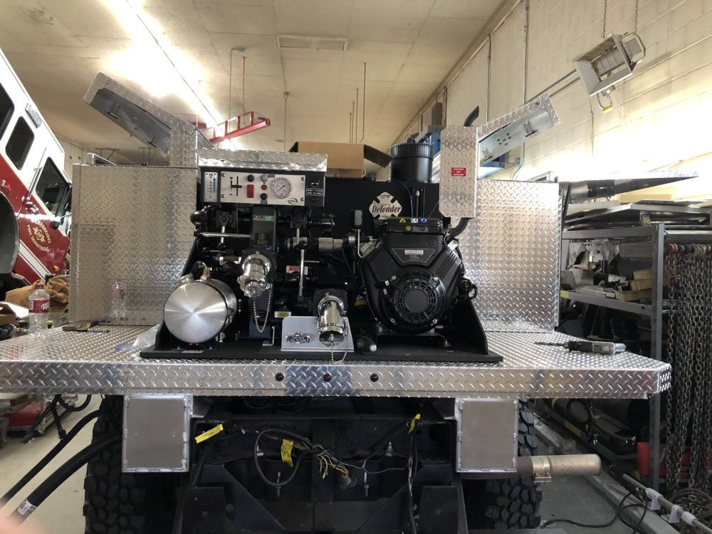

Got the new console ready to go in. Cleaning up a bunch of the wiring as well.

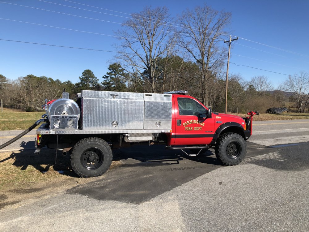

Getting pretty close. Ended up flipping the rear wheels and ran a valve stem extension through to the other side. Gained an extra 6” of width.

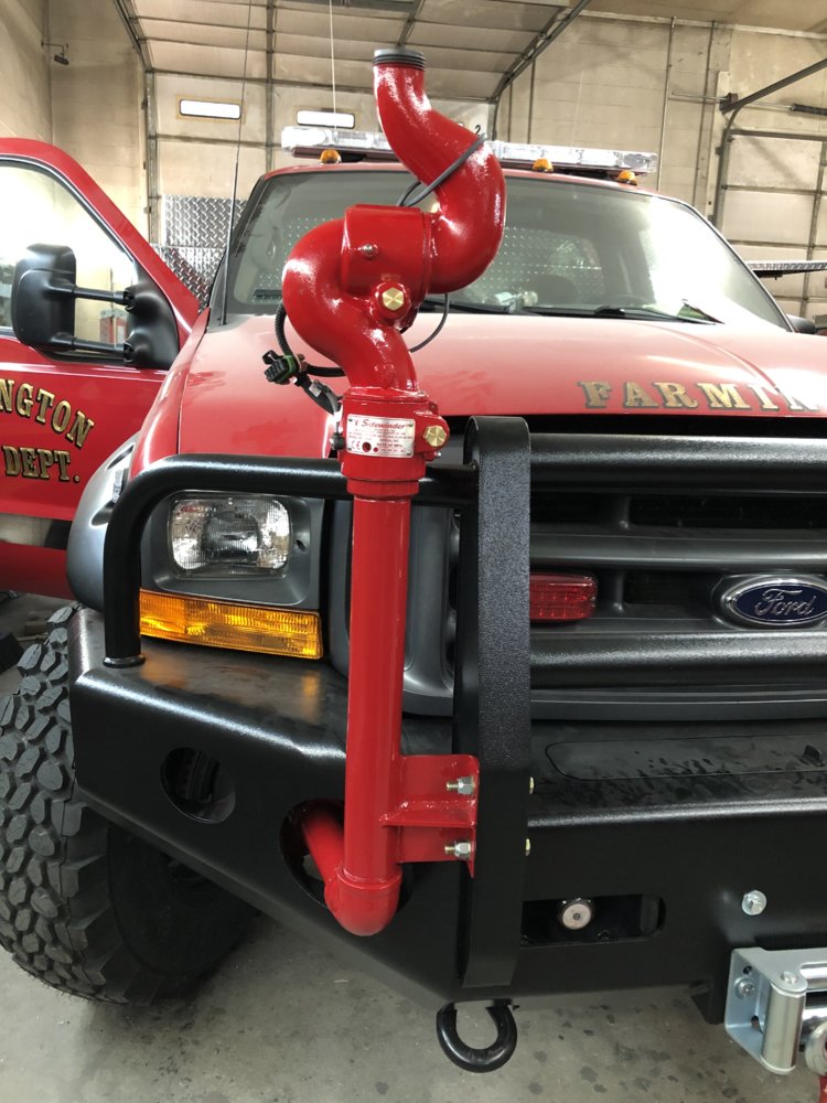

Got the front monitor built and painted. Just waiting on some hoses. I’ll get some more pics once it’s outside and blew off.

What is the point of the monitor on a brush truck?
I've never pulled up to a brush fire and thought to myself "I wish I had a way to spray every gallon of water on this truck in 2 minutes" :lol:
Truck looks great btw. I just got back from a call and was showing a few guys on the dept. They want to lift our's and put some real tires on it now :lol:
What's the matter with just taking the BRT offroad???
Oh, this:
I've put a few engines in places they had no business being, and even got one or two stuck before, but never like that. I'm surprised it made it in as far as it did.
Duane
You can activate that guy and position it rolling as fast as you want. No speed limit because of the configuration. They have a video of a response on an interstate highway. Rolled up in an active burn. Put the car out before EMS could even get stopped.
Rolling along a brush line or the like laying down a foam blanket is really nice as well.
The feed is 2 inch, normally run an electric nozzle for fan and stream reduced to 1.5 inch.
They can throw water several truck lenths no problem. With the right air induction nozzle foam that distance is no problem.
