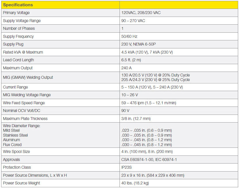

ok guys......24.3V is good output but at 25% duty cycle is laughable. 0n 110 input 20.5V at 20% is even worse......yes yes I know you dont need that heat but it is a window into the longevity of the machine. Now for some potatoes to go with the meat! Mild steel wire diameter .023-.035 good choices excellent for what most car guys do HOWEVER.......at 15-18 volts a very sweet spot you may get 40% duty cycle. So 4 minutes out of ten she'll be happy. It is a very light hobby use welder. Otherwise it would be listed at those outputs nearing 60%
as an addition I had to edit my initial illustration, had my facts skewed. But rewording my argument I stand by my sentiment its just a fancy hobby size machine....like etsy arts and crafts size.

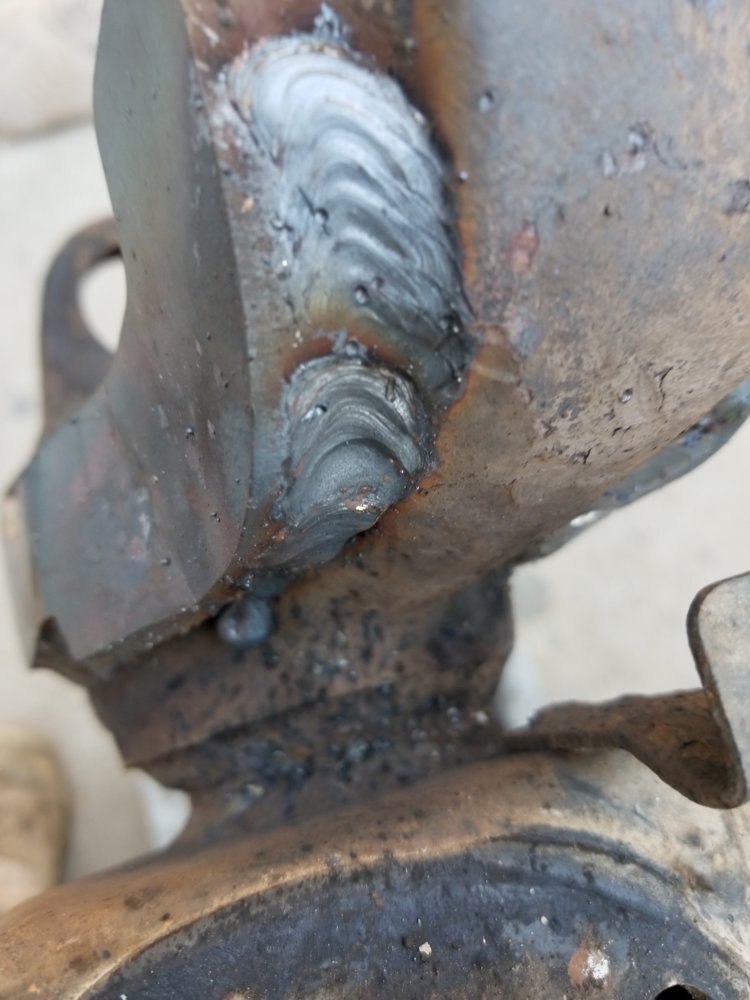

I have an esab fabricator 140. Got it for its portability. If esabs bigger machines weld anything like this one I would highly recommend them. I believe they are very underrated. While welding sometimes and look up to see I'm welding at 160 amps.
