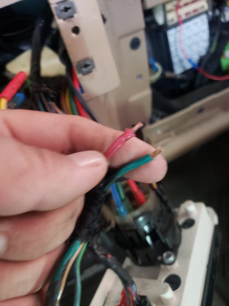

Papa_Jon non speller Joined Jul 27, 2007 Location China Grove Oct 18, 2018 #28 Either i didn't see this or it happen just now these 2 burnt in 2 Attachments 15398901080934230988498295902130.jpg 70.1 KB · Views: 149
Papa_Jon non speller Joined Jul 27, 2007 Location China Grove Oct 18, 2018 #29 Quick fix for now to see if it works .. will soder and shrink them if all is good
Papa_Jon non speller Joined Jul 27, 2007 Location China Grove Oct 18, 2018 #30 Got its working but only through defroster. But hell im happy with that for heat . Speeds settings work also
