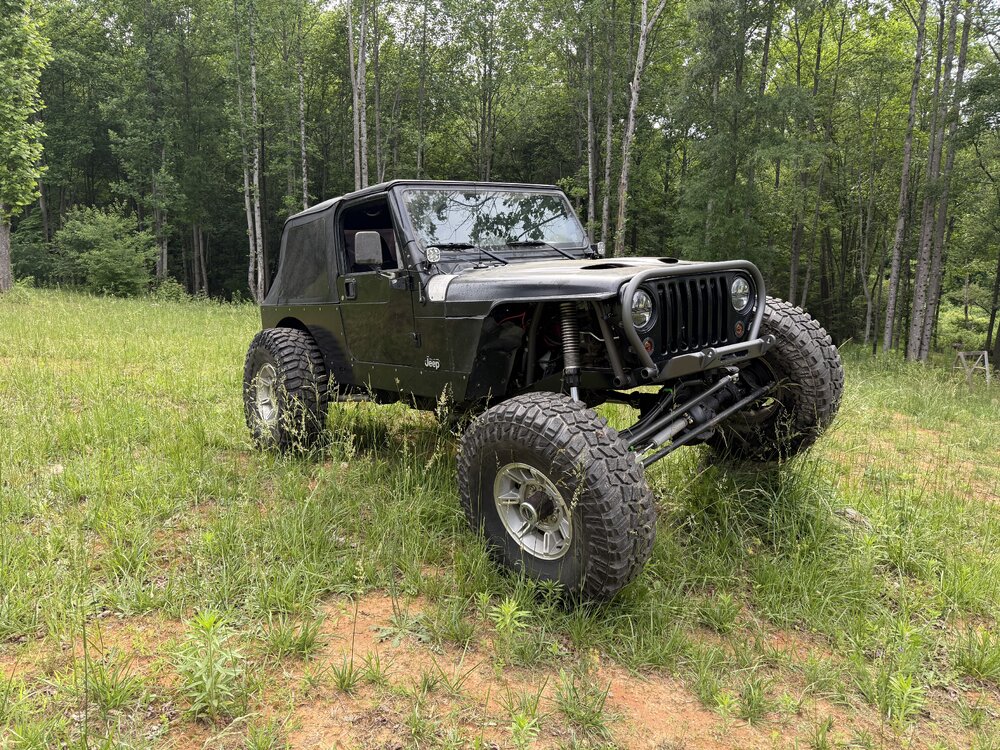

Accidentally building an LJ

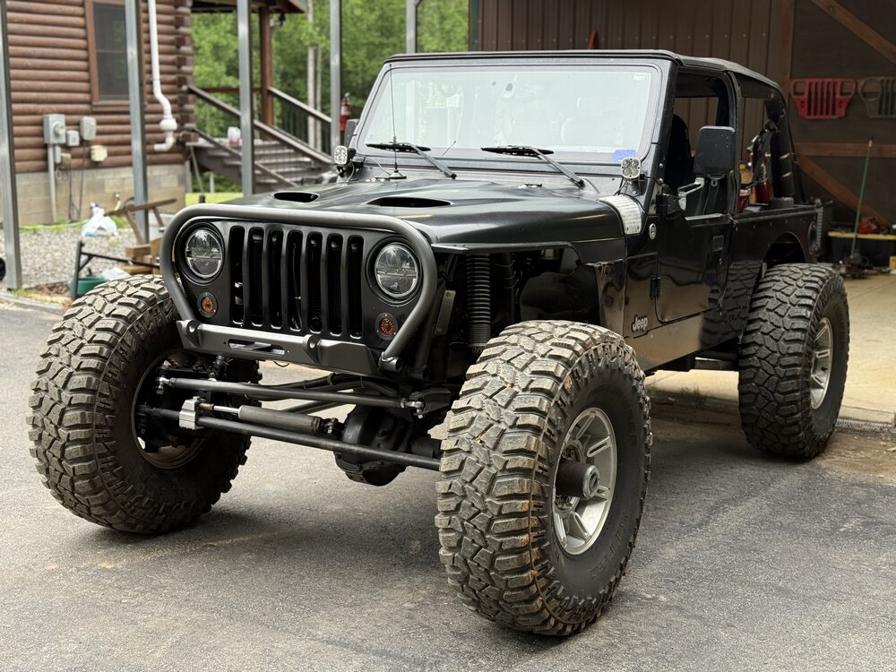

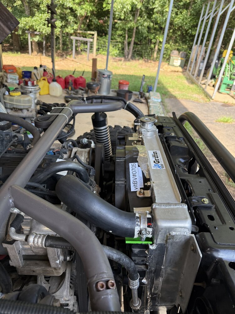

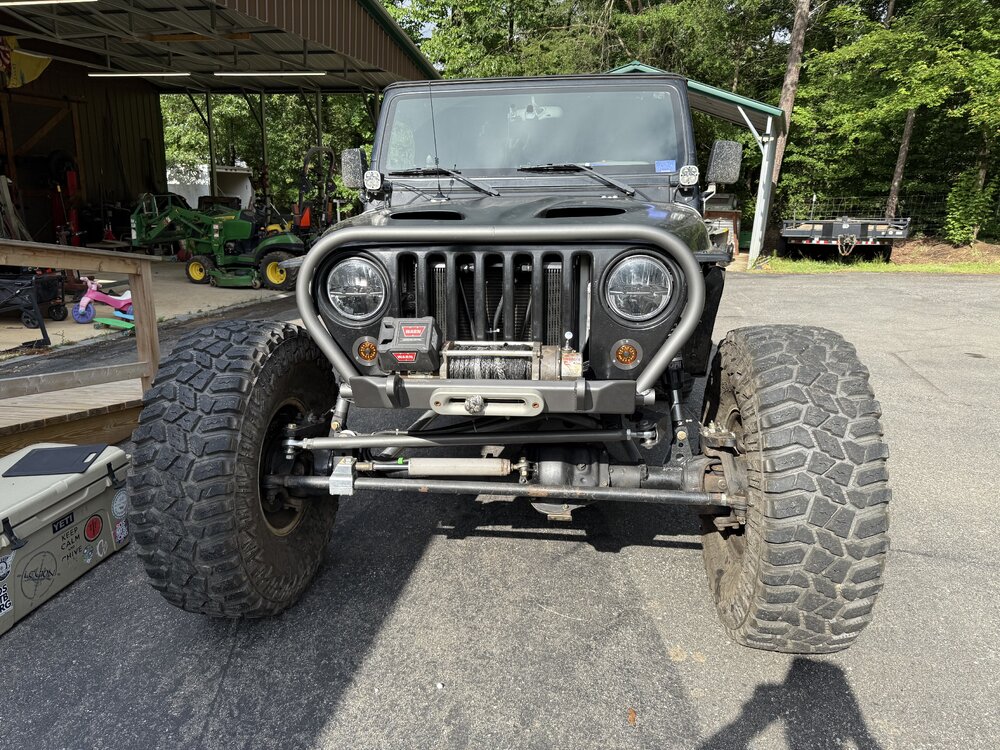

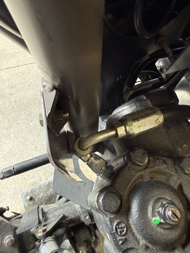

Getting closer again. Coolers, condenser, and radiator are all mounted in it and all the cooler lines are done. Fragola pushlock fittings are no joke to get a hose on. Working on bleeding the steering system little by little as I’ve been bouncing around on other stuff.
Electric fan is all wired up and ready to go although I think I’m going to add a kill switch for it on the Auxbeam panel. I ordered a normally closed relay to wire into the circuit for that.

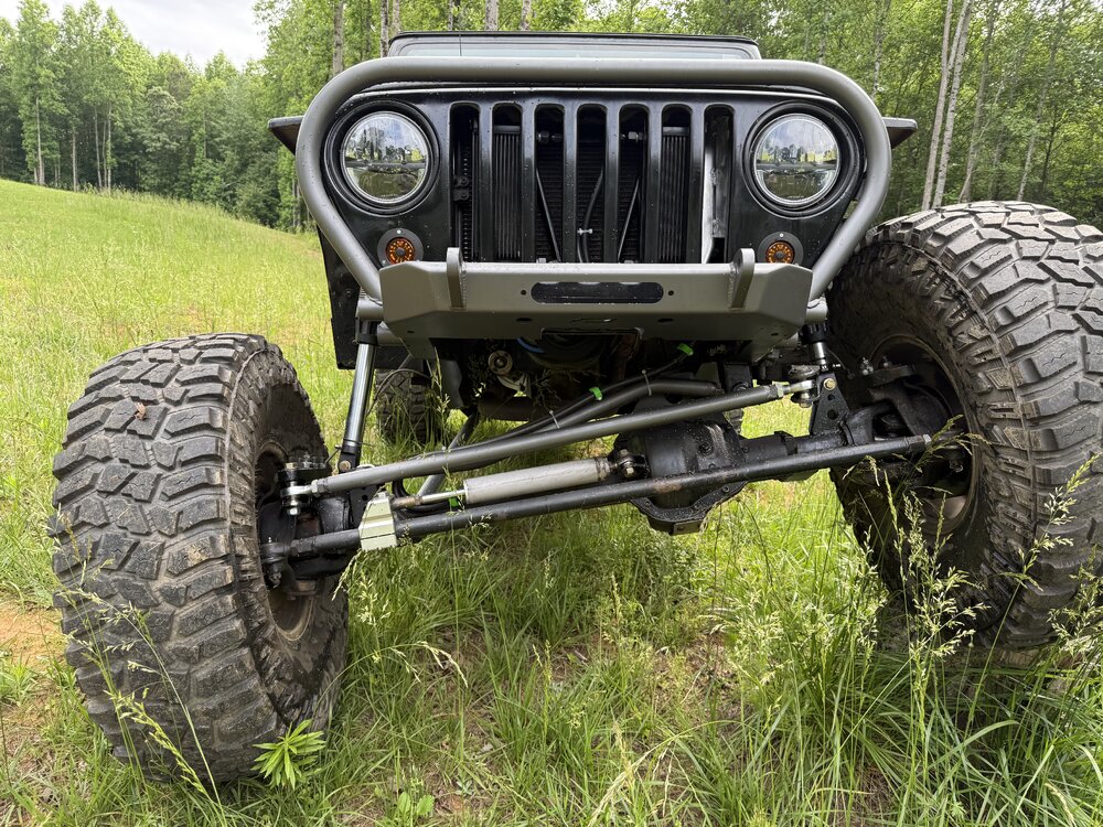

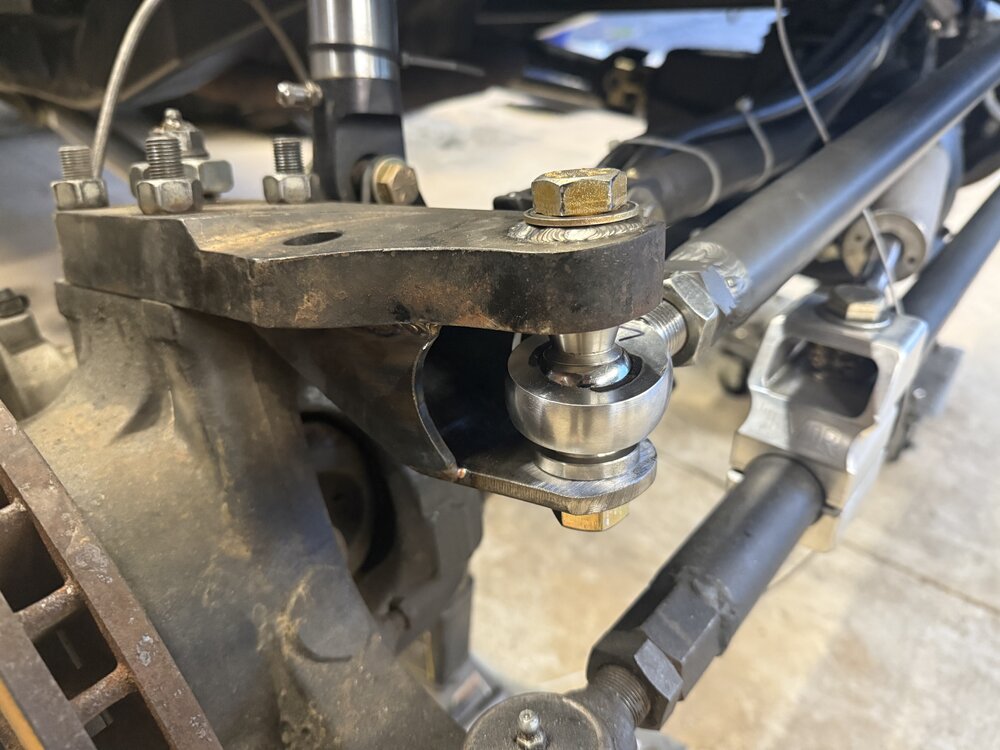

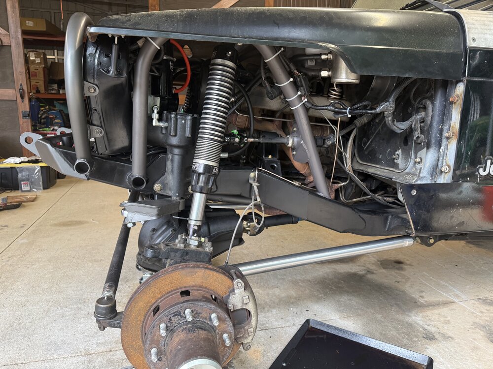

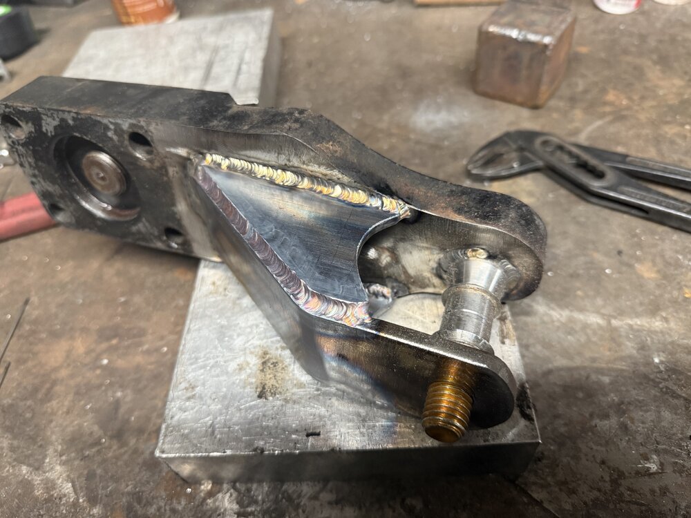

I had a buddy with a machine shop spin me up a couple of reducer bushings for the high steer arm to swap it from the tie rod taper to the 5/8” bolt I’m using now. Got that welded in the passenger arm and then made the double shear bracket for it. It’s probably overkill but now I shouldn’t have to worry about it. A little paint and it’ll be finished up.
I think that once I find some radiator hoses that’ll work and finish plumbing the front brakes, it’ll be good to take it on a test drive. There’s a few other things on my list like bolt checking everything and fixing the transmission leak (pretty sure it’s the drain plug) but they’re either all pretty minor things or stuff that it can be done after it’s back on the road (like the front of the cage). I’m feeling pretty confident that I’ll make it to my goal of back together in time to drive it to the beach in 3ish weeks.

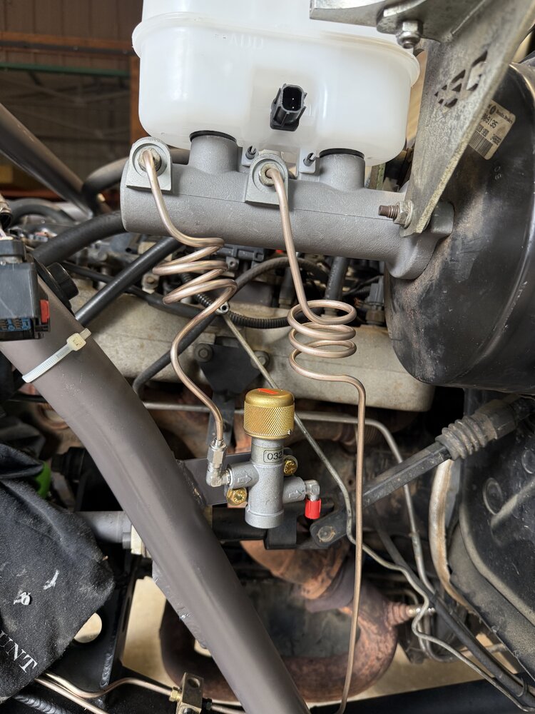

I went ahead and swapped out the master cylinder for the common ram 2500 swap one (might be a van one, I’ve slept since I bought it) and ditched the factory TJ proportioning block thingy. I’ve got matching calipers on all 4 corners and it’s never felt like it had enough rear brake. It’s got a super fancy AP Racing proportioning valve plumbed inline now. Are used NASCAR brake parts gonna make it faster or slower??

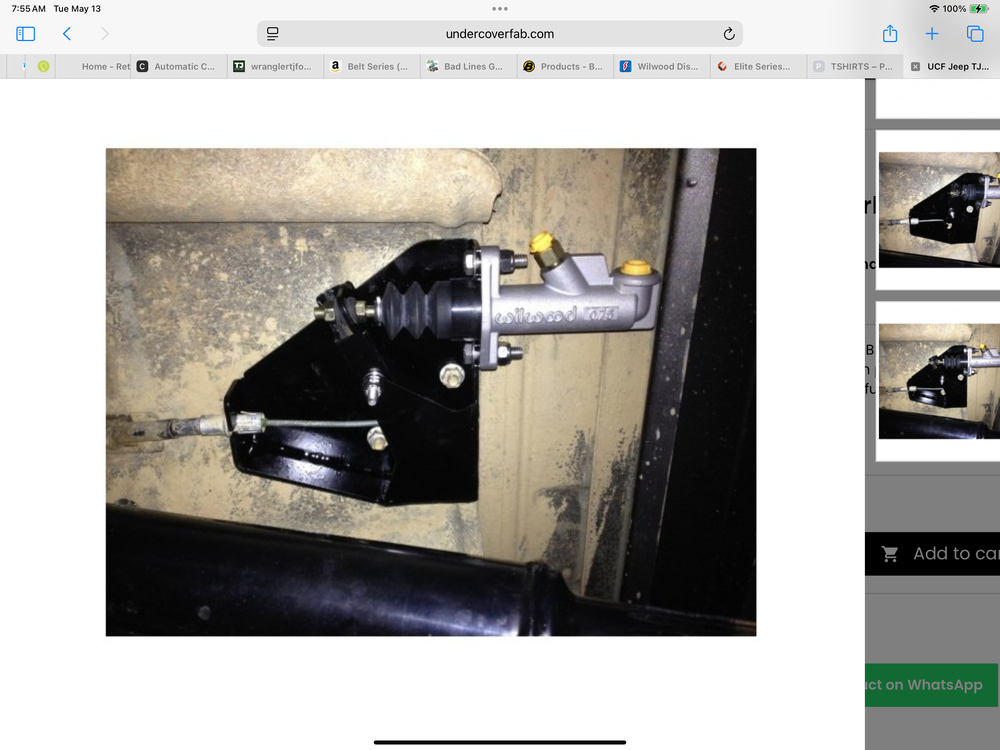

I also ordered one of the Undercover Fabworks hydraulic parking brake brackets. Uses a wilwood/tilton master cylinder mounted where the factory cable would split and uses the factory lever and front cable to activate it. I snagged a 3/4” tilton master and some fittings from SRI to make it all work. Once it’s done I’ll have replaced every single brake line on this thing. 🤣😂

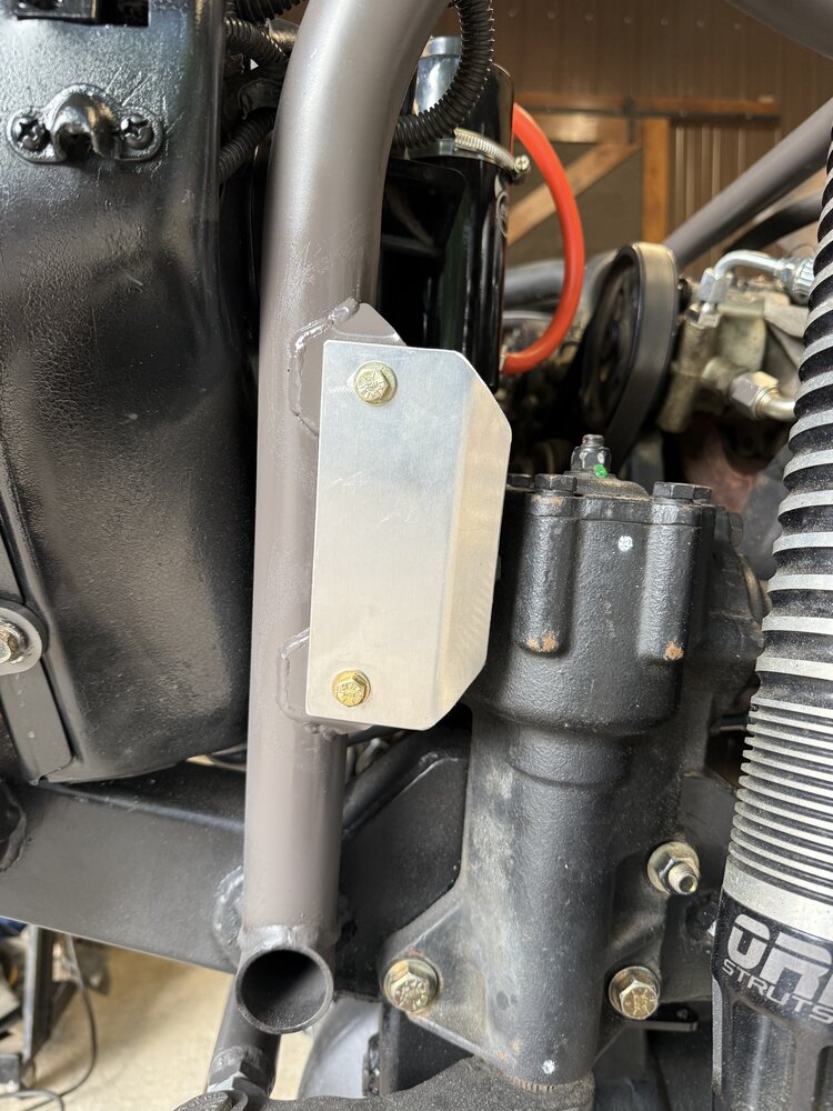

I also made a little shield for the hydro line coming off the outside of the box. Probably not needed but now a stick can’t tag it and knock the line off.
I’m interested to see how you like the UCF parking brake bracket. I have one in my pile of parts for mine. The Ram van master is the one I bought for mine. Did you have to modify the push rod at all?

I finished up plumbing all the brake stuff and got the parking brake master cylinder mounted up with a used 3/4” Tilton master I got at SRI. A buddy of mine hooked me up with a factory e-brake handle and cable. It seems to work decently. The brakes suck overall though. I’m thinking I need to extend the pushrod a bit more than I already did. The pedal is super soft and goes pretty deep before any braking really starts happening. If that doesn’t help I might swap back to the TJ master as it was better than these are currently.
I managed to find a couple radiator hoses at the little hole in the wall Napa here in Harmony. Both are for 60’s Ford trucks according to their parts computer. I’ll probably grab another of each to have spares just in case. Radiator got filled with antifreeze/water/water wetter and I ran it up to temp. With the temp switch in the inlet side radiator tank, the gauge gets to about 215* and the fan kicks on. Then drops right back to 210* where it normally runs.

I extended the brake pushrod and it helped the brakes out some but they were still pretty terrible. After doing a little more research, I swapped it back to the factory 1” master cylinder and now it’ll hang you off the seat belts and trigger the dash cam. I’ll call that a win. It still takes a bit more force than I’d like to hold it back in low range but it’s also geared pretty deep so It’ll work.

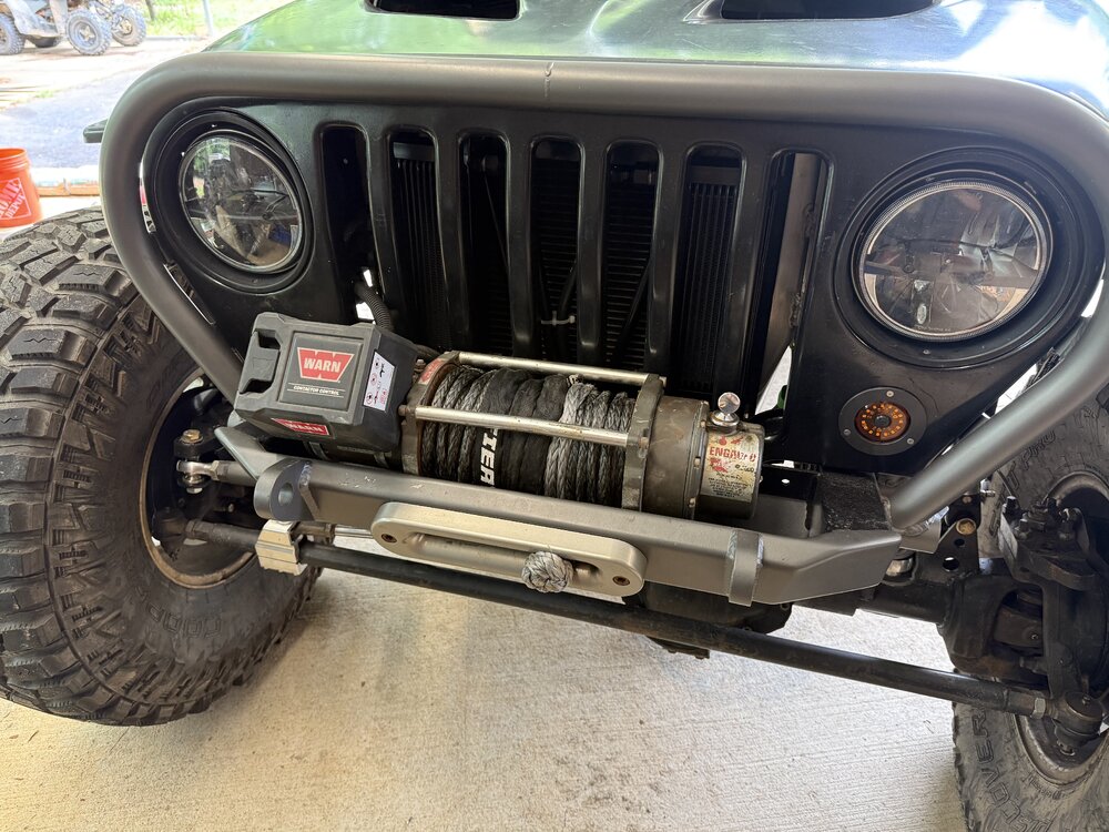

Did something that felt wrong to this today. I robbed the contactor box and the rope off of my 8274 and put them on an old m8000 and installed it on the jeep. It used to be on my trailer until a solenoid died on it and I swapped another winch on it. All the grease was pretty solidified inside it and the motor was kinda crusty. I scraped and brakleened all the gunk out and regreased it. Seems good to go. I may eventually cut the bumper up and get the 8274 to fit.
Honestly you’ll get better cooling with that than an 8274, unless you need high speed continuous winching 8k should be enough for your rig
I know it. It’s had an 8274 on it for a few years now with no cooling issues though. The new Griffin radiator and the electric fan should be better than what it had before too. I just like that old big winch on a Jeep for some reason though.

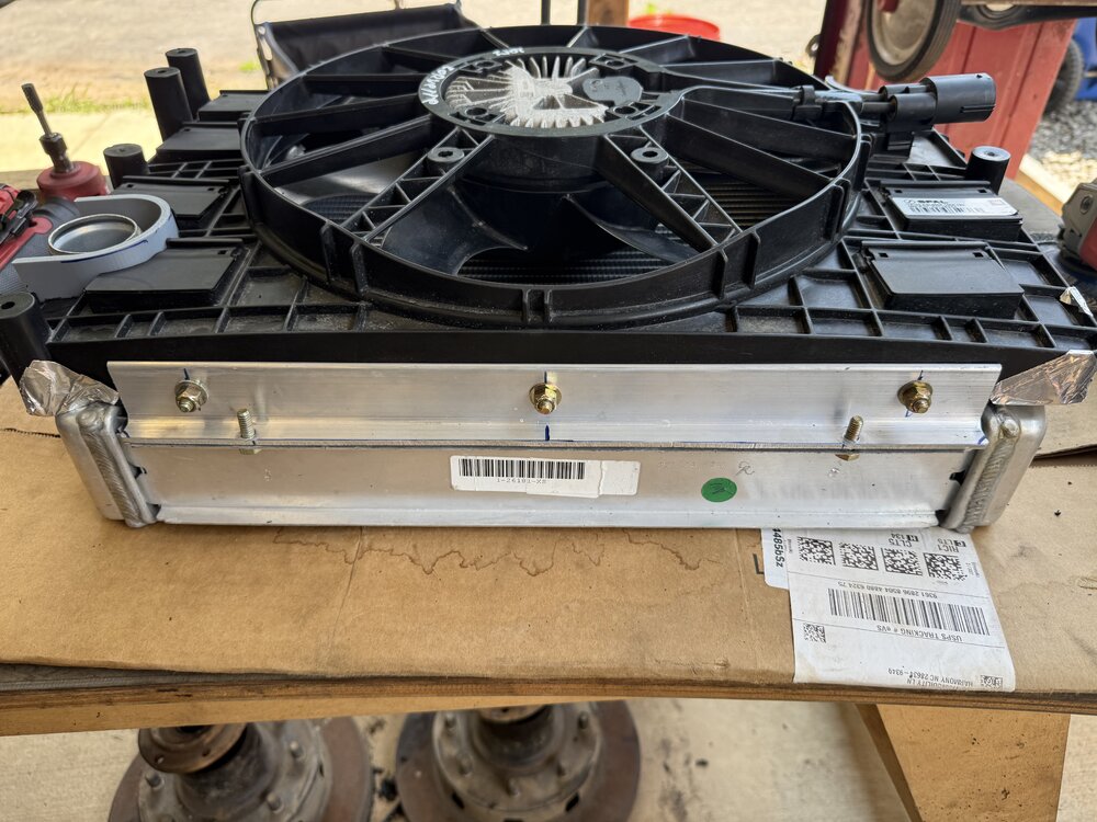

Engine temp creeps up a bit more than I’d like with the a/c on so I’ve got a brushless fan and shroud from a C7 Z06 corvette to replace the brushed fan/no shroud that’s currently on it.

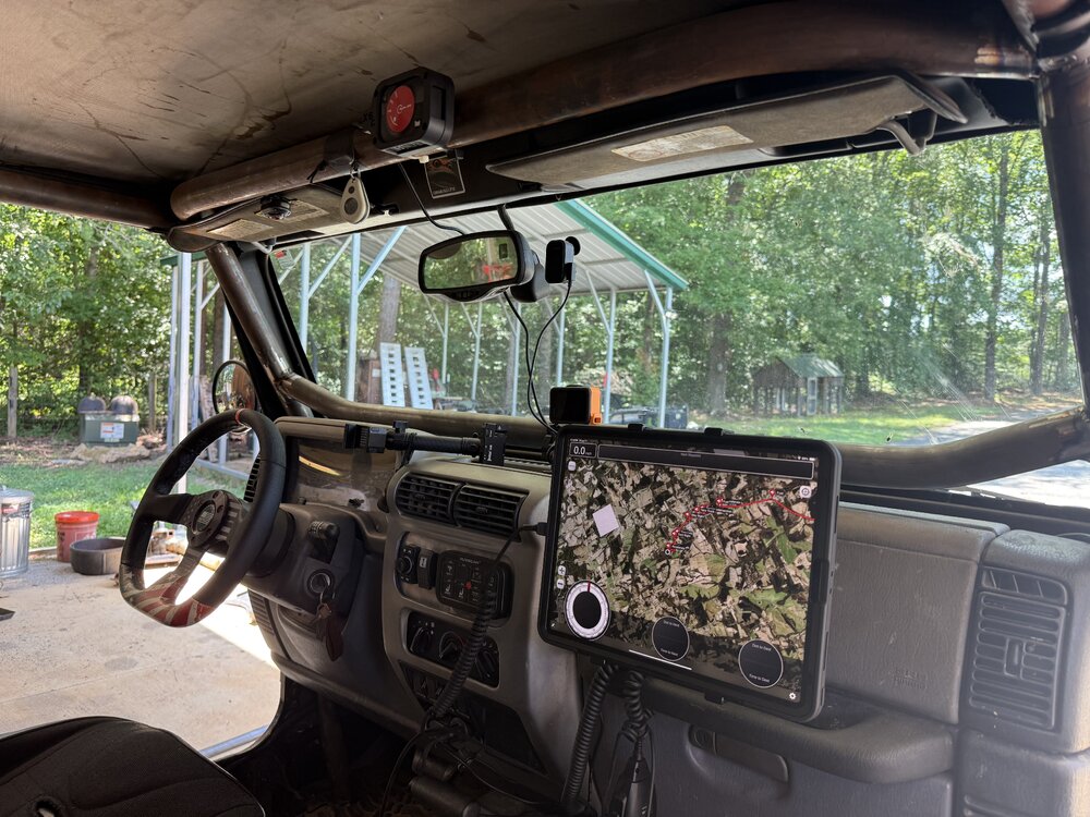

I’m going to figure out some nav stuff too. It seems like most people are just running OnX and/or Gaia so I’m probably going to mount my iPad somehow and add a Bluetooth gps antenna. Then run a phone for a backup. I do have a Starlink mini that I’m tempted to mount under the soft top.

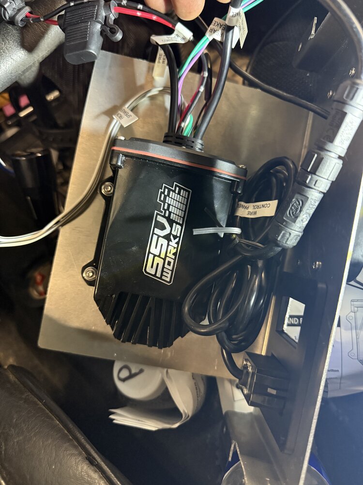

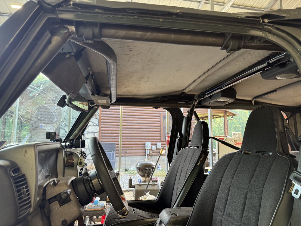

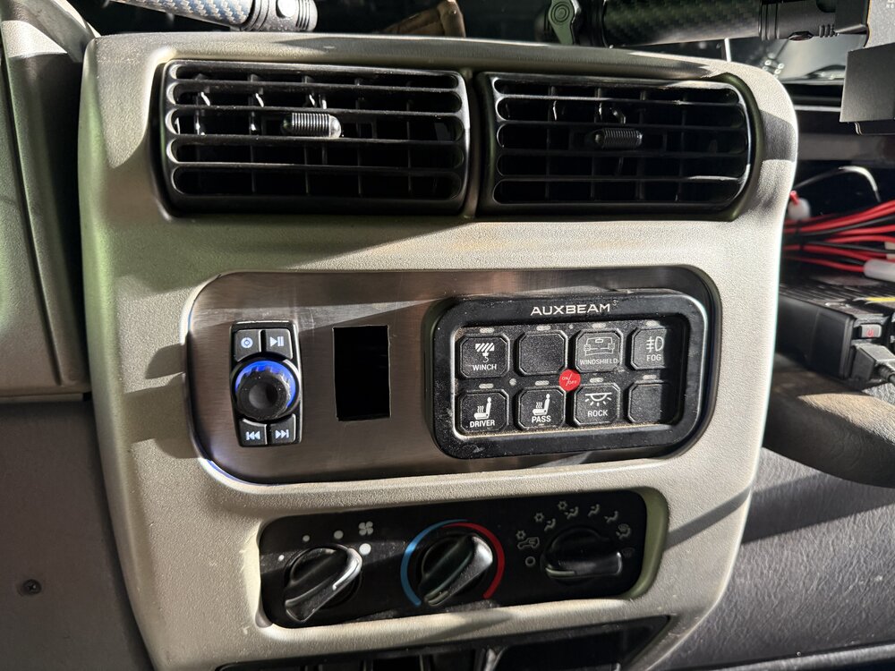

I got sick of not really being able to hear the stereo so I stepped it up. Kicker 5.25” speakers in pods in the dash and some CT Sounds 5.25” stuff in the soundbar. My cheap Amazon head unit didn’t have enough power to push them so now it’s got a SSV Works Bluetooth receiver and 200w amp since I pretty much always just stream music off of a phone. Genright radio delete panel to fill the hole in the dash and mount everything. I moved the Auxbeam panel up there too so I don’t have to lean to reach it anymore. The empty switch slot is for a winch control switch that I need to wire up.

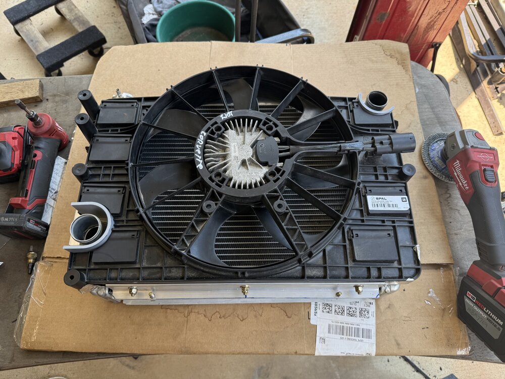

The Amazon thermoswitch for my electric fan died on me the other day so I dove into upgrading the fan/shroud situation. Luckily I had the fan wired to come on with either the thermal switch or the a/c so it was still good to go as long as the a/c was on.

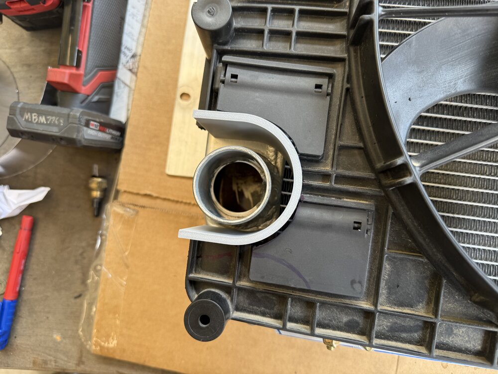

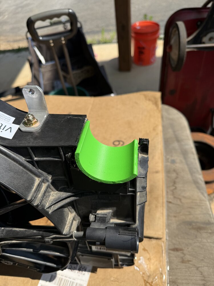

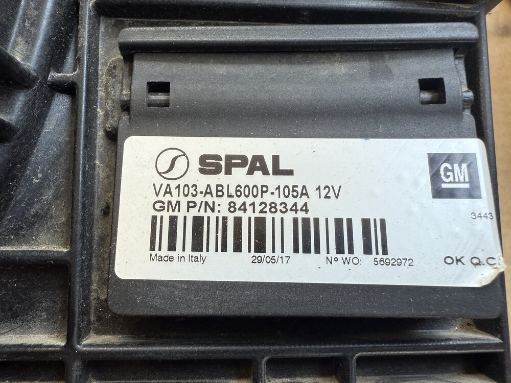

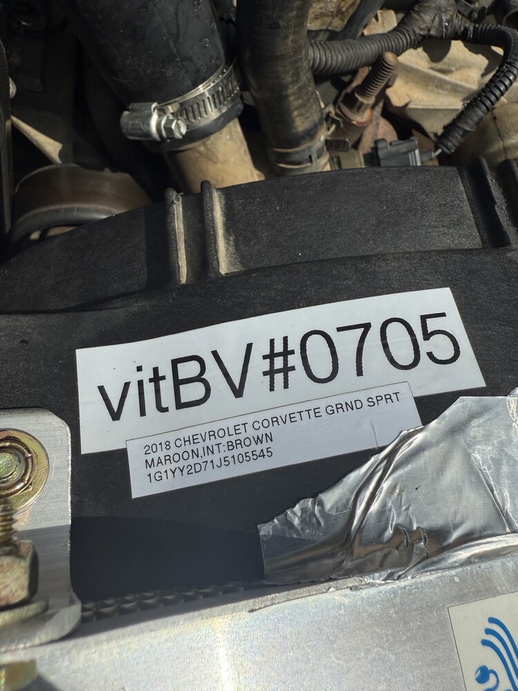

I upgraded from the 14” brushed fan sitting right against the core to a 600w brushless fan and shroud from a C7 Z06 Corvette. 15.25” fan and the shroud was a size that I thought I could make work on my Griffin radiator. It ended up working great. I had to notch the shroud around the inlet/outlet on the radiator but that was expected from the start. I ended up cutting into 3 of the flappers to clear the hoses and glued what was left of them shut. I 3D printed some filler pieces out of abs-cf to close up the notches and epoxied them in place. Then made a couple brackets out of aluminum angle to mount the whole thing on the radiator after cutting about 3/4” of depth out of the whole thing.

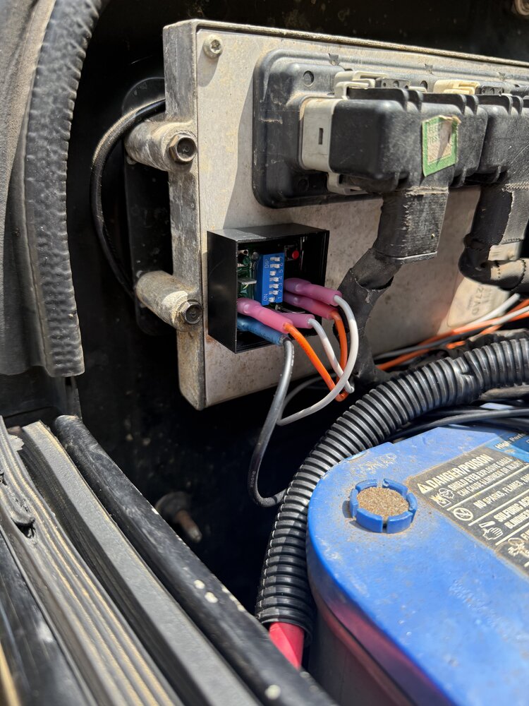

I’m controlling the pwm side of the fan with a Widgetman controller tied into the factory temp sensor. It turns on right as the thermostat opens and ramps the fan up/down as needed to maintain temp. It also adds 50% to the fan speed when the a/c compressor triggers. It seems to work pretty well and I ordered another one for a spare.
