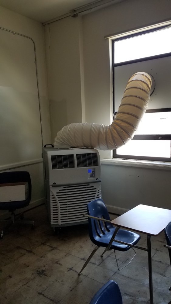

Head up to wytheville va. They're about ready to dump their individual 3 ton classroom units for REAL units
