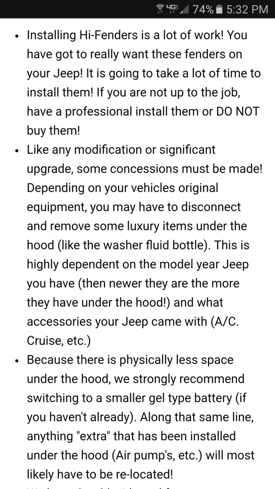

Still thinking about aftermarket fenders, so what is everyone's thoughts on high line style fenders (meaning the ones that you need to trim the stock hood)? My long term ultimate goal for the TJ would be a tire no bigger than a 37 if that makes a difference.
I looked at that option and one of the manufacturers I think it's GenRight, even says on their kit that there is a lot of work involved and you must choose a smaller battery or a different location and you will lose your stock air box as well as a lot of other items on the inner Fender area because of limited space now. And they're bold enough to say;
Thank kind of made my mind up for me
Highline! They just look right. It can be done with all the stock stuff kept underhood (not sure about cruise control since the one i did didn't have that). That was with stock fenders moved up, so not sure if you lose or gain space with the genright/etc.
