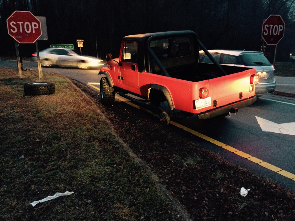

So, on my way home from work this happened:
All my lug nuts on that wheel backed off and promptly vanished.
Which has started a debate on alloy wheels vs. steel wheels.
One of my buddies swears that because the alloy wheels I have heat and cool at a different rate than all the steel they're mounted to, it caused my lug nuts to back off. (which is why he only runs steelys)
Another calls BS to that theory, and that it is a torquing from when they were installed (well over a year ago) issue.
A lot of articles state you should retorque after 500 miles on alloys, something I have never done on any previous vehicle and never had issues with.
I've run both, and have never had an issue until tonight.
What say you?

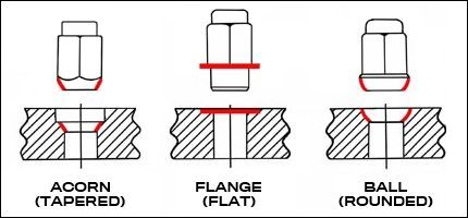

most likely this ^, I have seen first hand what a new vehicle does when an aluminum wheel get's chunked at well over 60. Lady test drove a pickup yrs ago where I worked as a teen, seem the salesman didn't see what the fuss waqs over it not being Pm'd yet.:eek: Truck didn't sell either.:rolleyes: Alloy wheels seem much more sensitive to improper torque and lug taper. The faces get deformed and seating the lug to see true torque is harder to achieve. So it rides on a minimal contact area and quickly wears this down, becoming loose.
I've only ever had one wheel fall off of my vehicle. It was a cj7 with some new to me alloys and I unknowingly used lug nuts with taper for steel. I had just driven 30 miles on the interstate, got off the exit, turned into the restaurant parking lot, and then watched my left front wheel roll across the parking lot and back down to the interstate. Fortunately it stopped 3ft from the travel lanes. Could have been really bad. That was 1999, and I'll never forget it.
Is there a "steel" vs "aluminum" taper? I know I have had wheels with 60* tapers and wheels with 45* tapers, but there never seemed to be any rhyme or reason to it.
The only time I've ever had one loosen up was due to either new lug nuts or new wheel studs. I always make sure to check them afterwards if that's the case.
I've compared my lug nuts side by side (steel acorn vs procomps) and there does appear to be a slight difference. What drew me to the procomps was the fact that they are designed to engage the full thread of the wheel stub rather than ~7/8" of the acorns. I think thread engagement is a huge factor there as well. The other reason is I couldn't get a socket around an acorn once in a recessed hole of an aluminum/alloy.

Ran down to the local tire shop to make sure everything checked out ok. They said the holes for the studs had wallowed out when the tire was riding on the studs. They recommended, and showed me a lug nut made by Gorilla(?) that had the taper, but below the taper they had a small (less than 1/2") shank. I'm going to pick them up and hope that does me better.
There is also the issue of centering. Some wheels are hub centric and depend on the hub to center the wheels and some are lug centric and are centered by the lugnuts. Each has a different type of lugnut as well. Mis-matching those will cause issues as well

Ron might be on to something. I got some used aftermarket wheels for my CJ, the guys says let me get the lug nuts. I'm thinking I have several sets of lugs, don't bother, but he tells me these are specially for the wheels. He gives me these flange type, I've never seen that before. So when I get home and put these wheels on, I notice ther is no taper on the wheel, and the first almost inch of the nut inserts into the wheel before you engage any threads. I also notice it's a major PITA to install because the lug holes are a lot bigger than the lug stud; they are pretty close to the OD of the lug nut. You have to lift/chock the wheel up to start the first nut. But I digress...I can see if you used a traditional tapered lug nut on this, you would only get contact along the edge of the wheel, no face contact to the lug nut.

If I remember correctly, the Weld Racing Rims on my K30 say not to use a lug nut that has any kind of coating on the taper mating surfaces. They're a standard 60 degree taper though, nothing special. I've never had an issue with them backing off.
