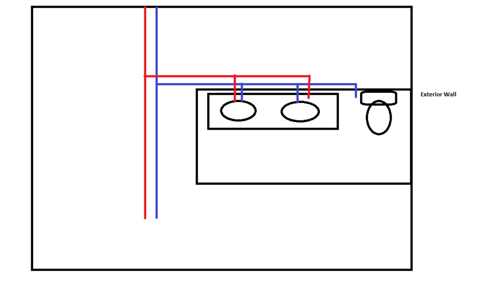

1/2" Copper. If it happens again I'll try to snake it and see. The vanity ahead of the toilet is about 30" away, towards the interior of the house.
I'm not sure of the exact routing, but basically like this.
Right so if it works fin in that right sink, your problem is somewhere in that last 30" or the elbow out to the valve. [just restating the obvious here]
