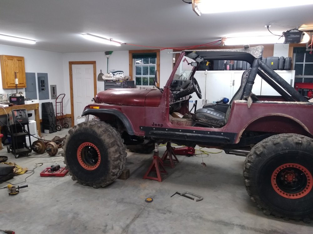

Still running the T5 in my cj...
We'll technically it hasn't run since I pulled the wide tracks out a couple months ago, but I'm going to wheel the mess out of it with these 42's. My 258 has the mopar mpefi kit on it, which I think adds a little power. Regardless I've been wheeling and driving this thing on 33's for years. The trans still shifts tight and smooth. Pretty sure I'll be disappointed with the injected 258 soon and will swap in bigger power with an appropriate trans. But stock power and 33's I've had zero issues in 120k miles on that T5.
