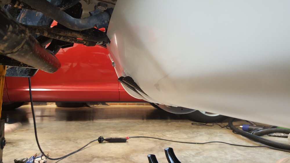

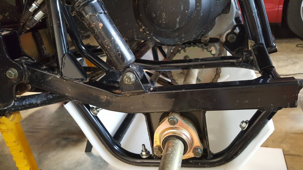

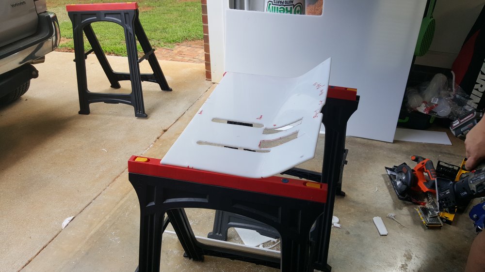

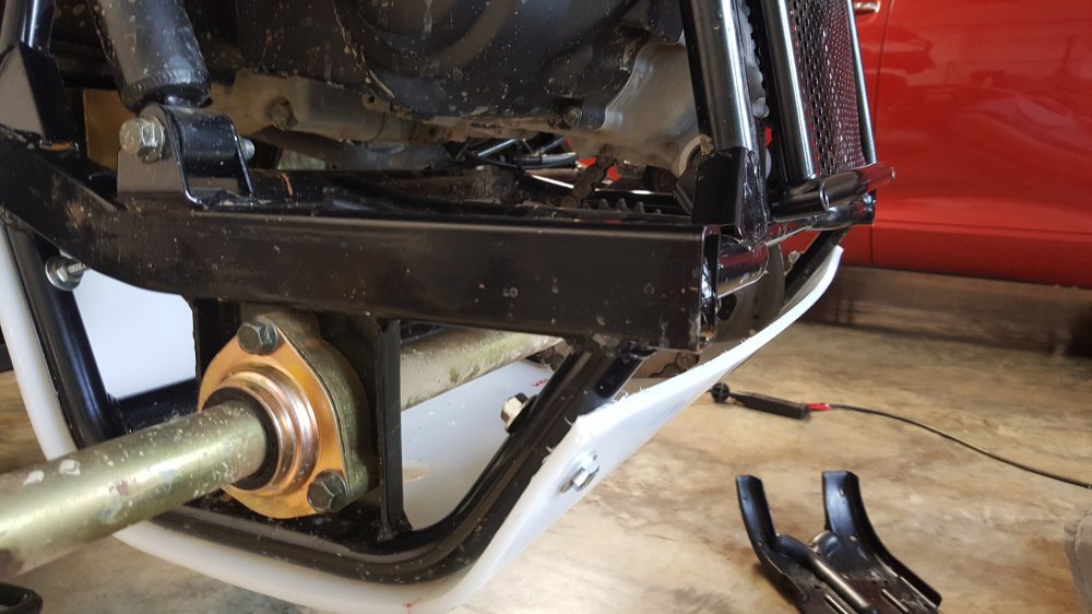

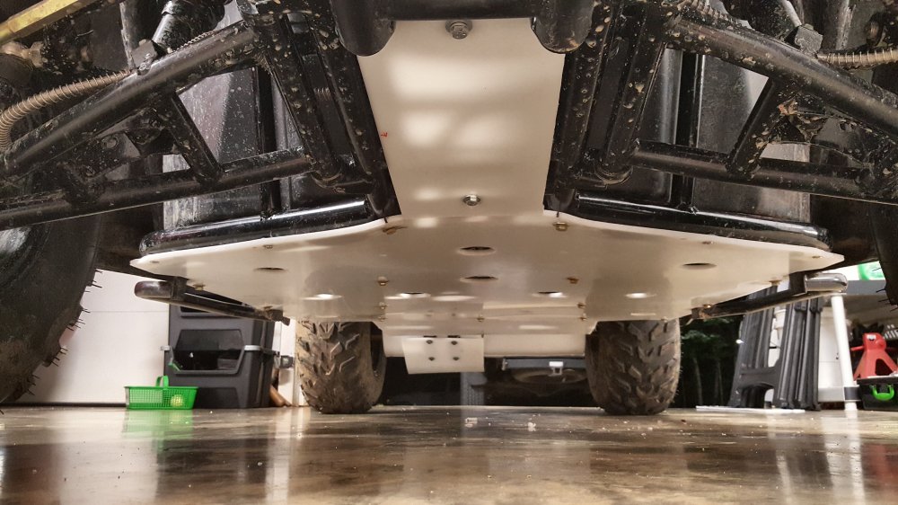

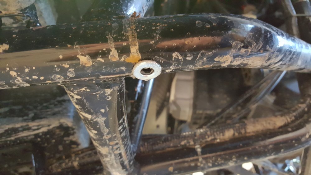

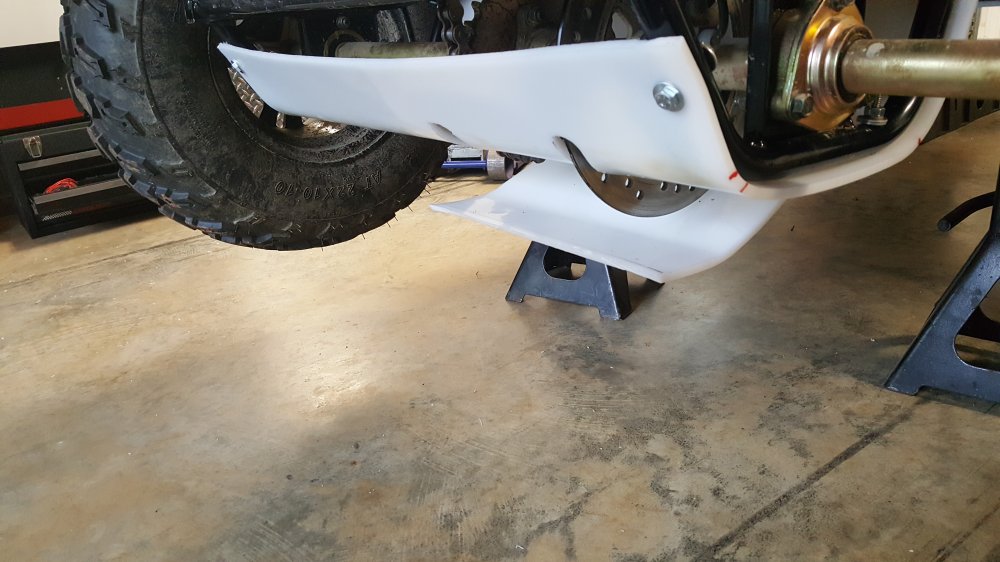

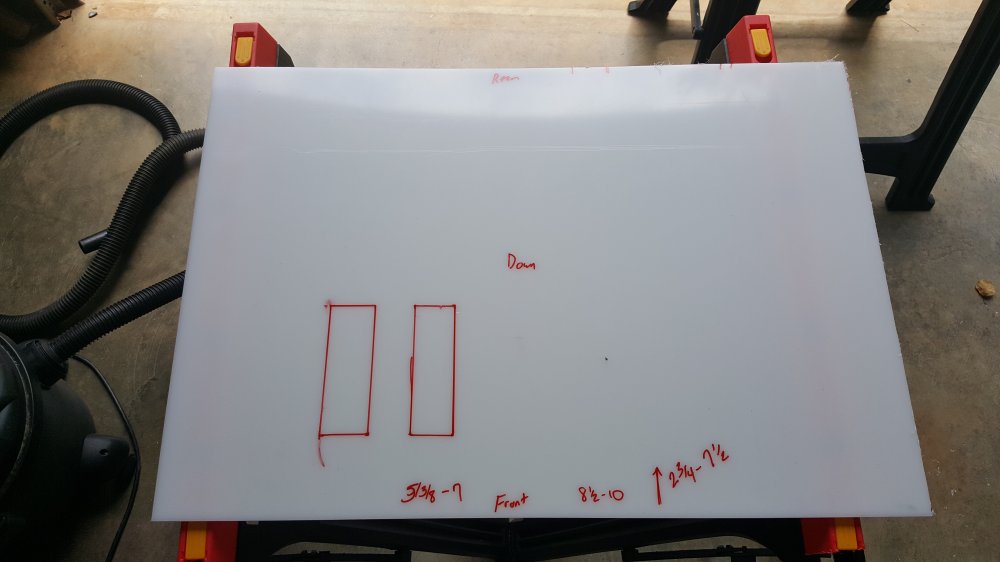

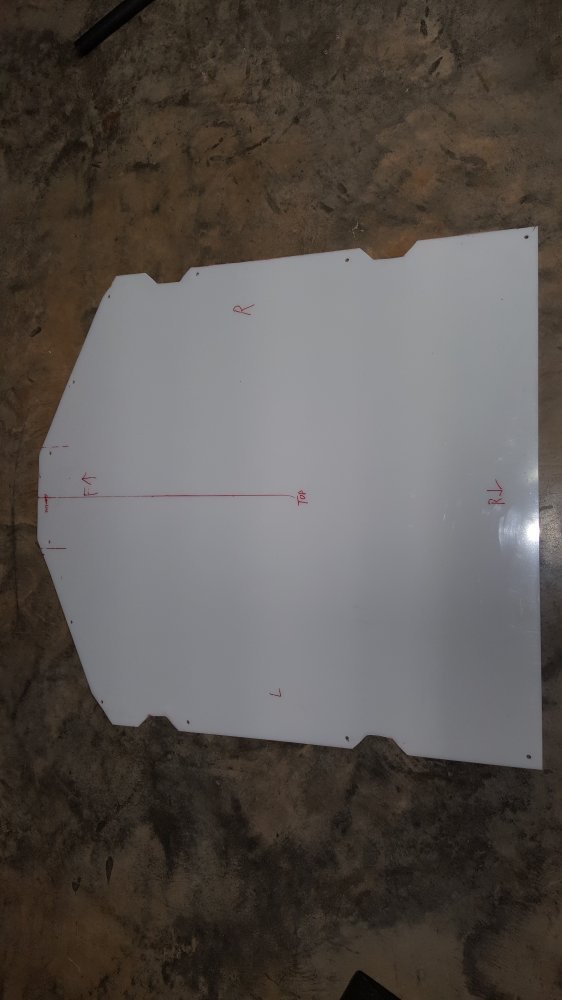

Skid plate

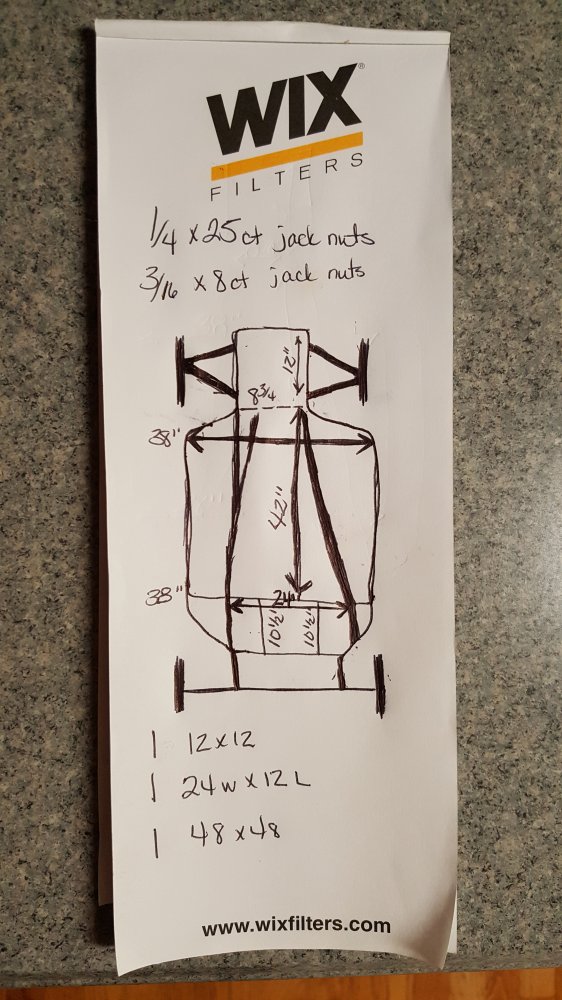

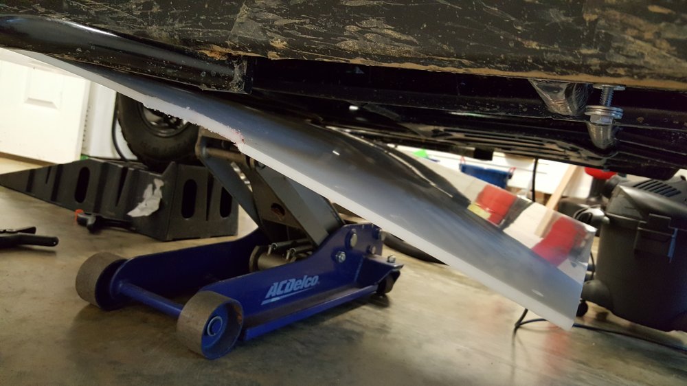

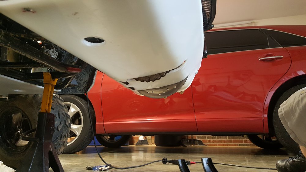

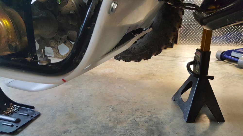

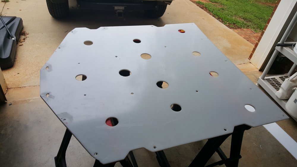

We knew where we ride the kiddo’s would be bashing across rocks and mud. After looking under the machine for way to mount something I came up with an idea. I took a large piece of cardboard and pressed it up against the chassis to get a fingerprint of what it looked like. We then called our local plastics supply house and got a sheet of 4x8x¼” UHMW (ultra-high molecular weight). This stuff is tought as nails and slick as hell. Tracing the cut out I had, I got pretty close and trimmed what I didn’t need. The tough part was keeping it on the chassis without it slipping off so I could mark the holes. This was tedious because I had to measure the distance to the center bars because they are angled and getting it right was curcial because once you drill its done. Another trick I used was taking a bright shop light and placing it in the chassis and using the shadows of the bars to mark them. I then drilled holes in the skid and the LARGE chassis rails along the side and center of the machine being careful not to go all the way thru. I then got HD jack nuts and hammered in the holes on the chassis. I used a router to make the holes on the skid longer sideways on some and up and down on others so I could adjust the mounting if needed or I measured incorrectly. When I was confident I had it I bolted it all up and marked where drain holes needed to be. I used a 1.5in hole saw and put them in the predetermined locations. This project took some time and effort so this may be above the skill level of some folks but it can be done if you take your time and don’t rush. The rear swing box was difficult because of the curved angles on the bearing carriers and low clearance of the brake and drive sprockets. I overcame this by measuring the overall length and width and cutting a bit long both ways. I then bolted the front of the plate up using the same technique as before but going all the way thru as to have more hold power because this is the piece that take the most abuse. I then used a propane torch to heat the material up enough to bend it. I eventually took it off and bent it in between two vise and 2x4’s. Heating the material slowly and applying pressure worked best because if you heat it to fast it melts and burns. This was tedious as you had to bend it then check it, bend more then check. Once it cools it will hold its shape. When I got to the brake and sprockets I used a router to cut oblong holes wide enough for them to pass thru. I still didn’t like the sprockets exposed so I cut another piece and used the factor plastic guard as a guide and shaped one to bolt up where the factory plate was and made it longer. This way if they hit something it will move and hit the sprocket and just slide off or the sprocket can rub on it without causing damage. I finally got everything shaped and bolted it up. It’s been the best upgrade yet.

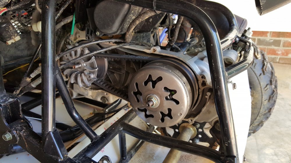

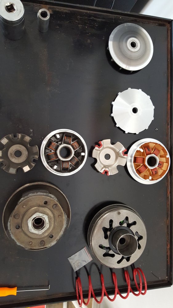

Variator rollers
This machine uses 18x14 Rollers that are 14g factory. Best to measure yours before you adjust them. Check youtube for all kinds of information on these. I am going to try a mix of 12g and 8g rollers to help kick the belt out and get the tires moving. I should have reduced the gearing enough to help with this. I will update post after our first ride.
(UPDATE)
Machine did very well at CAW in SC. Still have clutch slip issue on large hills. Overall the throttle is better and front pulley is working better. Have a "performance" clutch ordered.

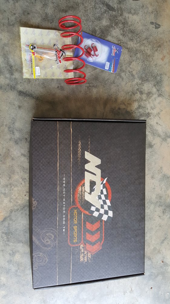

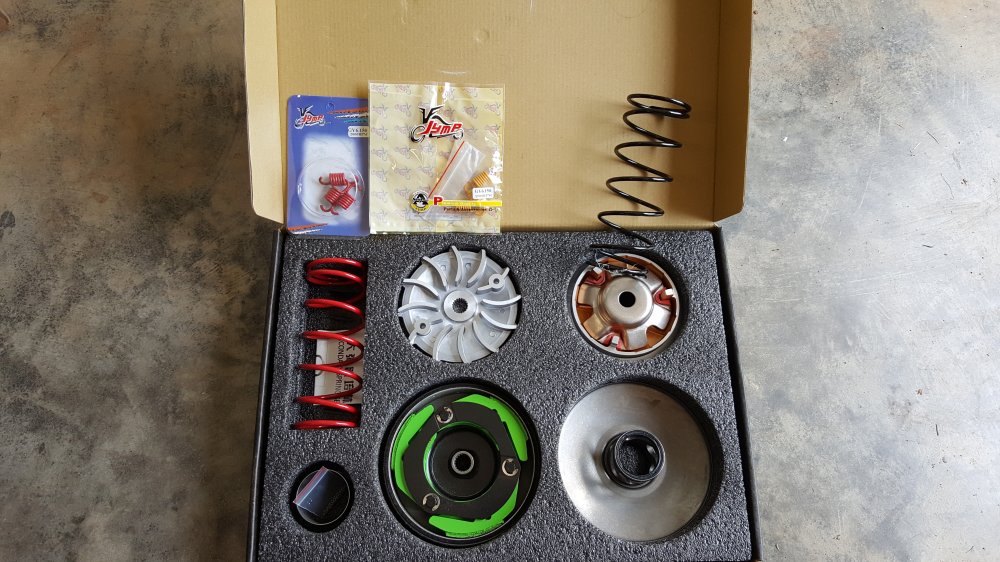

Clutch install went smoothly. After watching several vid's on YouTube University it turned out to be pretty easy. I went with NCY clutch kit and added a 2000 rpm main spring and 1500 rpm clutch springs. It had 2000 rpm clutch springs pre-installed but the engagement was to high for my son and he didn't like the "sound" it made because he thought the belt was slipping. I went with 8g and 10g mix of rollers to get a mix of low torque and keep a little top end. We are going to Uwharrie sometime and I will follow up again on how it does.

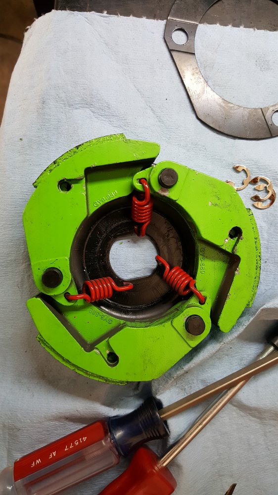

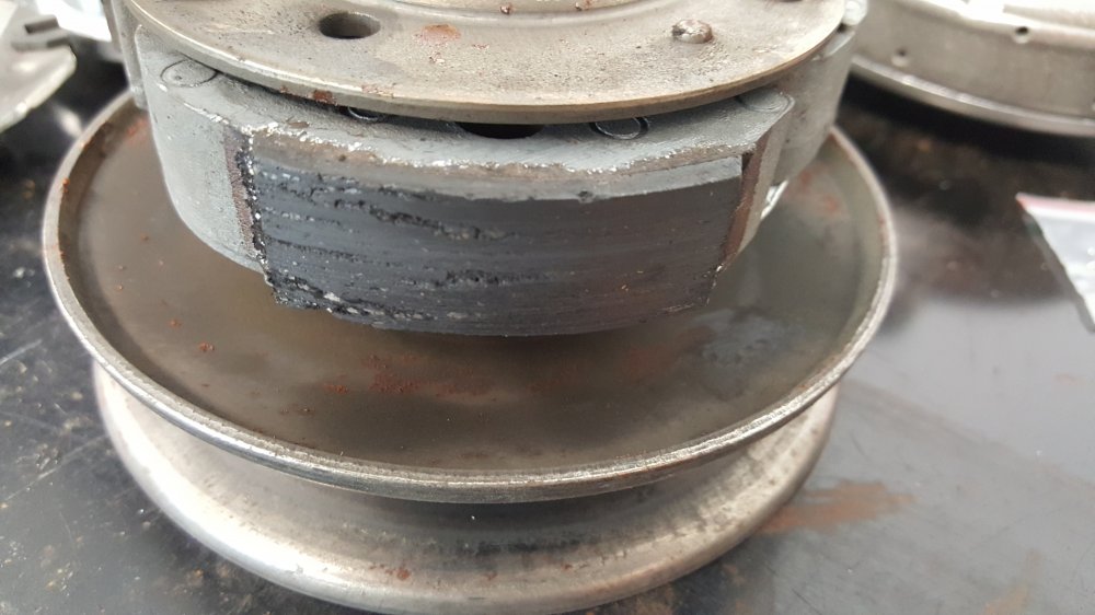

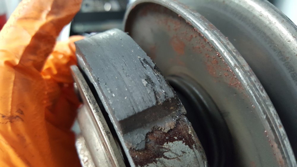

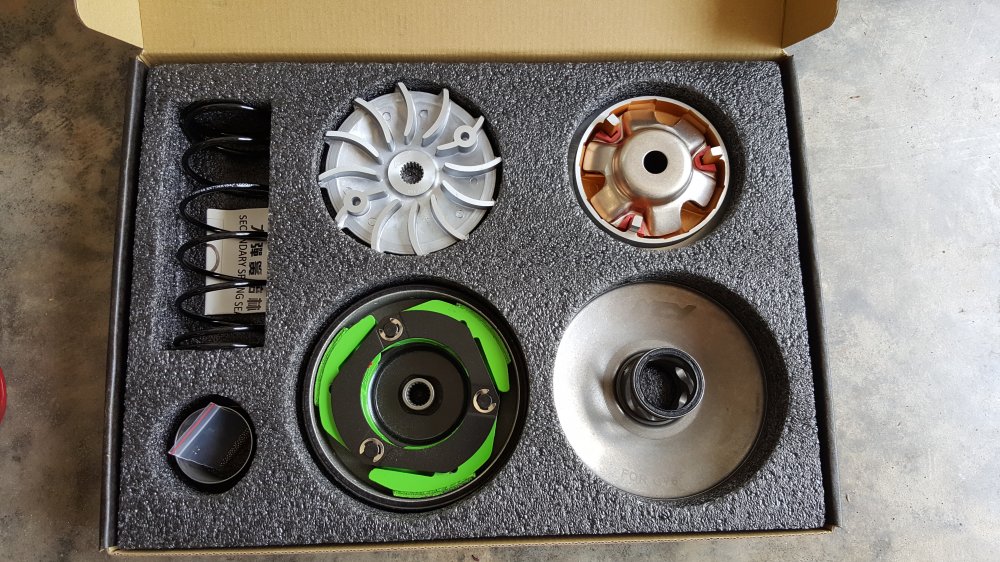

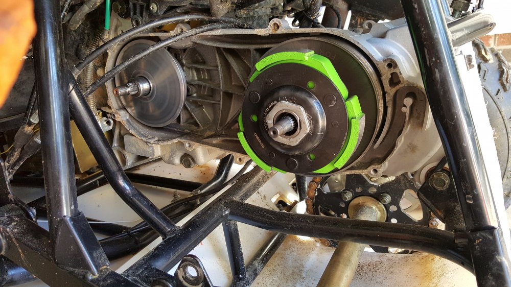

The clutch is NCY with a 2000 Lbs Primary "Red" and 1000 LBS "Blue" internal springs. You can see the factory clutch was getting eaten up in just a few rides. The pictures show red internal springs but I have changed them. The machine needed way to many RPM's to get moving and this caused a lot of grinding gears when trying to shift from N to forward or reverse. They really don't do anything to help keep it in its RPM range because the thing weights 600Lbs. The primary spring works well to "downshift" when slowing down, so stick with the 2000Lb. Variator weights are mixed to give some low RPM and some high RPM gains. Does it really help....ehh maybe, I couldn't tell a difference.
ALSO find a Kevlar belt. The Gates belt is made.....you guessed it..China Its wearing pretty good however.

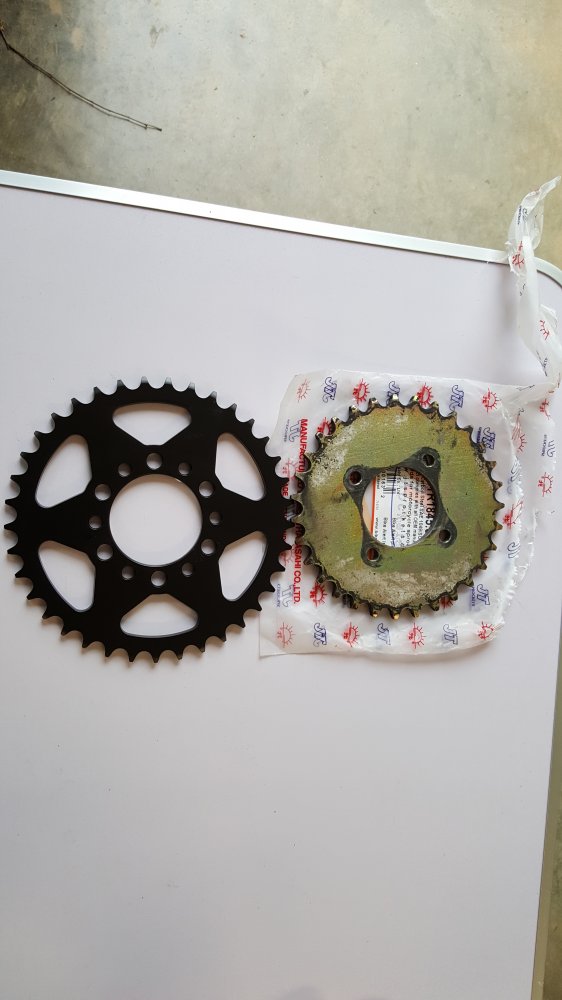

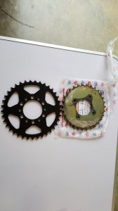

The most improvement can be found in the gearing. As I mentioned before JT sprockets JTF569-XX Front and JTR1845-XX Rear with RK XOring 520 Chain. I am running 569-12 and 1845-43 now. This setup works well and the thing will "change gears" better climbing a hill because of the ratio. I have lost about 5-7 MPH top speed but who need to go 35 MPH on a trail.
This is a factory (right side) v/s JTR845-37 Big difference! Just remember the larger the sprocket, the more hangs out the bottom to have to cover up.

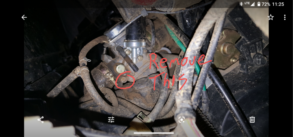

Can you show me what you did (pictures) to the carb and muffler? I would like to also open it up a little and was thinking that would be a good place to start. Really think another great mod would be to lift it 2-3" higher for more clearance.
Thanks.
This is the screw in question. Viewed from passenger side. You have to remove the plug that is hiding it.(I had to drill it but just enough to break thru not damage screw)
Adjust at your own risk. I think that left (loosen) is to richen the mixture. I would adjust in small increments as not to make it so rich it smokes or fouls plug.
In the process of replacing the front sprocket with a JTRF-569-12 520 chain and notice the 520 sprocket is thinner and does not have the spacer like the original on backside. Also the original retaining clip is smaller and does not fit. What did you do in these scenarios?

Again no notifications from website that I have had any new posts sorry guys. In regards to the chains You have to replace both sprockets or the chain won't work. I had to file the ends of the retainer down to fit and had to use round allen head bolts. Remember to use blue thread lock on everything.
