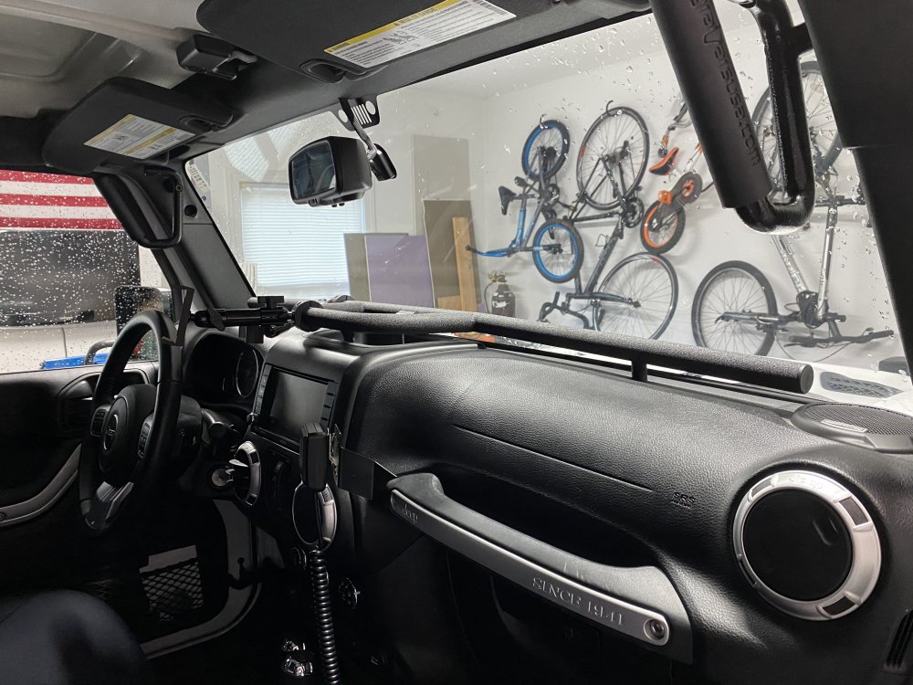

Not having a phone dock sucked, so I ordered up a Vector Off-road dash bar and a couple 67 Design phone holders:

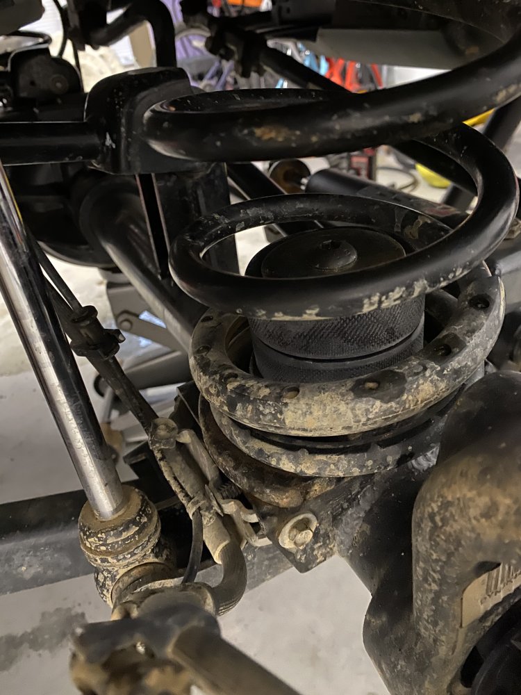

Installed some Metalcloak bumpstops to keep from bashing my relocated stabilizer.

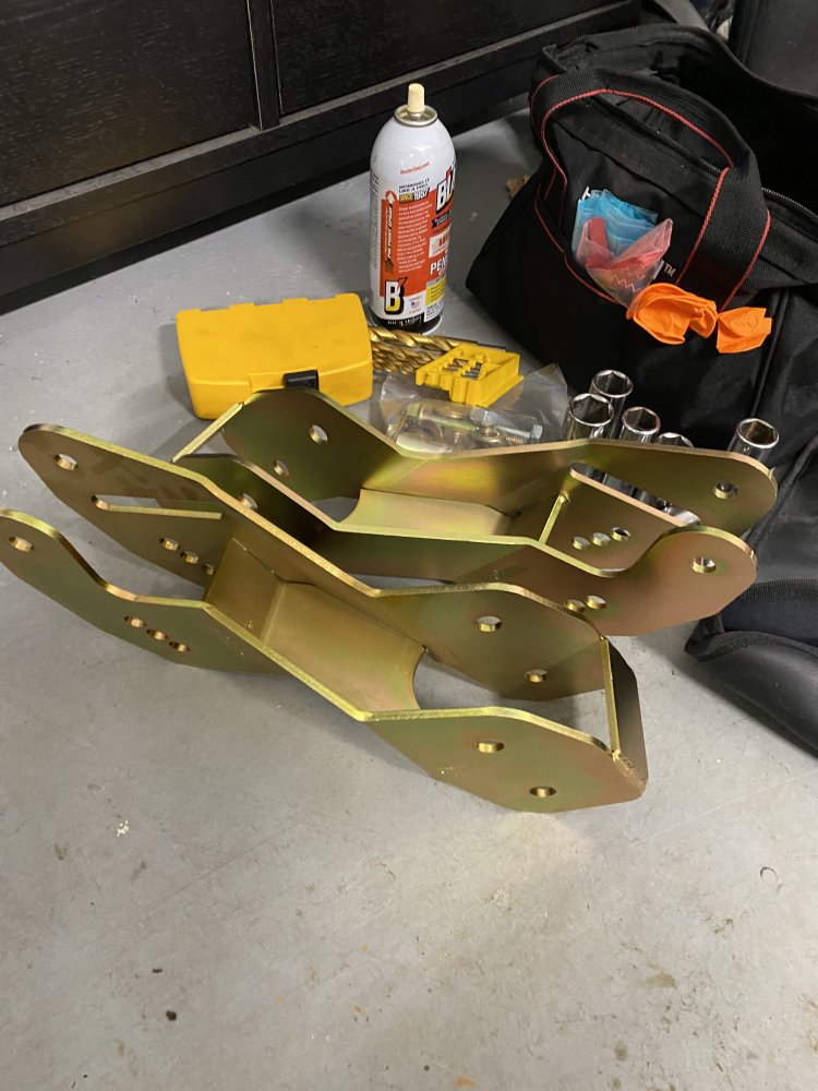

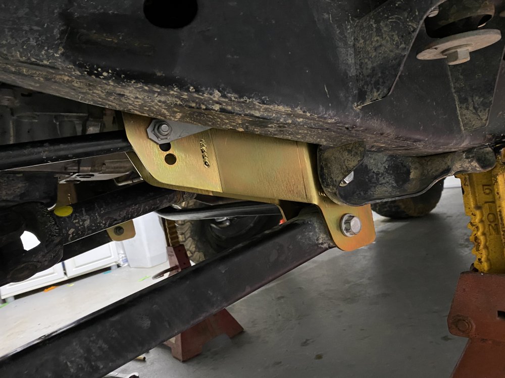

Installed the Metalcloak front link relocation kit to bring the caster back in line. This made a big difference in braking performance as well.

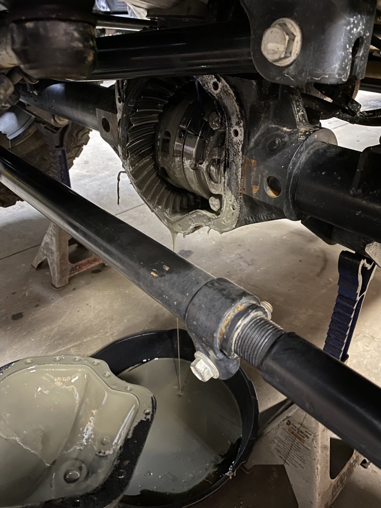

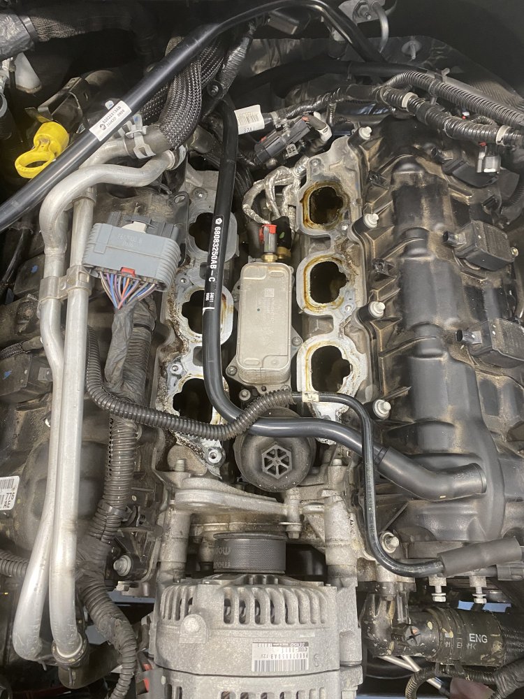

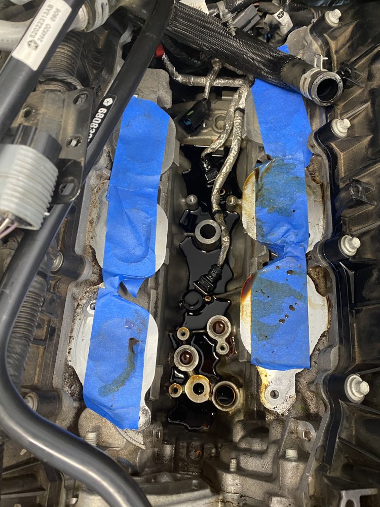

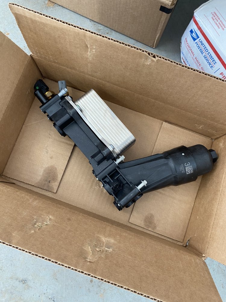

@Chris_Keziah helped me to diagnose the drivetrain noise and a surprise oil leak. Looks like some water got in the diff on the last trip and toasted the pinion bearings. Also discovered that my oil filter housing is cracked and dumping oil :shaking:
Parts on the way.
You got that ProRockFoty-fo money so you should probably change the fluids after every trip anyway ;)
Damn man. Where was the part cracked at?
