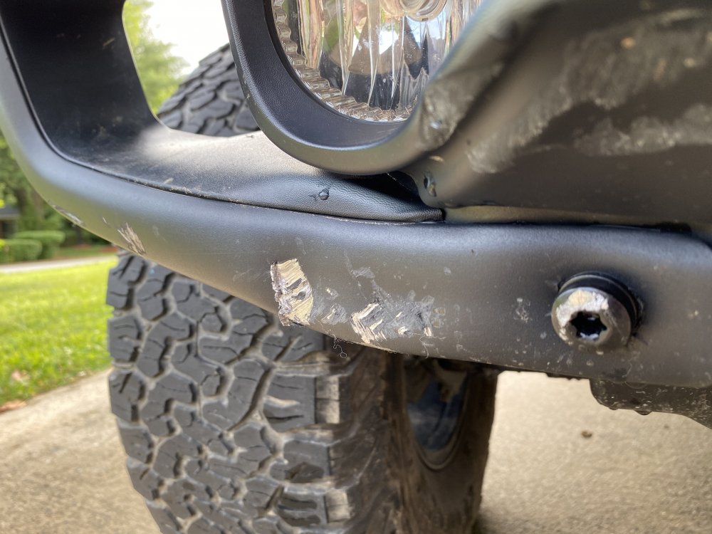

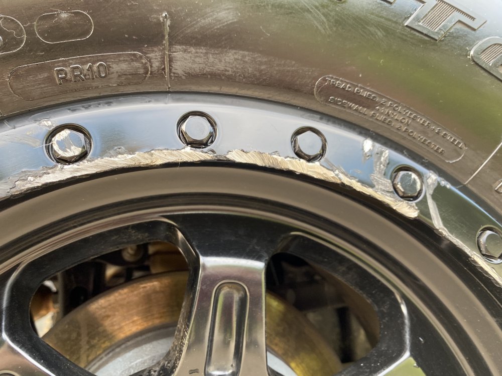

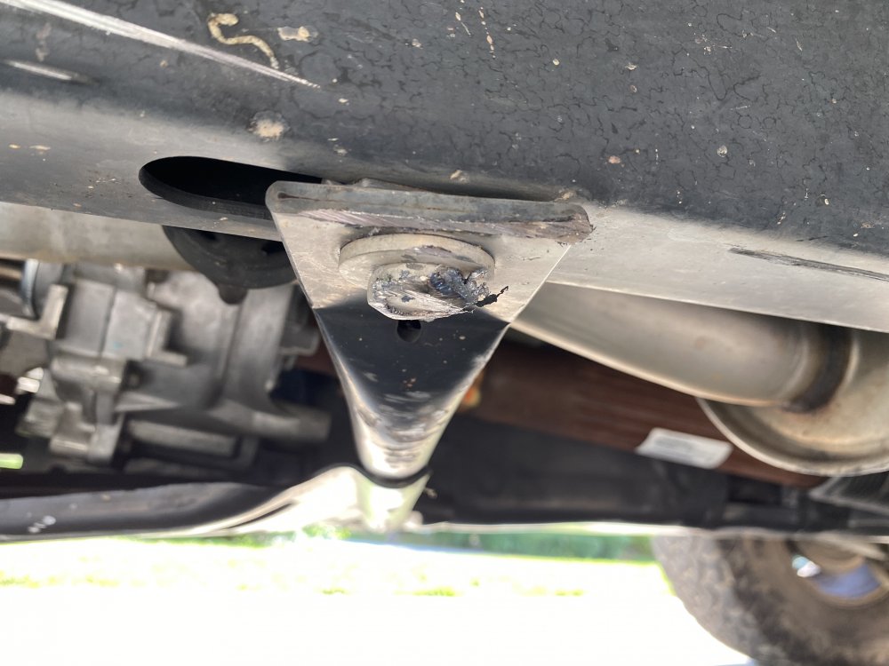

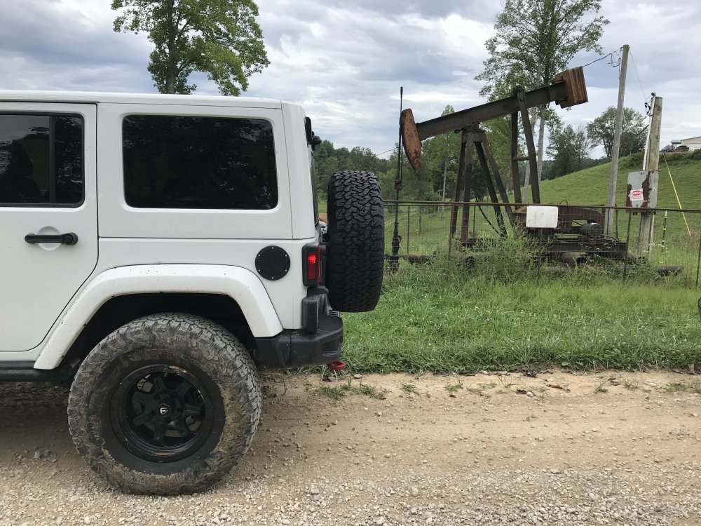

Potts was a lot of fun and, despite the damage, I really enjoyed the weekend. As @Jason W. and @josh$$ predicted, the tie rod and steering stabilizer were the first victims. Shortly thereafter, the PS bumper stanchion folded in a couple of inches. I got an education on the JK electronic stability system and we straightened the steering wheel out good enough to get home.
A couple items of concern: On the highway ride back, the transmission would sometimes downshift from 5th to 2nd and I’d instantly lose 15mph before I could get it to shift back up a couple of gears. This made for a dangerous situation on a couple of occasions and I’m lucky to have not been rear ended. I’m hoping this is related to the stability control thing and will correct itself once I get the steering fixed. My second theory is that it could be a similar calibration issue caused by the oversized tires. Although I didn’t have the issue previously (?). Maybe getting the control points reprogrammed via an AEV Procal will help with this (thanks again @josh$$ for the lead).

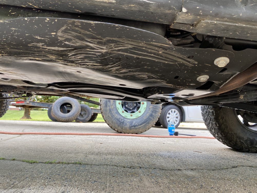

Secondly, I may have bent the front axle housing or Cs. My DS tire has 2-3 degrees more camber than the passenger side now. Will have to do some more checking with an angle finder to confirm.

Damn, It did not look that bad when we got off the trail. I would say between that and tie rod was the cause of your driving issues on the way home.

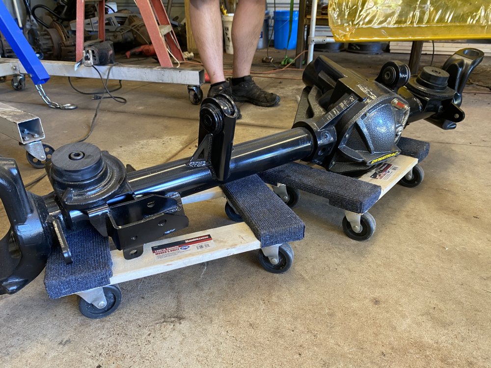

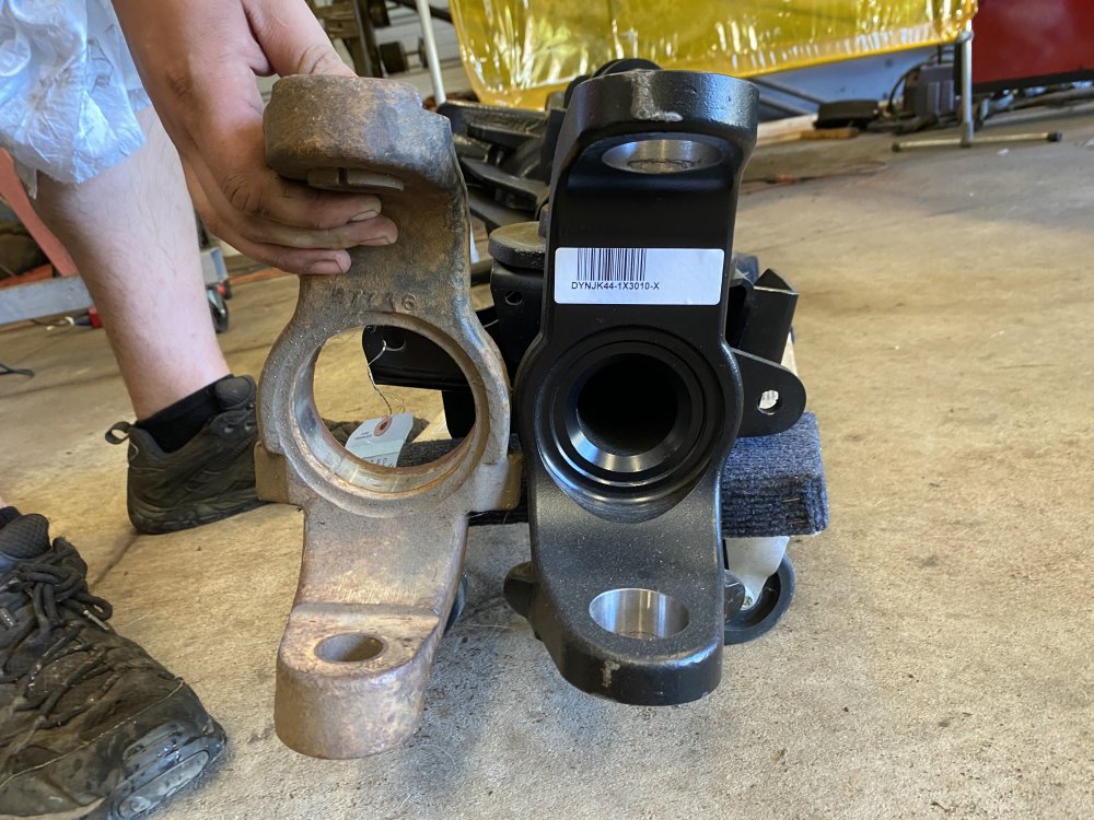

Got the steering parts in. I’m about 95% sure I’m going to go with the Pro Rock 44 housing. Someone buy DoubleMint and make it an easy decision for me. :)
I’m a couple months behind on posting...

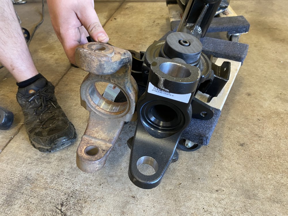

There was a little bit of drama around the specific part number of axle housing I ordered. Without belaboring the issue too much, the company’s website from whom I ordered the ProRock44 housing was misleading and I ended up with a housing for an ARB rather than the factory Rubi locker. It didn’t seem that the company would get me the right housing so I needed to make this housing work.
Adam pulled a rabbit out of his hat and found where someone used off-the-shelf Timken bearings to install the larger-bearing Rubi locker in the smaller-bearing housing. For reference, I needed qty 2 of each:
Bearing JLM104948
Race LM104912

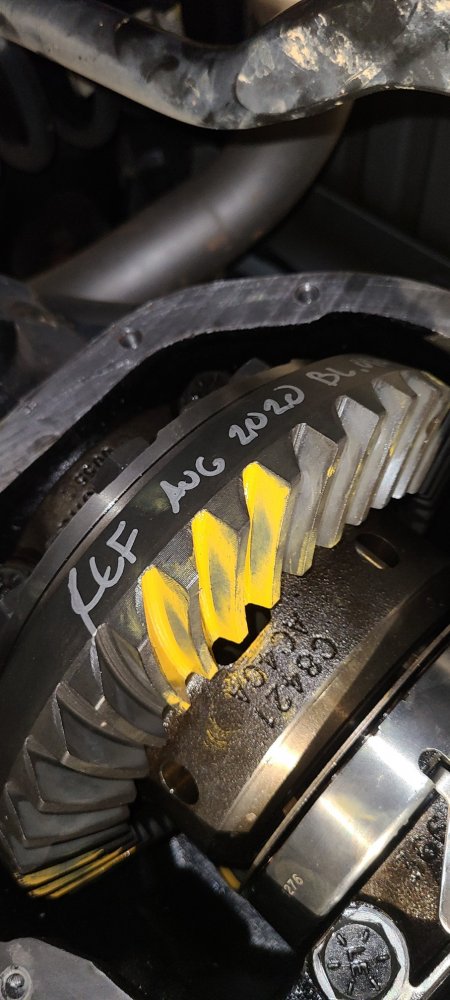

... and a pack of shims. Once these were in hand, Chris sent me gear pattern pics of the new Yukon 4.88’s and I walked around with a boner for a few days in anticipation of getting the Jeep back.

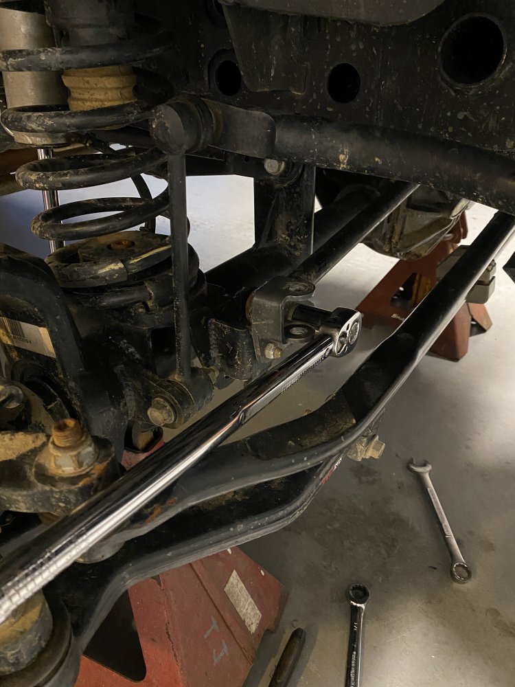

I started getting death wobble on the highway, but checked the track bar last week and it seemed tight. We had another incident of DW today going across that shitastic 52 south bridge over Waughtown.
Obviously something was loose, so I pulled it in the garage and retorqued all the front suspension bolts. Turns out both upper link bolts and one sway bar bolt were loose. It was a good reminder that anytime you do suspension mods to retorque everything after a few hundred miles.
