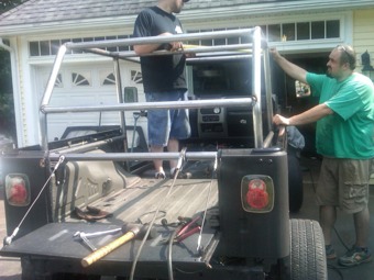

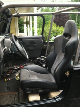

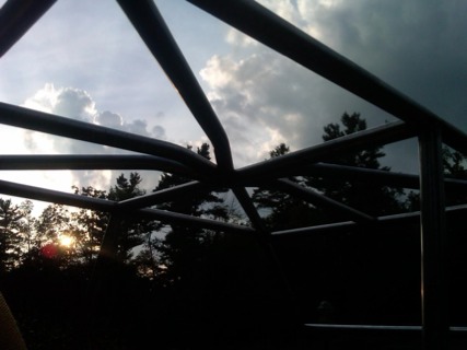

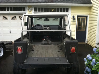

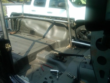

So, the main lay out of the cage is done. It's all tacked in, A, B and C pillars. Now to start working on the support bars. The rear seat lay out is all figured out... then need the front seats and harness to get that done
Tig welding all this Chromo's going to fun...

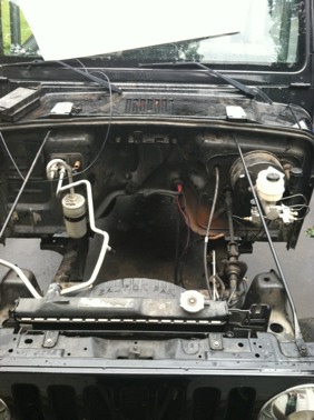

so... Kinda a NEWB question but, my Jeep won't start now. Any ideas?

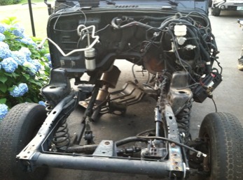

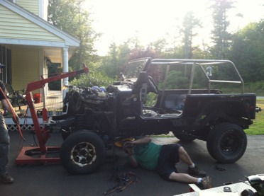

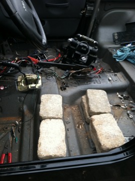

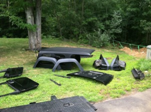

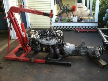

Fri night- pull the body kit and hard top & pack up for the guy I sold it to; pull the motor, trans and aux. Stuff and crate them for the guy I sold them to. That got done.

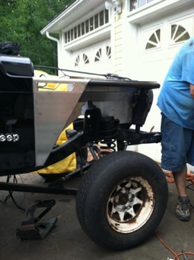

Sat- the plan WAS to get the lower part of the cage done and get the stringers done for the cage.... BUT me being a sucker that I am I agreed to get a set of fenders welded for a local guy who doesn't have the know-how to do so- which means his stuff got done- not mine.

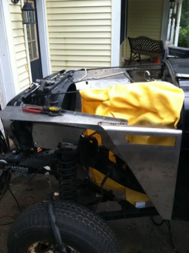

. Thanks SO much to Shawn and Tim for being flexible and helping out with all this- it wouldn't have gotten done without you guys! On a side note- WTF Rokmen. How about something in the form of good pictures or specs for putting these together. I'm glad these aren't my fenders.... To be this expensive unassembled that it absurd.

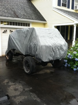

We thought we'd get the stuff we planned yesterday done today but... It's raining and there isn't room in the shop to get the Jeep in to weld so... Here she sits:

Lots of progress made on the cage this week...

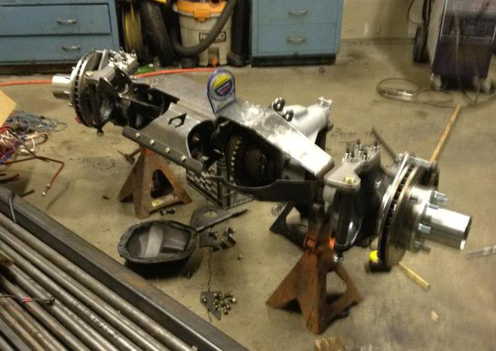

Front axle is gonna be ridiculous...

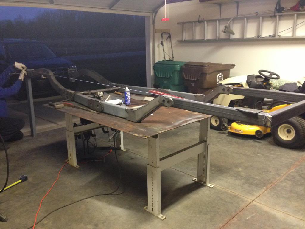

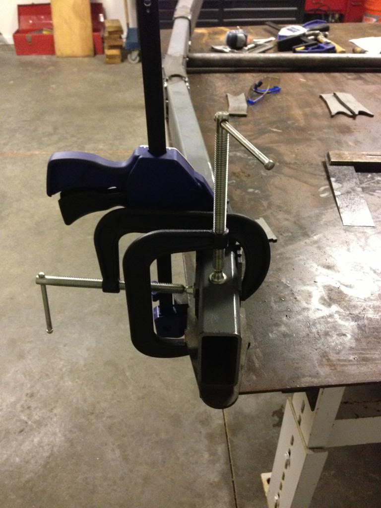

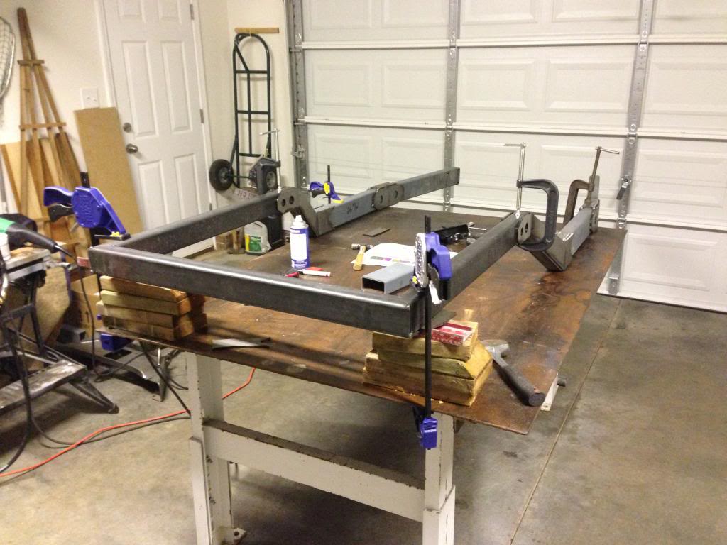

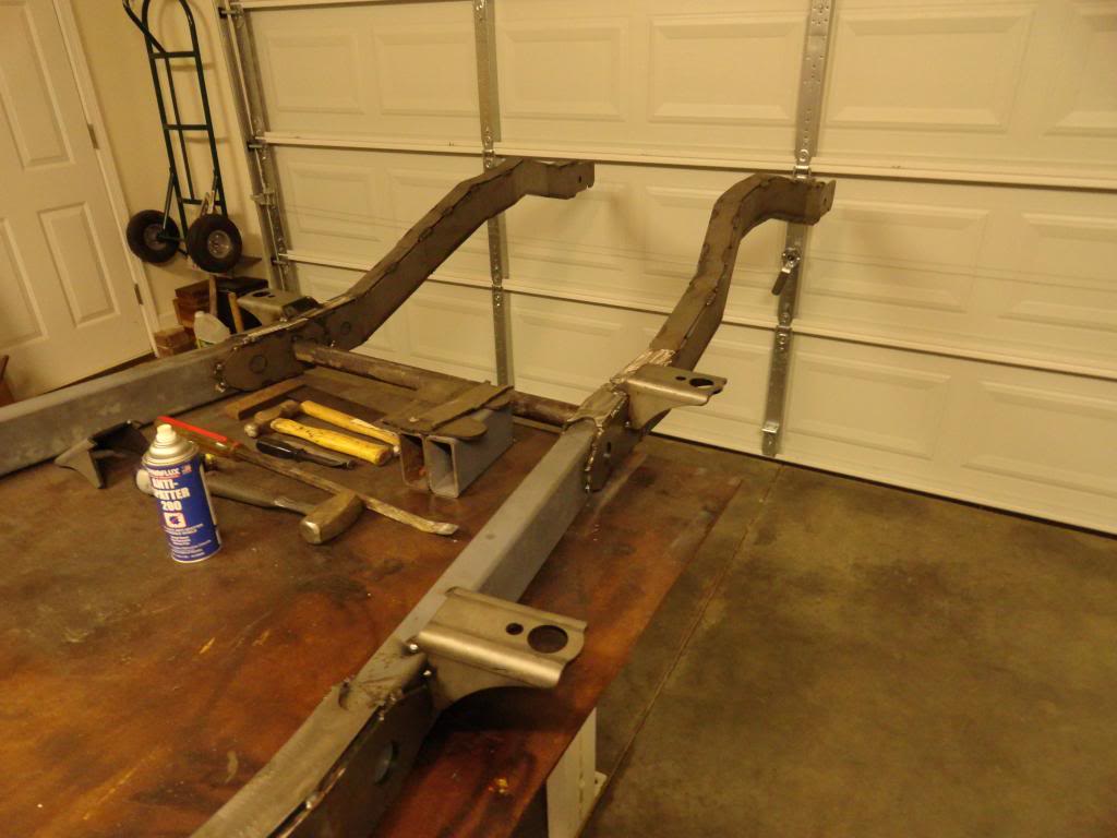

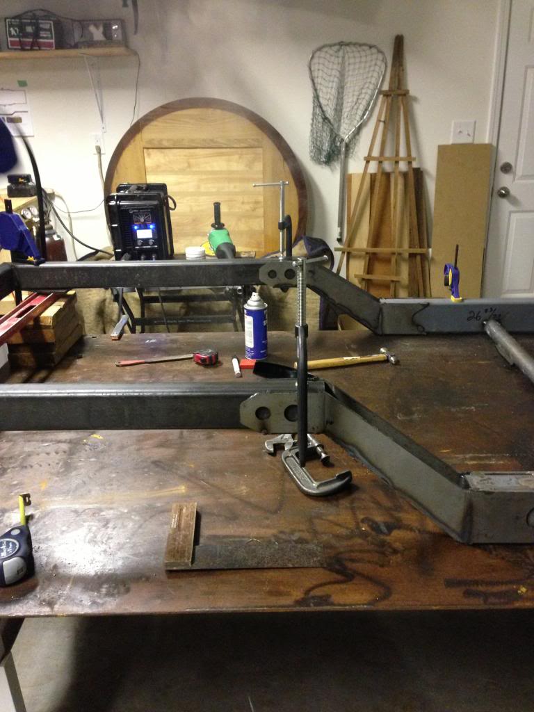

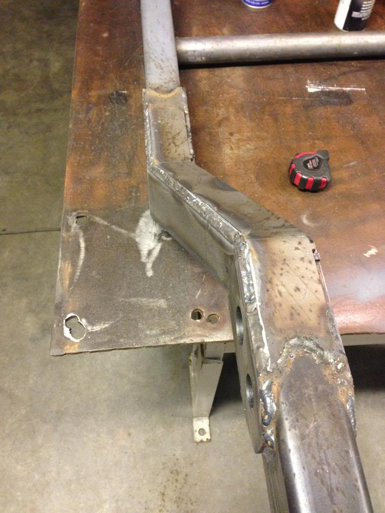

After a long winter of craziness, we're back on the wagon. Here's the pictures of the frame build so far. We have some church things this weekend that may keep me from finishing it but it is really going along well so far.

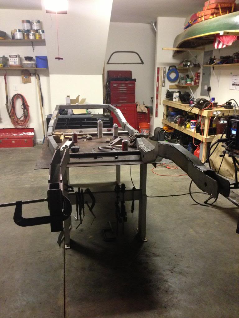

Front half is all stitch welded in place now. We've been taking it down and fitting it up to the tub periodically and it really is fitting up nicely.

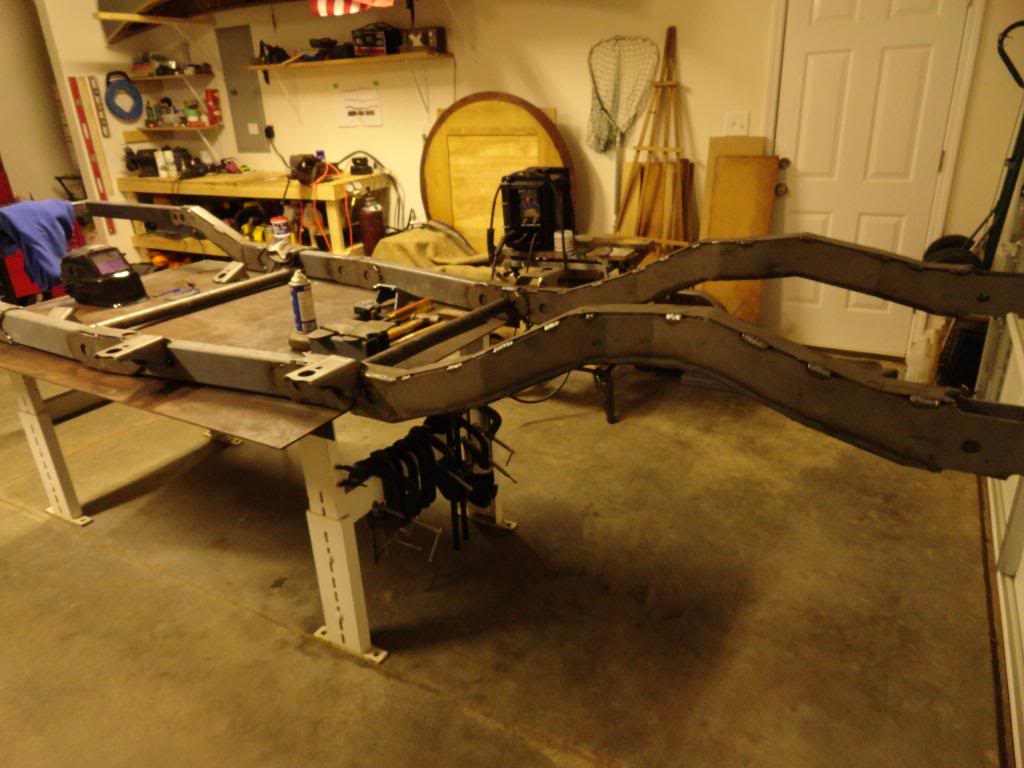

yes, i know Alex... you are a better welder than I am :-)
You arrogant bastard :-). I actually used to be a very good welder, it's just that now that I have a job where I wear a suit and not a RedKap shirt I only get to burn metal a couple times a year. Amazing how much better they have gotten just through the course of this frame build though... starting to look like dimes again.
Big step last night... BODY MOUNTS! Really starting to look like a Jeep frame now.

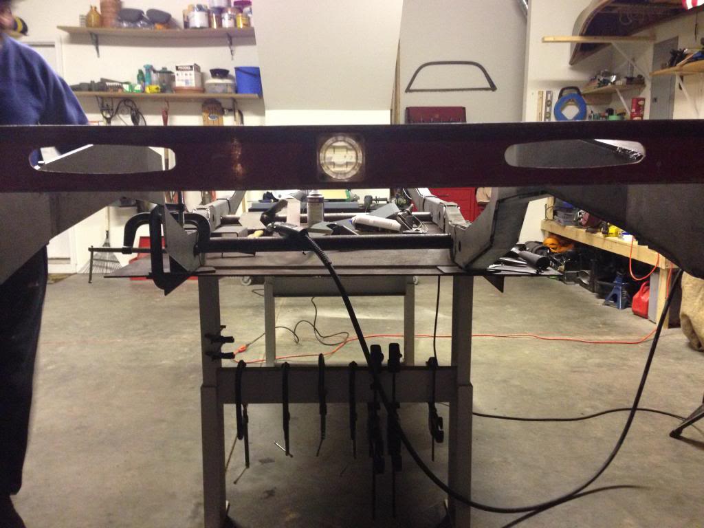

In a related story, more frame... everything is stitched and tomorrow I'm bolting it up to the tub to get some measurements for the rear cross brace, the front bumper, and a couple other little adders
