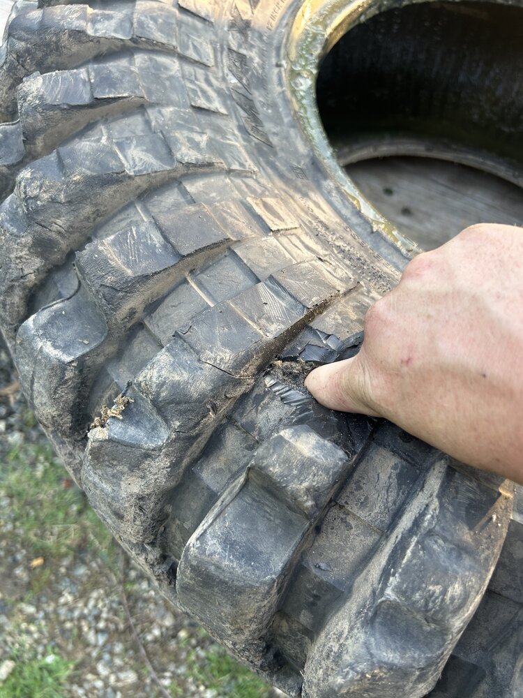

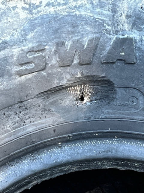

I have two 42" sticky treps that I would like to get "professionally" repaired if possible, instead of buying new(er) tires, or wasting my time trying to diy a half-ass repair that may or may not work. One of them has 2 small holes/cuts in the sidewall (about 3" from the bead) and 2 pin holes in the bead of the tire. The other tire has a gash/tear in the bead with a flap of rubber hanging on. I took them to Aiken-Black in Hickory this morning. They have fixed tires for me over the years. This time they told me they couldn't repair these 2. They can't do anything about the bead damage, and the 2 holes in the sidewall are too close to the bead for their repair to work.
Reaching back into my foggy-at-best memory bank, I seem to remember having a tire that somebody else had previously vulcanized/repaired at the bead. That makes me think it can be done. But my memory has been known to fail me before, so maybe it can't be done.
Anyone had a tire bead repaired before? Anybody have a recommendation for a shop that will try to repair a tire that nobody else will? I don't need a guarantee that it will be leak free...just looking for someone who knows what tf they're doing to at least give it a try.

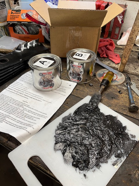

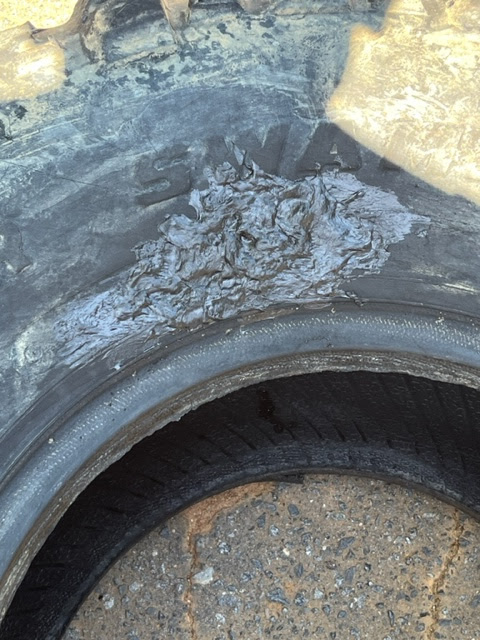

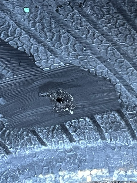

I got my kit yesterday and did the repair today. It didnt go as good as the instructional video but it seems to be hardening up well.
Outside
Inside
The goop
The finished product
Oh, I mixed mine by hand…. I was a real idiot. And scared for a good 5 mins til it started mixing well. My wife had quite the enjoyment watching me freak out
The new directions say to use gloves to mix so I did and it was a cluster fu$k! That sh!t ate the gloves I had on so I got the dollar store cutting board and mixed it up. It would have worked out with just my hands. I shoulda practiced first...
I figured the gloves would get stuck and tear… seems I was correct lol
