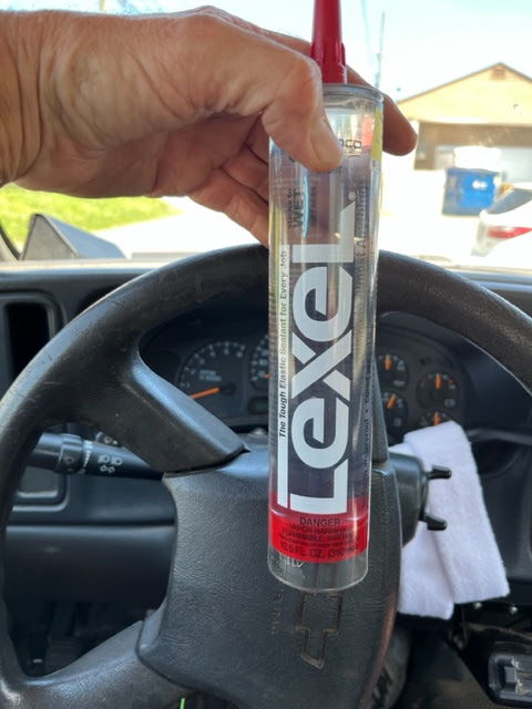

The 3m windshield gasket was the goto for years. You would basically consider the tire and maybe wheel junk after using it, because it would not come off. You can find it at any parts store.

This was more or less a last-ditch effort at stopping/slowing down the leaks. I was committed to this "repair" and the idea that if it didn't work, I'd be looking at new tires anyway.

This replaced the window weld with this stuff, an engineer friend said it's the stuff so I used it. Looks like I have a sealed up tire so I'm gonna run it. @LT1JEEP , that's a great idea you have there, If I would have known I would have tried that too. I think this tire is molded to the rim forever now! lol
