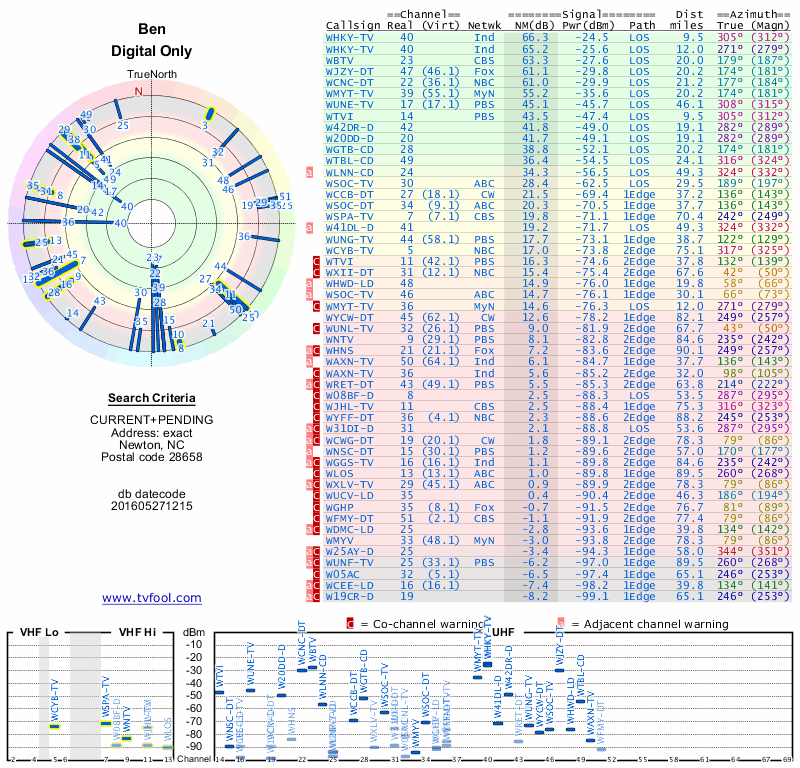

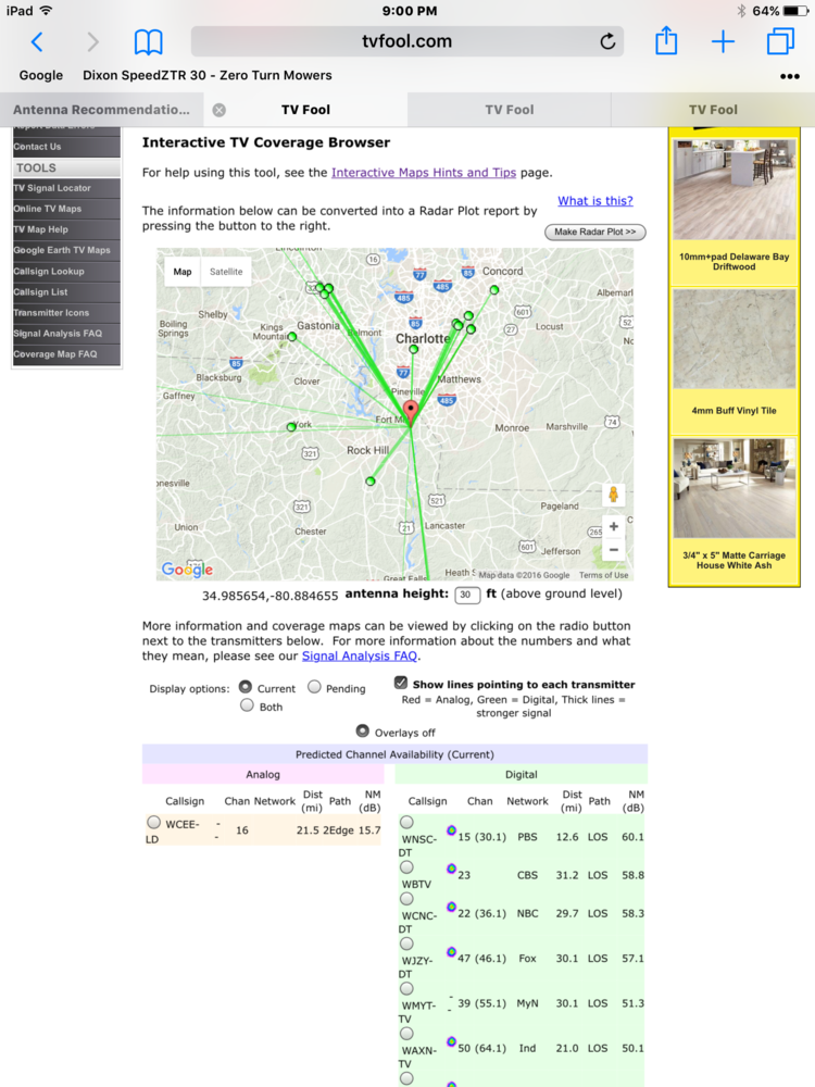

As a spinoff to a few other threads, I am looking for a good antenna to pick up over the air channels.
Based on the antenna maps I have pulled up, I am looking for something omnidirectional with ~40mi reach. I don't want something that I have to rotate for different stations.
Any recommendations?

Might want to check the maps again and see what bands those channels are in. This can tell you if you need a VHF/UHF unit or can do UHF only, etc.

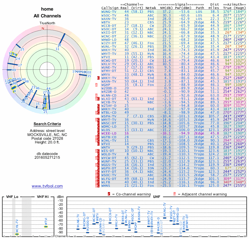

freaking no-mans land for me.........looked at this before and decided i was fairly screwed for any decent reception
I think I'm in a good area..... Just need a better antenna. Not getting some of these channels, but I did buy a cheap directional as kind of a trial... Guess it's time to upgrade.

You'd be better off with something omnidirectional. You have signals to the east, but also to the northwest.
