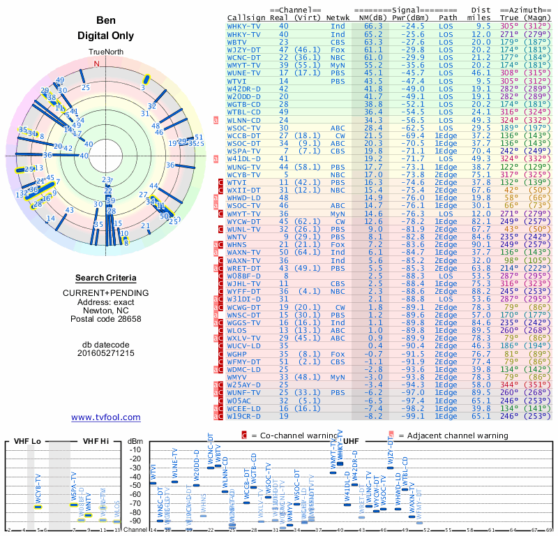

Heres my map. Not to bad, but everything is spread out.
I think you're in good shape, based on that map. If you just had a halfway decent omni-directional antenna and pointed it due south, you'd get CBS/NBC/FOX/ABC at least. Those are all on UHF (channel 14 or higher for the kids out there), so you'd be okay with a UHF-only antenna. You'd be better off with an antenna with about a 180* reception range and split the difference by pointing it SW or WSW. You've got a few strong signals out of the NW (PBS, an independent) that would probably be nice to have. One like the one that Fabrik8 posted back at the beginning of the thread might work.
That's what my interpretations were also.
Is there any issue going with "too good" of an antenna? Im thinking crosstalk/interference from other channels.
I guess you would just not amplify or turn down the amp if so?
To answer the crosstalk issue, I don't see any co-channel issues on the chart you posted.
As for the "too good" question, it depends. The antennas direct page has the gain diagrams for the clearstream 2v antenna. It shows that it's at least unity gain (1:1) across a 120* wide band. That's pretty good. The VHF reception isn't quite as wide. It's unity gain across about 90*, then drops to -5dB once you get out around 120*. You could probably pick that back up with an amp. The only 4V diagrams I can find are tiny, but suggest that it's much more directional than the 2V version. It's got a hot spot right in the middle, but the reception pattern isn't nearly as wide. That suggests to me that - while the 4V version is rated for more distance - it's sweet spot is much narrower. Given that your PBS station is 130* off from the networks and all the signals are relatively strong, I think you want to bias in favor of the antenna with the widest possible sweet spot, rather than one that is really strong but very directional.
To think of it another way, you want something that has good peripheral vision, rather than a telescope which can look at one thing in high detail at the exclusion of everything else.
