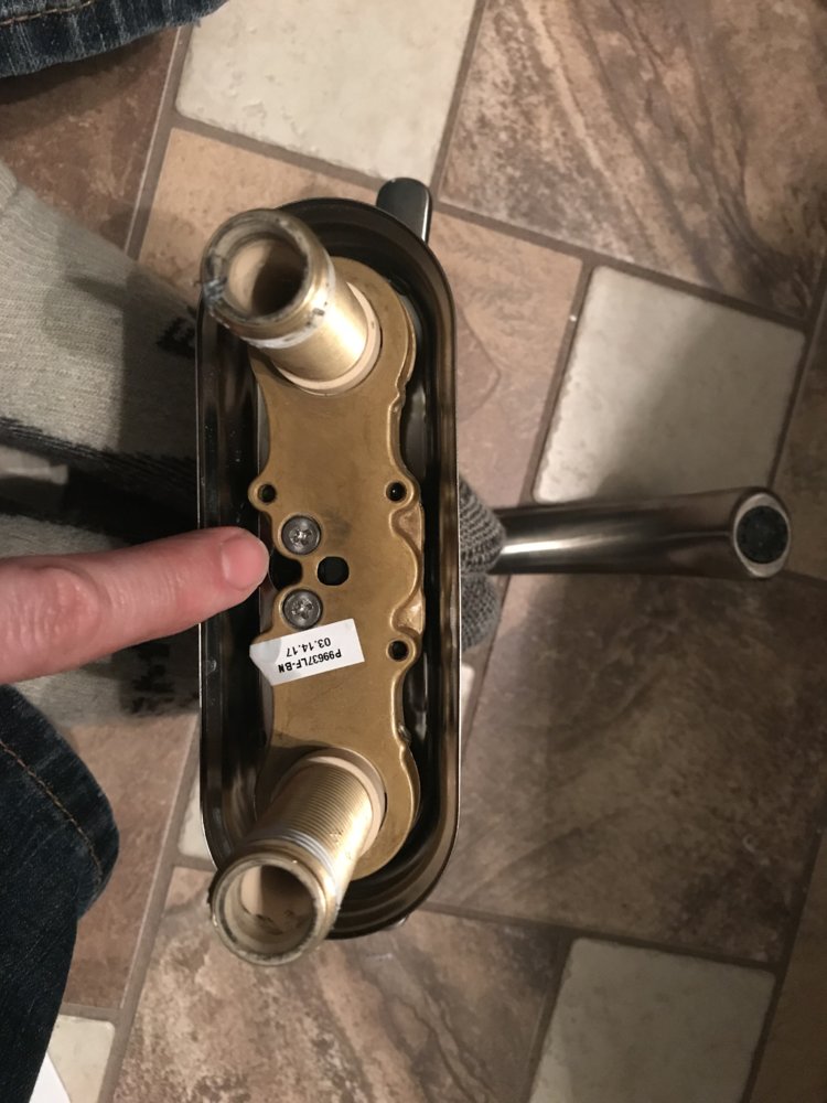

I have literally spent hours today on the bathroom sink faucet and all I have to show for it is a wet floor and how to carry my toothbrush to kitchen to brush my damn teeth.
Long story short, my old faucet was dripping, so I pulled the valves and went to store. I couldn’t find any replacements so I bought a $50 Peerless faucet. Installed it and it leaked in the center hole under the sink.WTF? Thinking it defective I went back to the store. They didn’t have any exchanges, so I bought a $60 peerless faucet. Installed it and the same damn thing. Leaked from the center.
This ain’t my first rodeo. I’ve installed several. I looked underneath and noticed both of the new model have the same construction. I tore the latest apart and it’s basically at the cold/hot mixer that they are leaking. Is this a manufacturer malfuction? Or am I doing something wrong? I shouldn’t have to open the faucet to seal something should I? I snorted to the instructions but nothing new to me there.
Typically its just a little ball valve in there. Is it just that the seal is leaking?
It sounds like shitty manufacturing to me.

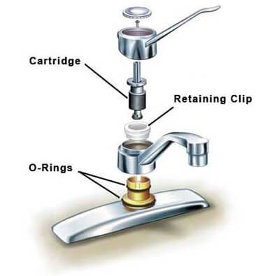

Most 2 handle are compression or cartridge
Compression tend to start dripping after 5-7 years. And it's just a disk and o-ring
Cartridge types, it's a cartridge issue
