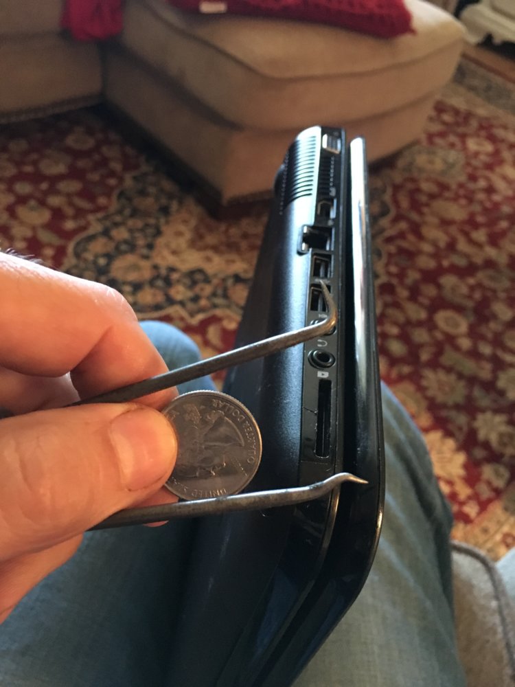

Somehow a Quarter found it's way into the SD Slot on our laptop. the slot is too thin to fit tweezers in and have them open enough to get around the quarter. I've tried tapping/slapping the lap top into my hand to knock it out but it's pinched in there pretty tight.

Could you use scribes and picks? If not youll prob need to do a partial tear down
I'd try to bend a pick out of thin stiff wire. Something with a gradual bend to snake around it and try to roll it out. Other than that, a toothpick with a drop of superglue might work. Maybe modify the end of your vacuum hose to go over the slot and see if you can suck it out.

I took out the blanking plate from my laptop SD slot, and measured it. It's 0.951 inches wide (rounded to 3 dec places), and a quarter is 0.955 inches (that's the listed diameter). The slot steps down to 0.92 inches about halfway down the cardslot depth, so that's probably where it's jammed.
So I can see that's a pretty fun thing to get out. The blanking plate is 0.085 inch thick, so you have a tiny bit of wiggle room with a 0.069 inch quarter.
I'm brainstorming solutions that haven't been suggested yet. I actually like the superglue idea, because I like adhesives a lot.
I think doing a partial disasembly is the way to go though. Most of the sheet metal cardslots have cutouts in them, so it should be really easy to get the quarter out if you have access from inside the laptop.
