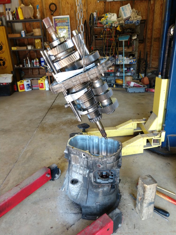

I tore in to trans #2 yesterday and it appears that the only issue is that the roll pins fell out of the "shift finger". I think I can get by with just a couple new roll pins in that one. I'm really hoping that will get me by for now.
Some day, I will end up dismantling #1 and #3 and try to build another out of those. They have much bigger issues.
