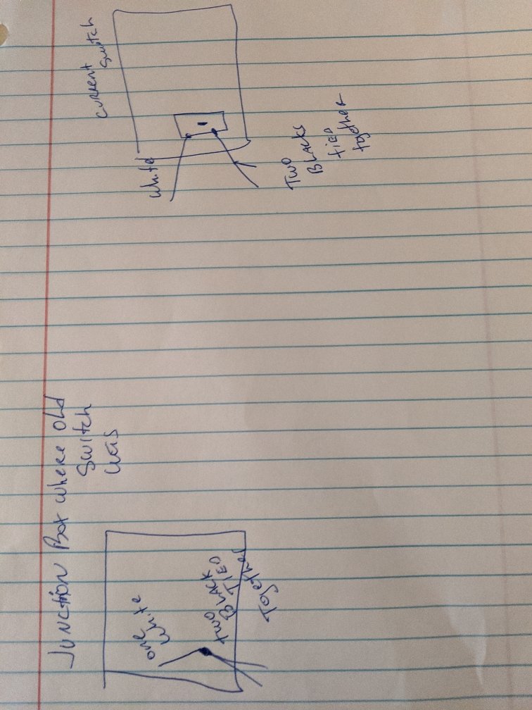

I have an issue I need help with. The exterior lights on my garage are operated with a switch in the house or a switch in the garage. I want to get rid of the switch in the garage. I have already disconnected it. How do I hook the wires that I disconnected from the switch back together so the light still operates with the switch in the house?

Did this...and now the garage lights stay on whether switch is on or off

How many wires are going to the light? Is it a white and a black? And is the main circuit coming from the house switch, or from the garage switch?
@MOUNT can you take a picture of the inside of the junction box instead?
One of the black wires will be the actual power wire, then the black/white combo is likely the travelers. You just need one hot wire going to the switch you aren’t deleting, on the line side of a 1-way switch. Then the light’s hot wire on the old side of the switch. Your lights neutral will have a white wire - don’t confuse it with the white traveler wire
Long of the short - you need to delete the first switch and traveler wire, to the point where the “new” switch box just has a hot and neutral going to them.
Also - disconnect all the black wires going to the first switch. When its disconnected then you’ll be able to test which black wire has line voltage. Once you identify line voltage, work from there.

this is the key. You really need to know which of the two switches is receiving the power. Basically is it powered from the housed and an extra switch at teh garage, or is it powered from garage and extra switch at the house.
So if I unhook the switch at the house and I still have power at the light then it's powered at the garage...and vice versa?
Sent from my Pixel 3 XL using Tapatalk
Correct. Does your garage have a separate meter? If not, the circuit probably originated from the house side.
Yes my garage does have a separate meter. Only problem with that is I shut off the main breaker for the garage and still had power to my lights
That means the lights are powered from the house. If your garage voltage is zero and the lights are still on, circuit likely comes from the house
I have determined that the light is powered from the house. Problem is now that the light works whether the switch is in the on or off position.
Thanks for all of your help guys. I now have the lights functioning properly from a single switch inside the house. Actually got them done early yesterday morning, I just forgot to post up and thank everybody.
