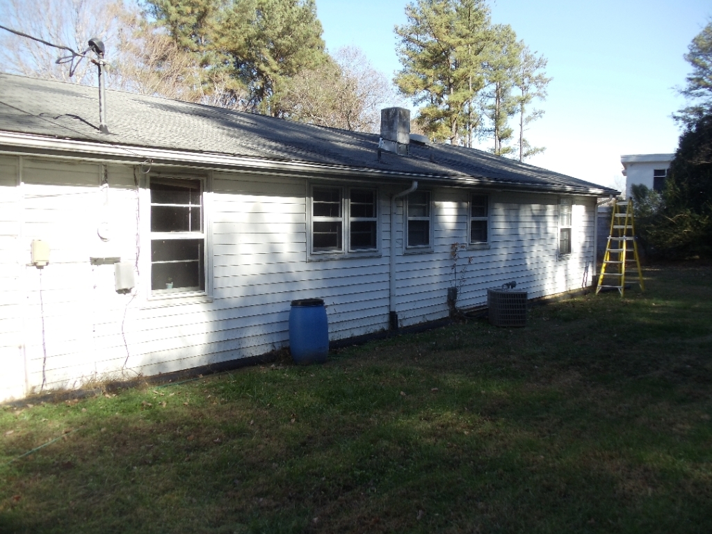

Mind you, my house was built in '60 but local building codes then did not require insulation in the walls, but this is what I have done to each wall over the last few years to really fix things up:
Before and after:

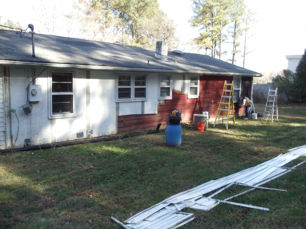

Plywood over lap-board and tar-paper:
ai233.photobucket.com_albums_ee179_trustonlyme_House_20Project6dfe6e3d2f3e7819c69fd78e2d90ff68.jpg

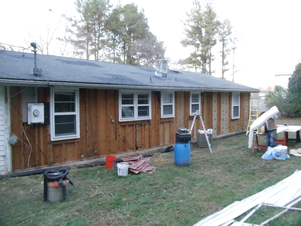

Empty wall cavities being stuffed with R-13:
ai233.photobucket.com_albums_ee179_trustonlyme_House_20Projectad7ba79ead991d3c62337ea4dab24015.jpg

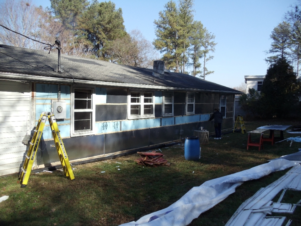

Radiant poly over Styrofoam:
ai233.photobucket.com_albums_ee179_trustonlyme_House_20Project869d51012a26b99051f6d3e97dfa99e7.jpg

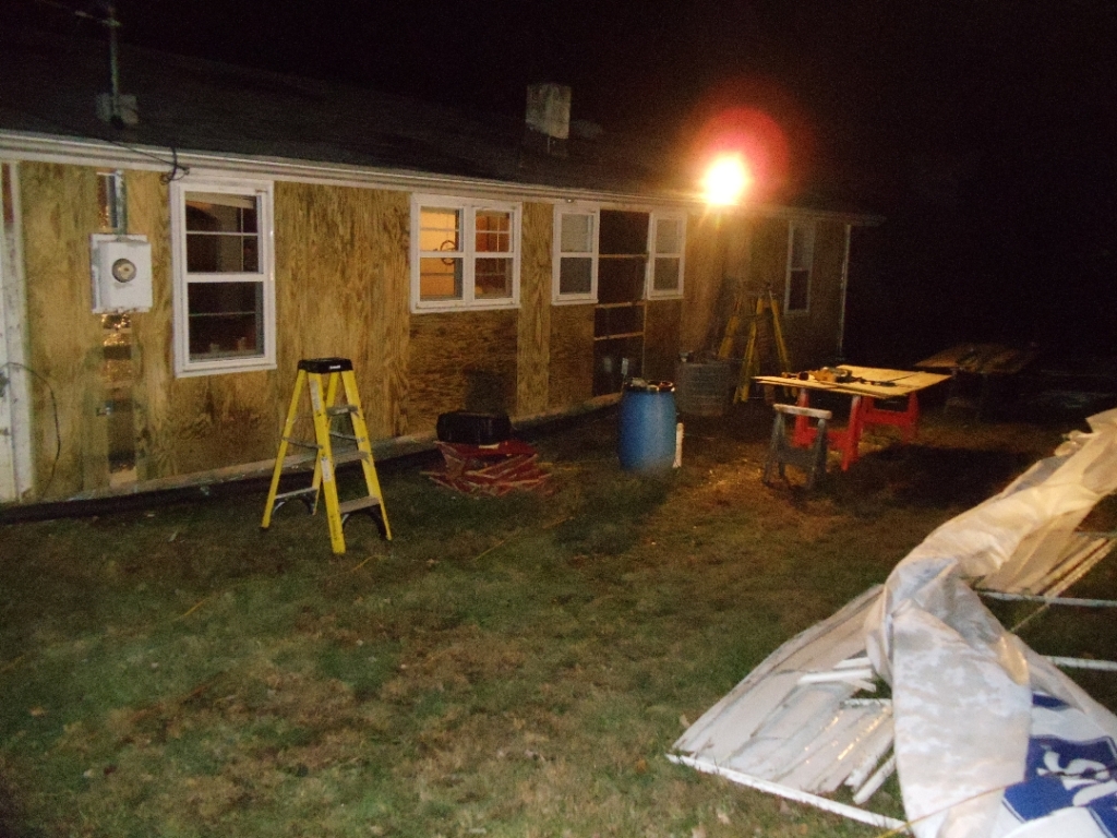

New 1/2 PT, then caulked at all seams:

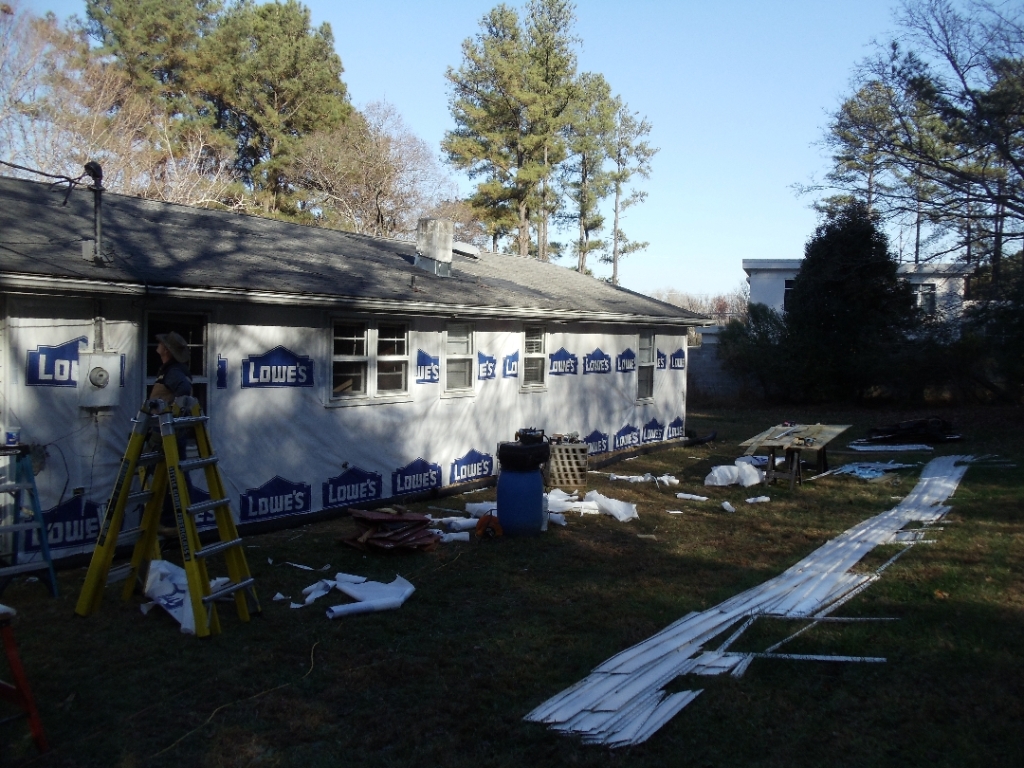

Vapor barrier:
ai233.photobucket.com_albums_ee179_trustonlyme_House_20Project69f7121e70d2d34a167ee7807e806721.jpg
