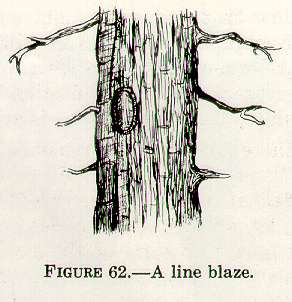

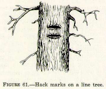

Use your phone to get close to the corners and then look for 3 chops on tree trunks, the 3 chops/hatches are facing the corner. A good surveyor would hatch the trees along the lines now and then to make a lasting marker of where the line is out in big woods. 2 hatches show the line passes on that side of the hatched tree and trees flagged along the line have the knot facing the line like the hatches. A tree w 2 knots in the flagging on opposite sides is on the line. Find a few hatches on either side of the line and you can sometimes get within a foot or less by flagging the trees or putting a few flagged stakes at the trees and looking down the line/adjusting them and looking again etc. A blaze is an oval cut on both sides of the tree showing it is on the property line. You may find 2 or more trees w 3 chops at the corners and all of the chops should face the corner helping anyone to find them. The ideal corner marking would be 3 trees in a triangle w all the hatches facing the center of the triangle and the corner near the center. The chisel marks on the rocks may be painted, or not and may be a cross or a triangle w a hole in the middle or a V or L w the lines pointing down the 2 lines from that corner. Also look for survey flagging still on trees or on the ground that might help you find the corners, that shit will last a long time. Old hatches sometimes just look like 2 faint, thin horizontal lines in the bark of some trees and if you find any kind of hatches you'll probably find more as you go along the line looking for them. Also the " ...20" inch Oak " should have 3 chops on 2 or 3 sides if it IS the corner, only 3 chops on one side and it is probably a witness w chops facing the iron or rock that is the corner.
^Good info there. Some of the flags are still hanging on my property from where it was surveyed in the early 2000's, but a lot of the color is gone from them, so you have to know where to look. If I were smart, I'd put some new ones out before they are gone, but I'm not that smart.
