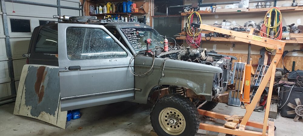

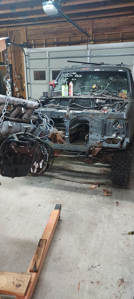

After years without a functioning 4x4, the need to clean up some of the junk around my parents place, the want of something to drive through the woods, and the need of a backup 4-seater, I hatched a plan to turn 3 vehicles into one.

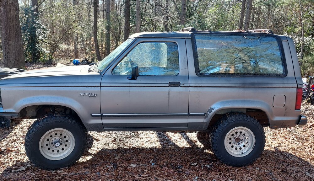

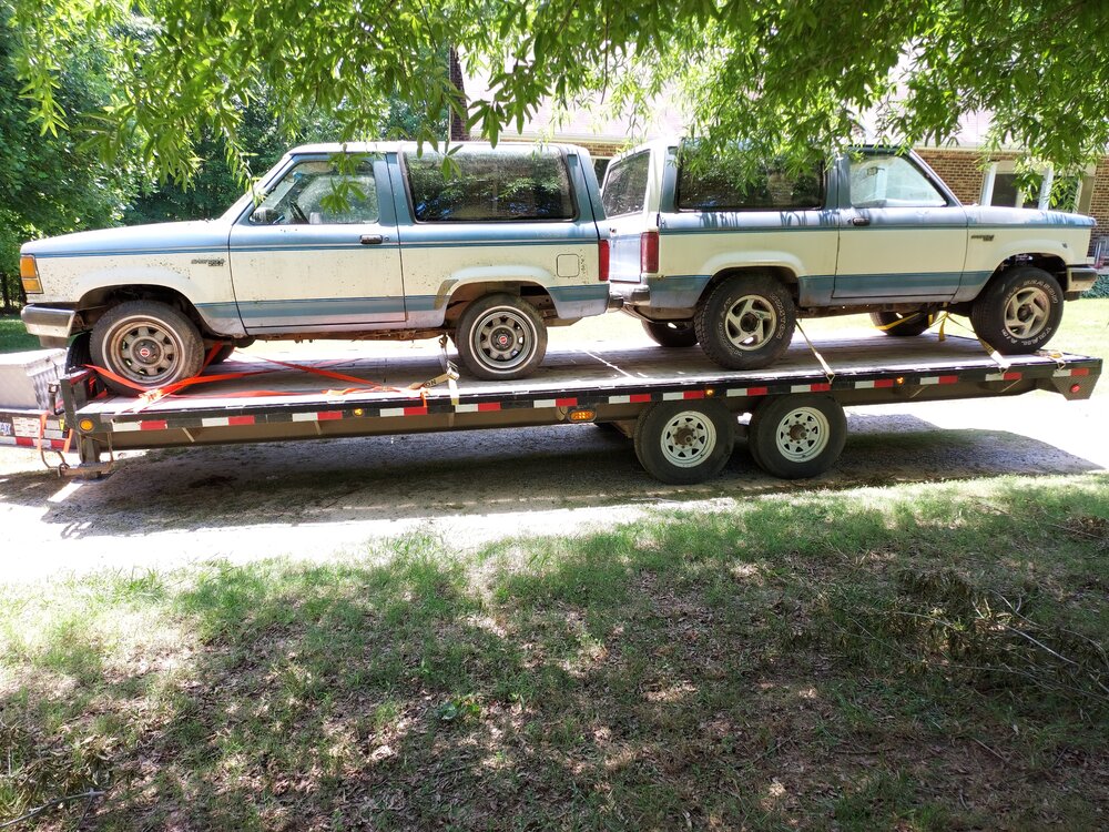

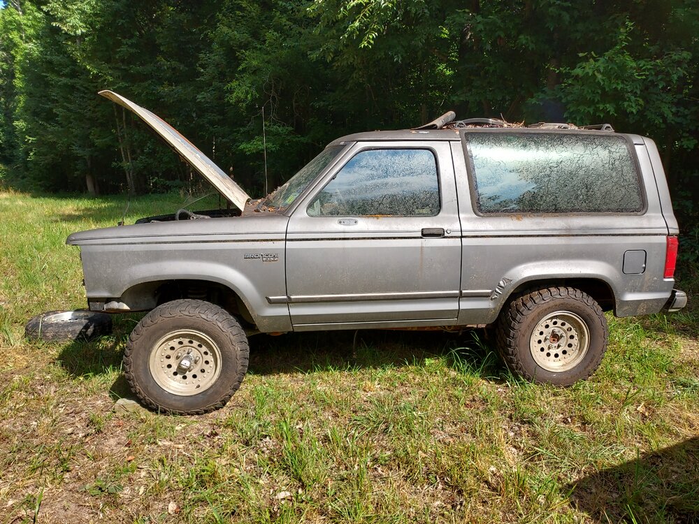

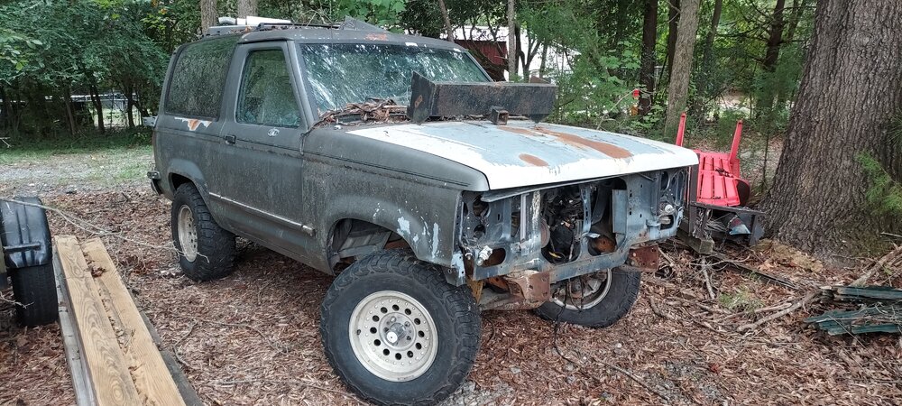

Started with this

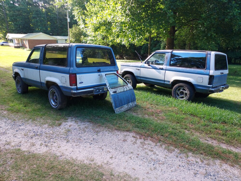

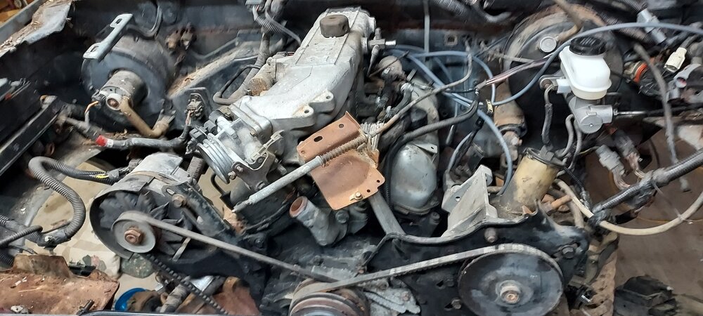

What we have here is a 1990 Ford Bronco II, that was purchased some 18 years ago as a transplant for one my brother had, that got totaled. Was bought with a bad engine, as a 4x2 vehicle. The transmission got robbed for a manual swap on another Bronco II that my brother had, and this sat. Some time later, my dad gets the idea to 4x4 swap this. We ride to Atlanta, he buys a set of mid 80's BII axles with 4.10 gears and a limited slip. I ground and drilled the rivets for the pivot bracket, bolted the 4x4 bracket in, and we installed the axles. Back in the woods it went. We pondered doing a 4.0 conversion, but that never took much traction as my dad was concerned with the wiring differences. So this sat hidden in the woods for over a decade.
That takes us to about 10 months ago, when I decided to buy this from dad, strip my old green explorer for the transmission and t-case, strip his former daily driver BII for the motor, and get rid of 2 carcasses, and have a running 4x4 again. So I promptly worked out time with my dad to commandeer their garage, since I don't have one of my own, to start making things happen. I stripped what I wanted from the explorer, and promptly junked it. Pulled the engine and a few pieces from his old daily, and promptly sold it (what a dumbest move) along with another long abandoned project.
The gentleman drove from Canada, somewhere above Minnesota, and back in one day for these. Pulling this load with an 06 ish F150 šŸ˜³.
I had some tires mounted up (as seen in the first pic already installed), put them on it, and we drug it from its hiding spot, to a temporary home.
And that's where it sat for a few months until this past Sunday, when I managed to get myself some more garage time, and set to work.
Around 3 am Thursday morning, I'm a day behind from parts not showing up on time (thanks DHL) and just normal life with two homeschooled sub 10yr old boys, I pull the junk engine that's been sitting on the mounts for the last God only knows how long.

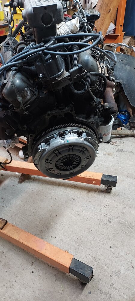

I mounted up my turned 4.0 flywheel and new 4.0 clutch.
And swung that thing into place...

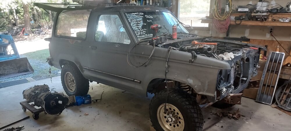

If you know anything about these, you know that isn't a 4.0 I'm putting in, but I have said "4.0 flywheel". That's because I have to use the 4.0 flywheel, clutch, and starter to be able to use the Explorer M5OD manual 5 speed in this thing. Which also means chaging out the starter wiring/battery cables to the 4.0 wiring.
After daylight hit, I cranked the tractor up, and headed to the shed for the transmission and transfer case. Set them off in the floor, and pondered my life's choices.
I got the transmission in, got the clutch hydraulics hooked up (damn new parts that don't fit they way they should), and that was it for now. I left semi defeated, and half ready to sell it due to finding out that my previous belief of all 4x2 Bronco II's using 4x4 transmissions and dummy transfer cases (its a real thing), some had true 4x2 transmissions (we thought the transmission in this one had been swapped in from a Ranger when we pulled it out) and therfore the speedo cable was about 12 inches too short.
Friday rolled around, I woke up 3 hrs late, and set about trying to make fuel lines (another model year change, no parts available snafu), found out I needed and hadn't ordered a clutch interlock switch, went to the junkyard for a replacement clutch fluid reservoir (original one stolen with the master and clutch switch to do the aforementioned manual swap) and generally spent the day defeated. I did manage to get the front brake lines loose, mount a new drivers caliper and line, and then have to leave having accomplished almost nothing, because it was a work night for me.

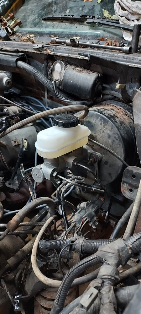

Found out the brake master cylinder was bad, broke the parking brake release handle trying to unstuck the parking brake, broke the welded nut off the body while removing the parking brake assembly, removed the fender to access the broken nut, the clutch pedal which is attached to a long bar that holds the brake pedal in, was sticking in the brake pedal, so bleeding the clutch was interesting at first.
Liberal application of lubricant and the clutch pedal finally started rebounding, got the clutch bled, go the parking brake assembly out and freed up, now I just need to get the release handle welded back together so I can put that back in. Then it's a waiting game for parking brake cable coming from Boston. Then hopefully šŸ¤žI'll be ready to start making vroom vroom noises.
Got in from work Monday, and slept the whole day, planned to be at the house by 2 on Tuesday, got there at like 6, so I'm right on track with my schedule here.
Got the new brake master bench bled and installed, no one was home so bleeding on the vehicle had to wait, plus I haven't put the rear together yet.

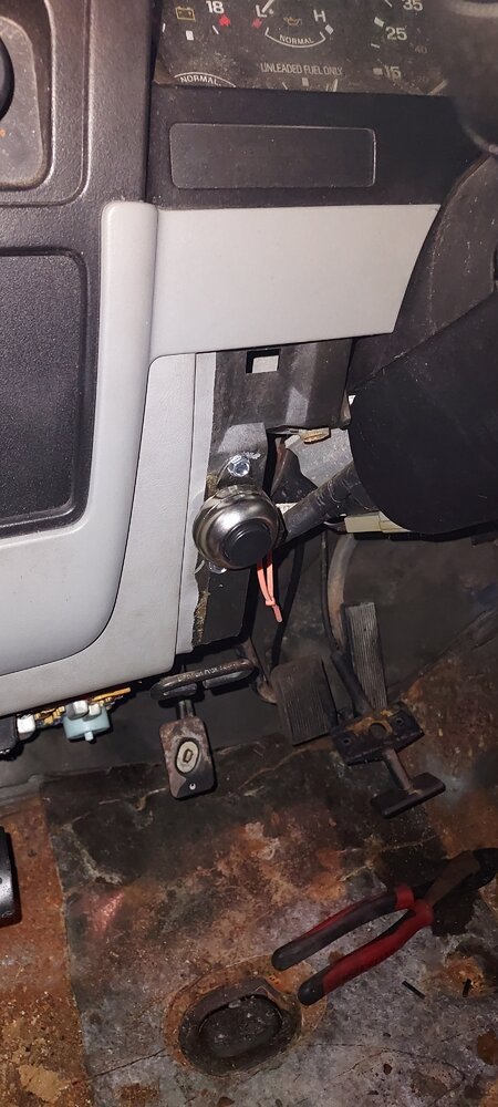

Mounted a bypass switch for the clutch switch. Funds are a little short at the moment, so the factory switch has to wait.

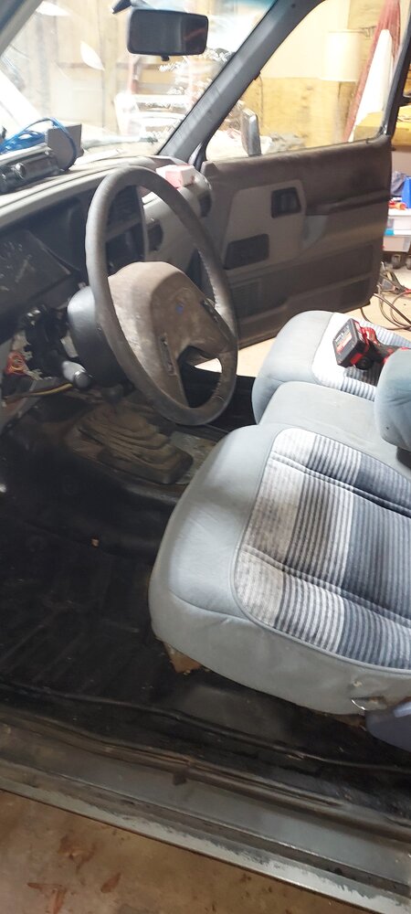

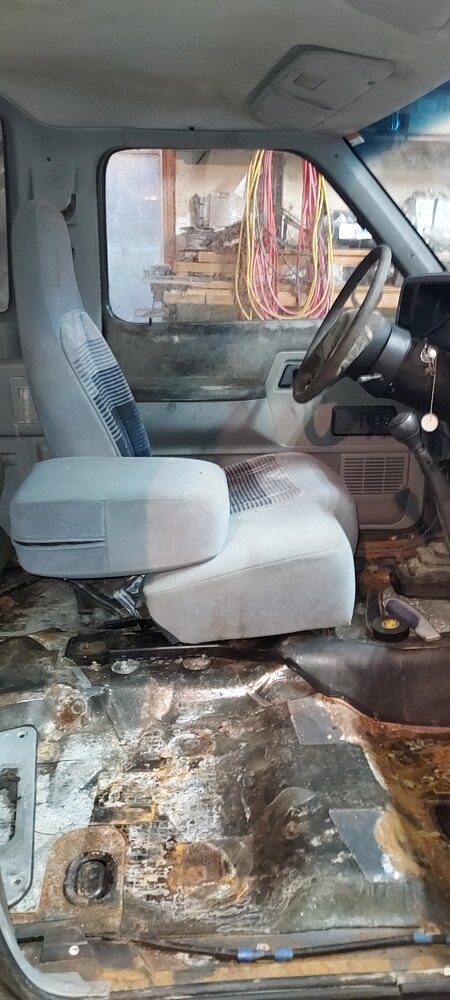

Half bolted the new drivers seat in. Ditching the buckets for split bench.
It's gonna have to come back out so I can drill/burn the broken/rusted seat bolts out. I'm also gonna wire wheel the rust as best I can, clean it up, prime it, and either undercoat or bedline it. The raptor stuff looks pretty good and it comes in colors.

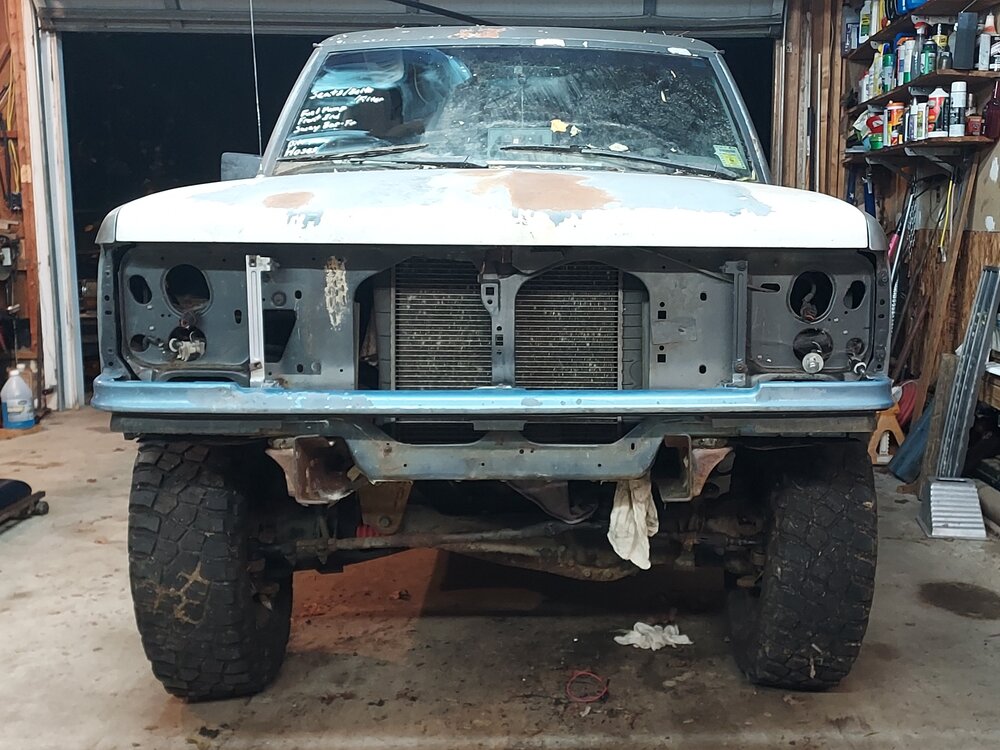

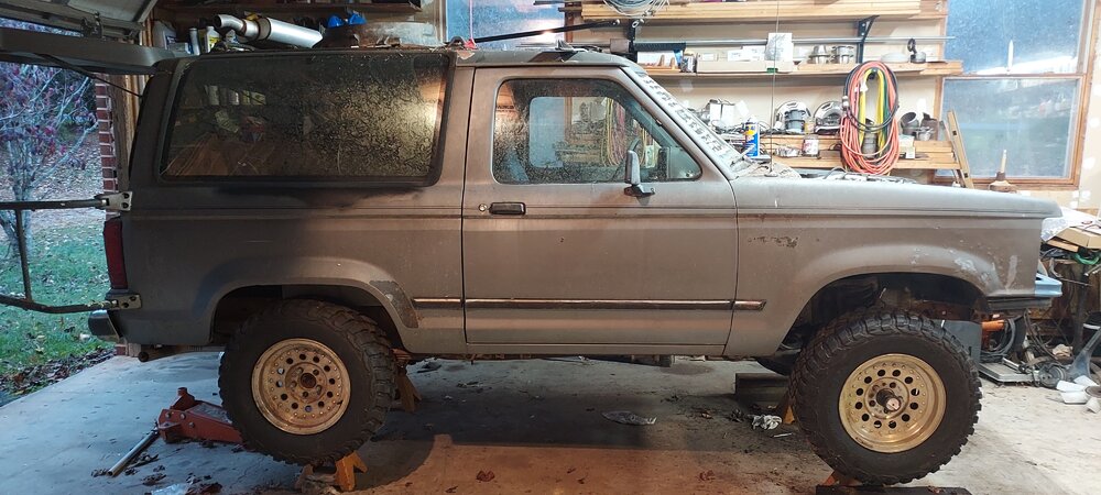

I put the tires on it then set it on the ground.

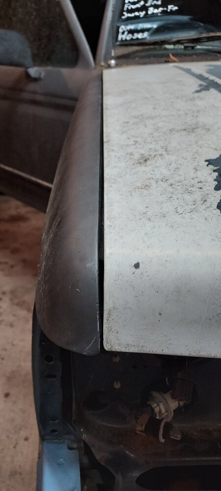

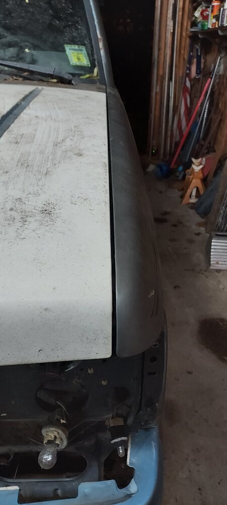

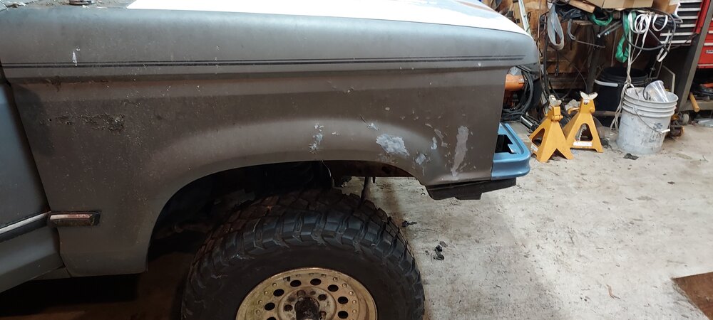

Put the hood on it, which was a PITA by myself. Got it and the fenders lined up best I could, but I'm no body man.
Yes I know the fender gap to the core support is off, but the core support is pushed towards the driver's side, as can be seen by the gaps at the frame. The passenger side fender is a little twisted at the top from a deer hit before Dad bought it. Fender was mangled, dad was gonna trash it, but as a headstrong youth/teen thought I was an aspiring body man, and banged it out with a ball peen and a block of 2x4. Got it good enough dad decided to keep it.
The filler panel was not salvageable, so I mounted the one from the same Bronco the hood came from, which actually donated its engine and transmission to the Bronco that I pulled it from for this is. I was also the one that pulled those parts after my brother got hit, and then swapped them into dad's Bronco. So this makes the 3rd Bronco for this engine, and the 2nd time I've put it in a new home. But I digress.
With the hood and filler panel, this actually makes a 4 vehicle combination, well 5 if you consider the axles are from one we never had, but 4 of ours anyway. I've spent the last 25 years working on Rangers, broncos, and explorers. This is the last of the litter, and the last of the vehicles my dad taught me to work on.

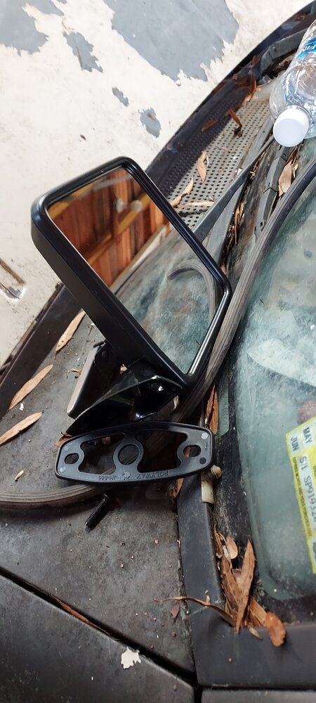

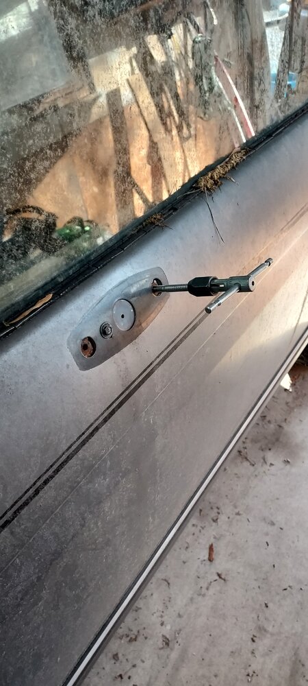

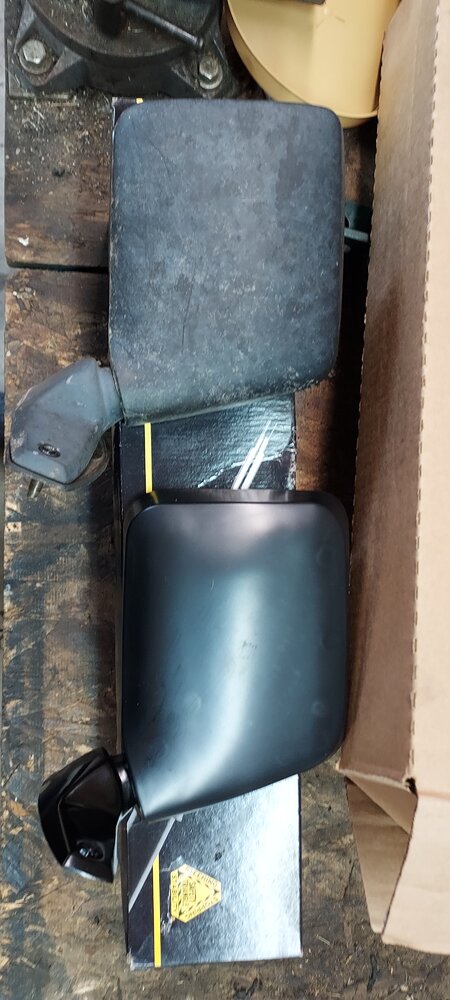

LMC had new mirrors for $10 each, got em both shipped for little more than one used, and given the flaccid nature of these mirrors, I definitely made the right choice.
Learned my lesson from the front yoke fiasco, and cleaned the threads up BEFORE I broke something.
New mirrors came with the new gaskets and new bolts, which thankfully weren't the itty-bitty torx that always strips out.
Old vs New

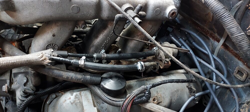

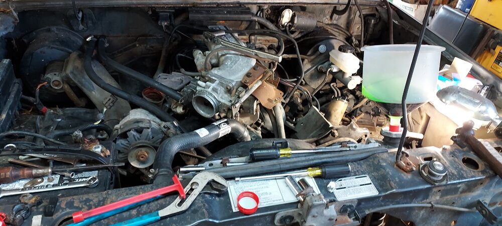

Well after I got those on, back to the cooling system. Put the hose back on, and used my fancy funnel to fill it back up.
Don't be jealous, I used to be a cool guy. I pressurized it again, had to tighten the bottom hose, and no more leaks. One thing down, 3,977,492,874 more to go.
As you can see, I still don't have everything back under the hood, haven't solid mounted the fender liners yet, and I still have some under the hood things to figure out, but I'm getting there.

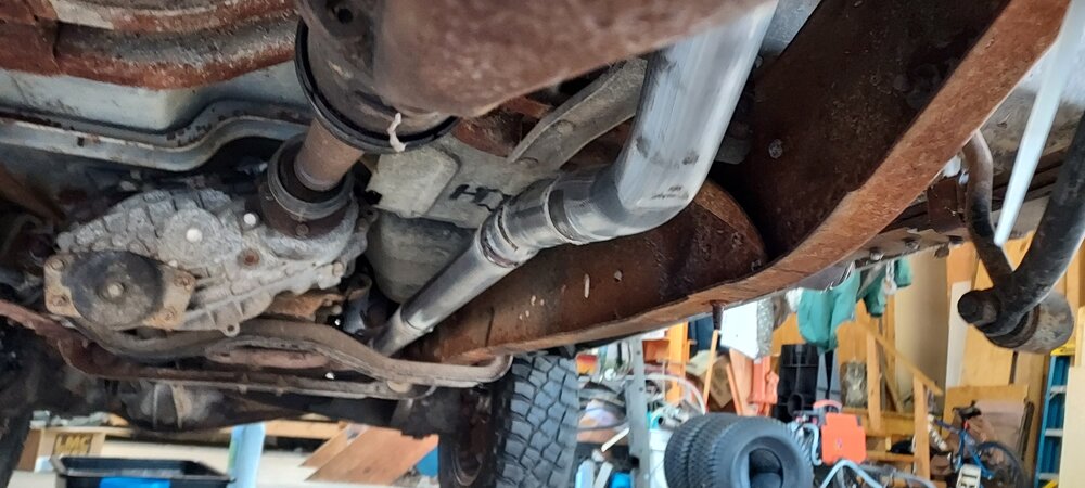

Well after I for the driver's side one in, it was time to fit the exhaust. Since I had nothing but a y-pipe and tailpipe to work with, I made the rest up.
It's straight piped for now, till I figure out what muffler I want to use. This isn't even finish welded for that very reason, it's temporary.

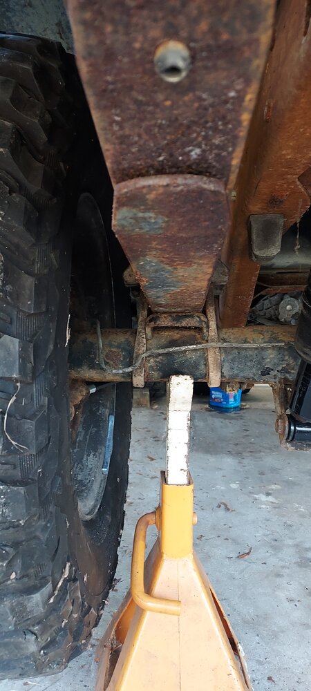

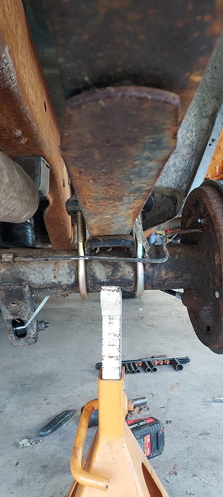

Then I remembered something I've been forgetting for months, u bolts. This is hat I have.
Which is a little hard to tell in the picture, but the springs for the 1990 aren't as wide as the perches on the 1986-ish axle, and being the young dumb kid I was 20 years ago, I just torqued them bitches down. Now as an adult, with better knowledge, training, and 2 kids to tote around, the prospect of snapping ubolts does not appeal to me. I broke out the plasma that my dad gifted me, modified the plates a little, and bought some new ubolts from the O O O O'Reilly.
Torqued them to the specs in the paperwork, and one side is good.

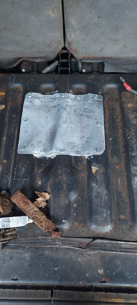

I did leave one thing out, I made a temporary fuel pump access cover, yes I cut a hole in the floor because I'm lazy and dint feel like having fuel filler issues since they aren't made anymore, but I'd like to get a rivnut set and make a true fit removable cover with round head screws instead of the self-tappers I used to zip the temp one in. Anyone have a decent kit they'd recommend? Doesn't need to be big, or "professional grade", just a decent hobby set with the typical small sizes.
Update with a picture for the fuel pump cover.

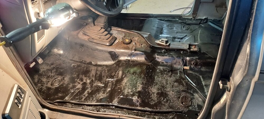

Man I really suck at updating this. But a few things happened this last weekend. I got.my other ubolts done, still haven't put the front shocks on, still haven't put the front sway bar on (or even removed it from the parts explorer for that matter). I DID fix the heater issue, which was a frozen cable, and then my fix broke, but not the 15 times I worked it with it out, no, the very first tim. After I put it back in and reassembled the dash.....:flipoff:

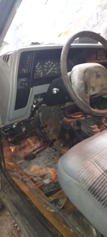

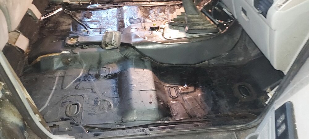

So then I removed the broken seat bolts and did the ole Craigslist rebuild on the floorboards...
I love this stuff right here.
So a 'shhh shh' here and a 'shhhhhhhhhhh shhh sh' there and a coat of krylon later it looked a whole lot more presentable.
Then I bolted the driver's seat in for what I hope is the last time, then bolted the passenger seat in for the first-last time.
