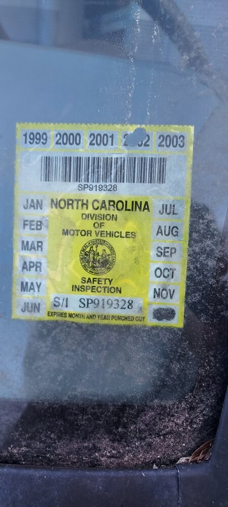

That's the old inspection sticker on the windshield. Seeing as how it would have been inspected last in 2001, and the sticker less thing didn't start until 2006/7, I'll assume sometime in 2002 is the last time this was on the road, and when we got it, the motor was already apart for blown head gaskets, so we've had it less than 20 years. I guess my mind is starting to go 🤪.
