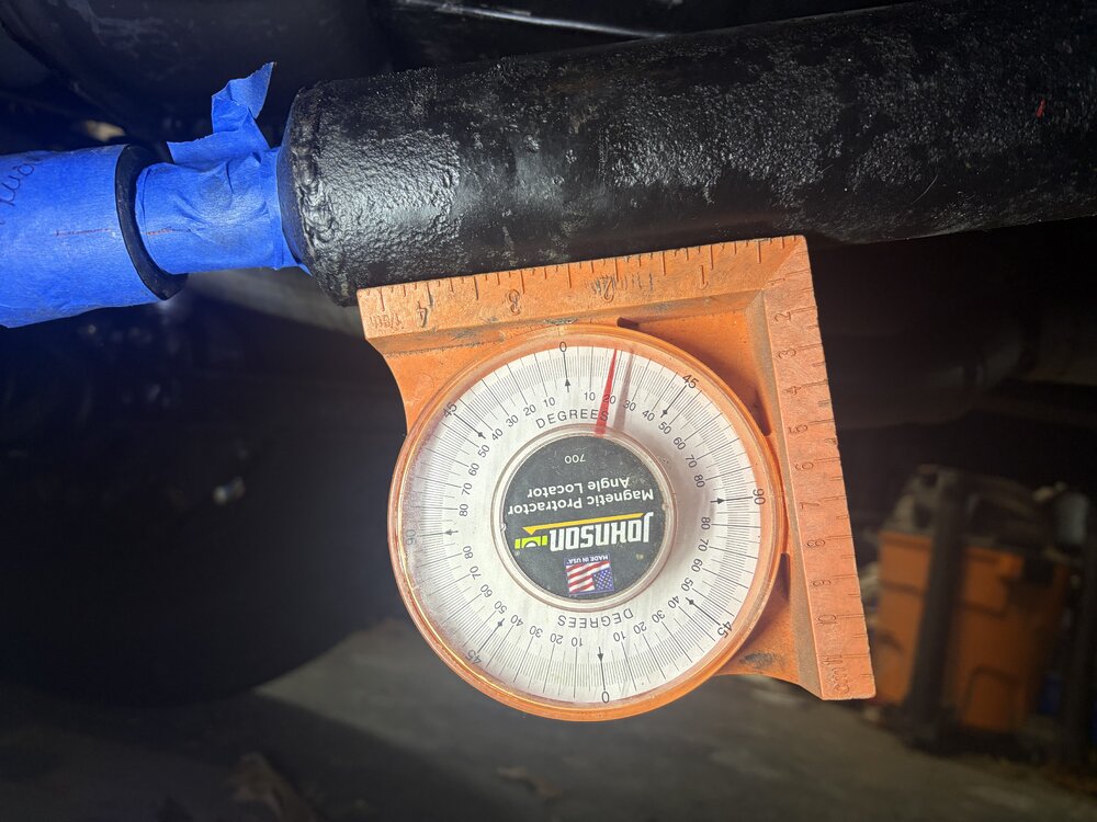

Bad axle u-joint?
There should not be any angle at the pinion if you're running a double cardan CV shaft. This will cause rhythmic vibrations and clattering/noise.
Sort of..
Thanks to all for the input, ideas and suggestions. Your help had me looking at everything helping me to eventually find what appears to be the problem!
