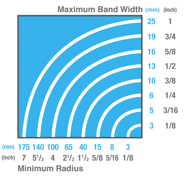

My bandsaw has run these and standard. Found with a wide variety of thickness I would rip a few teeth out of these. Starting to decide on a cold cut or chop saw for my thinner stocks and a dedicated tooth for the thicker stuff. I have leaned to a denser pattern to get better life but like you said chip load causes issues. Feed and break in make huge differences in life.
The radius chart is pretty neat.
