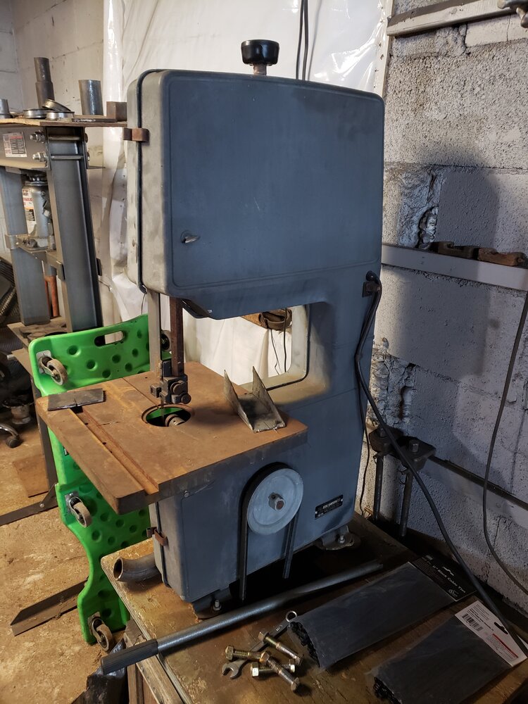

I'm not sure of any true metal cutting bandsaw that is fixed speed.oh I didn't know this one i have is designed for wood lol. thanks for the heads up
I'm pretty much clueless in all this bandsaw tools and stuff, I wanted a drill press and the old guy said take all 3 for this price and said good deal. The horizontal one finally gets used enough to pay for itself the last 4months or so ever since I bought a worthy blade for it hahaI'm not sure of any true metal cutting bandsaw that is fixed speed.

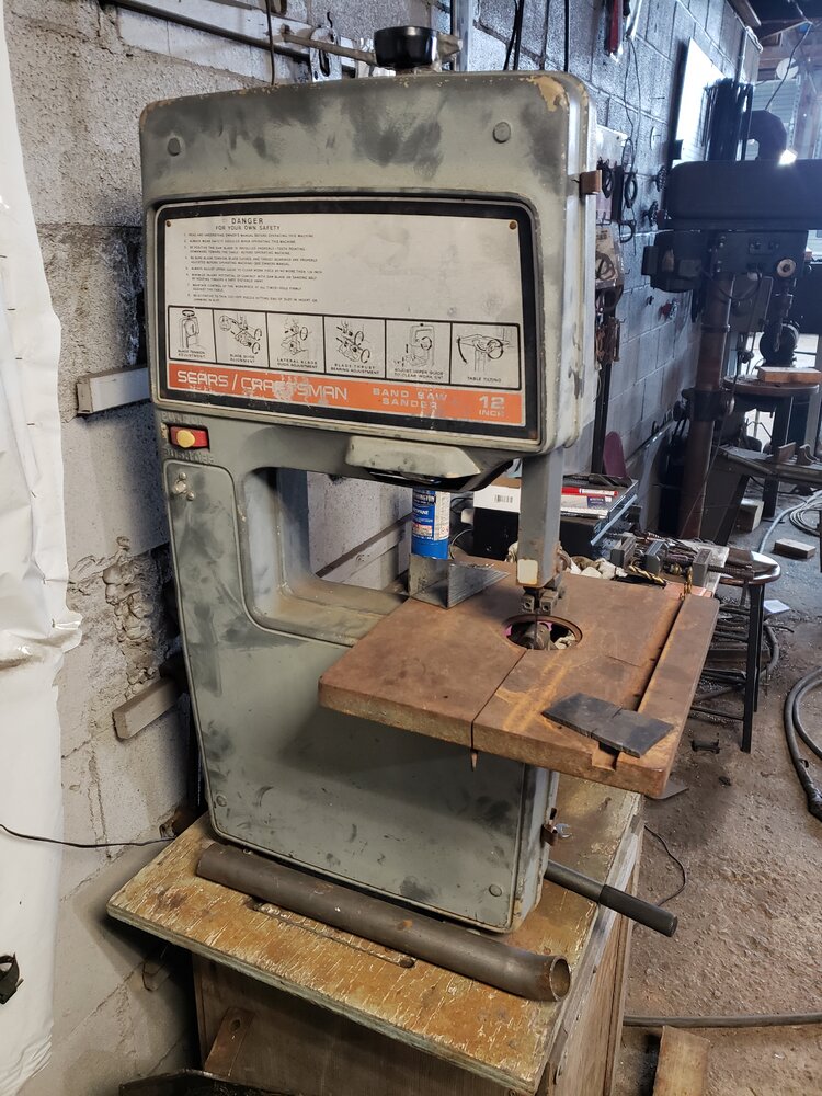

I wouldn't know this if I wanted to lolIf you found that it runs too fast and burns up blades, you could always step the pulley size to make it run slower.
That's what I did with my old Crapsman. Something like a 1.5" diameter pulley on the motor made it a little on the fast side for steel, but it cut great.If you found that it runs too fast and burns up blades, you could always step the pulley size to make it run slower.
So don't bother trying an expensive blade until I change pulley?If it is a bandsaw designed for cutting wood then it will be definitely too fast for cutting metal. You will have to slow it down.
Basically. What are your pulley diameters and what is the rpm rating on the motor?So don't bother trying an expensive blade until I change pulley?
Well, it depends. Smaller pulley on the motor. Bigger pulley on the lower wheel drive.Bigger the pulley the slower it turns right?
I'll check this weekendBasically. What are your pulley diameters and what is the rpm rating on the motor?
