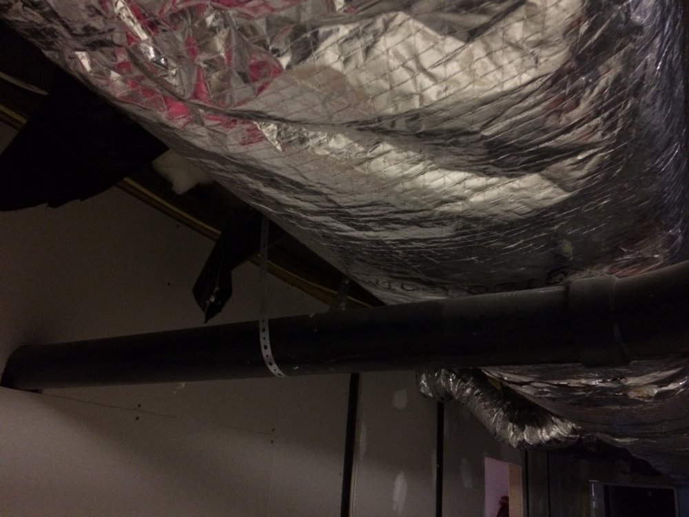

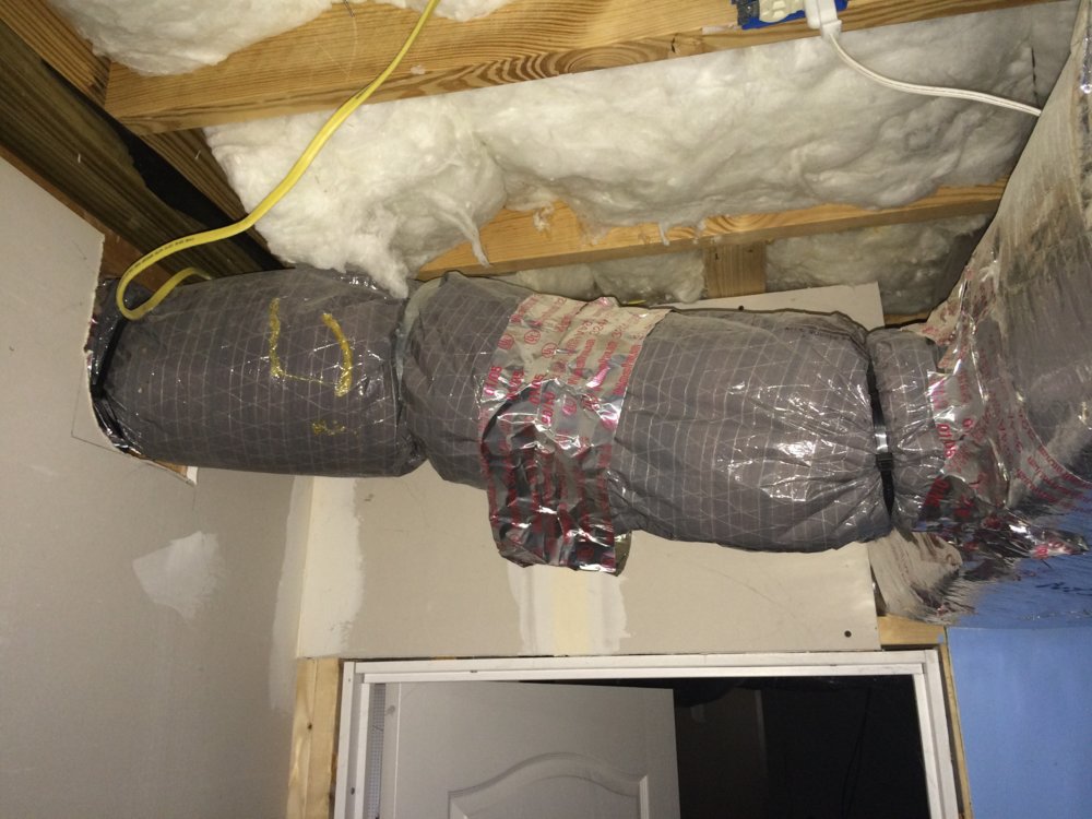

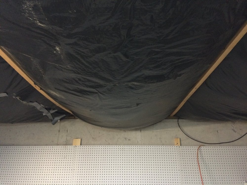

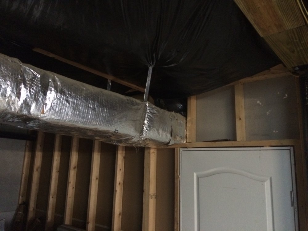

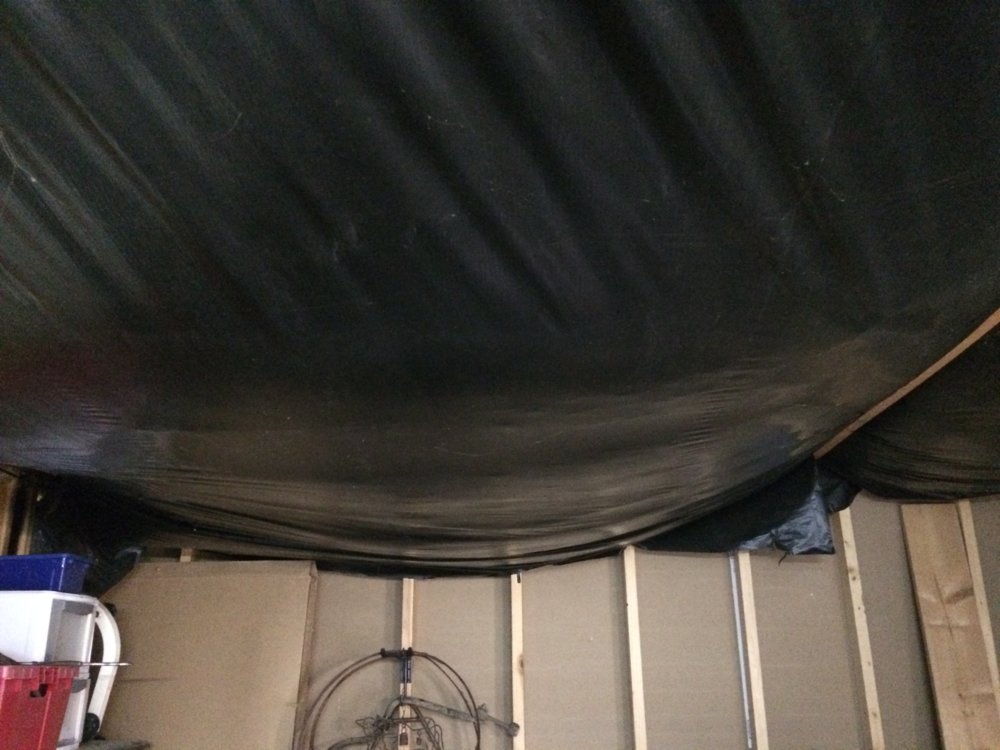

I'm reworking my shop in my basement it's where most my drinking and sittin on here goes down... Anywho po had some shitty insulation work done by a "friend" he said wondering what you smart folks suggest I can do to fix this mess or if I need to tear it down and start over? I'm assuming it's not as simple as just throwing 2x4 or furring strips up to hold the sagging parts but maybe I'm overthinking it! It's like this through my whole basement and I'm working on finishing the basement with electric plumbing and carpet a drop ceiling will probably be end verdict for ceiling cover but the insulation has me concerned bc it sags so much it looks like it'll fall eventually given time!

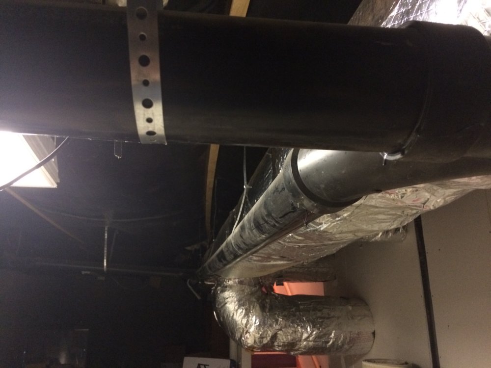

As you can see the hvac is Very low no room for drop ceiling in this state! Also plumbing is lower than hvac I'm 6'4" and my head is 1" from lowest piece of pvc, it's obviously a situation where the guy didn't have the skills or didn't wanna put forth the effort but where to start?? Insulation first but what then, reroute plumbing then hvac? I'm not a contractor have done a lot of framing and Sheetrock and basic carpentry jobs but not trying to screw my house up going into somethings without a plan!
It sucks bc everything works properly it's just done poorly and very low and I'm tall so that don't work for me! Lol
Looks like to fix the duct you'd have to rework the metal main trunk line. Doable but can be time consuming and costly and looks like maybe a couple inches of benefit, if that.
I don't see any plumbing so I can't comment on that.
Will the insulation push up flush with the bottoms of the joists? Push it up and sheet it with 3/8" plywood? Let the plumbing and HVAC stay where it is if it works fine.
Not sure all the specifics going on there, but there should be metal insulation supports holding the batts up between the floor joists.
They are 16" long 3/32" diameter metal rods.
When pushed up between floor joists they bow, and hold the insulation up.

the insulation doesn't go up very far it seems that it isn't in between floor joist just laid up on bottom of em!?
Yeah def either has fallen and he had put tarp up bc he knew it was gonna fall or po did the tarp when it started falling!
Remove insulation between the basement and the heated upstairs. Focus on the perimeter walls, your building envelope is where you want to insulate.

I agree w/ Cydney. Plan to just pull all that shit down form the ceiling and start over, do it right. You don't need it UNLESS you're using it someplace for sound dampening. Even better though all that plastic is preventing moisture moving. Makes me wonder how the humidity is.
Re: the pipes etc, look around and visualize where your walls, doors etc will be and figure how you can move them to the edges of walls. If your concerned w/ codes and height, in a basement you can have down to 6'6" protrusions etc for soffits and short bump-outs.
Just a comment on the HVAC. Looks like a mix of metal or hard board duct, & flex pipe. If your satisfied, Fine. But seems like you loosing Gobs of Flow! I may be insulated but that flex bowed & tied up, can't be moving much air.

In that case ditch the insulation above, it's doing nothing.

Unless the basement slab was put on a gravel bed w/ pipe venting, or there's a good sump pump etc, you'll always have vapor coming up through the slab.
All that plastic, if I understand it right (it covers the whole ceiling everywhere in the basement?) is going to be trapping moisture IN the basement.
Have you ever set a humidistat down there for awhile? You'd be surprised just how humid basements are.
Anyway that moisture needs a way to go somewhere, unless you're going to really seal the basement slab floor.
Personally I'd put 2" foamboard on the walls, w/ the seams taped really well, then frame in front of that. I was shocked at how much that changed the temps when I did it. That provides a vapor retarder from moisture coming through the block walls AND the insulation
