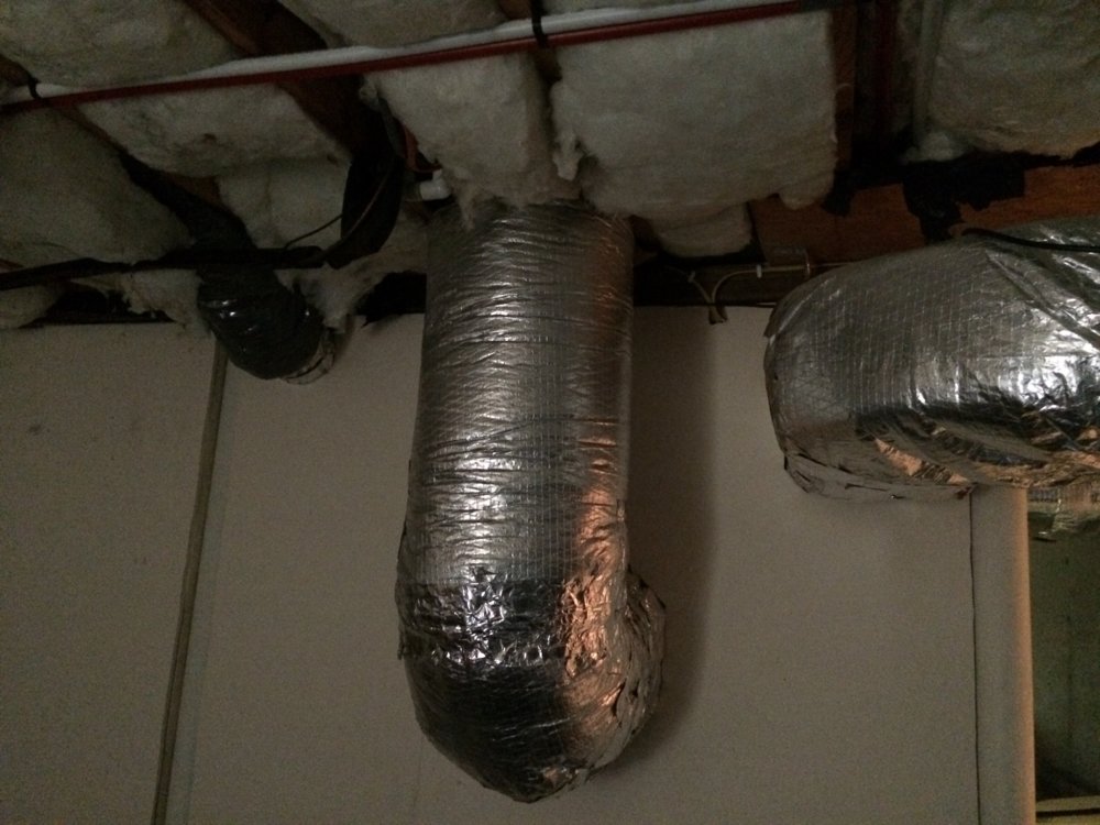

this is the "hallway"! Both sides low and hvac is directly run with doorway to shop was hoping I could just raise the main duct up then reconnect the rest I gotta look into smaller duct work for the big bend going in wall bc I can't live with that shit lol
Please don't put smaller ductwork in place if larger ductwork at the sake of conelvenience. Then you are no better than the dude that created you current issues.
No I didn't technically mean smaller I'm not positive what my options are on the huge round piece going through my wall I was assuming there were more living space friendly pieces I could use!
This is the piece I would like smaller or if I could just cut it and lift it up!? Not sure how it would affect the flow in theory it seems it would be same thing just less distance for air to travel through?

^ ok gonna start on ceiling and work my way down to walls they will probably be last after hvac and plumbing! In my hvac problem it seems like most of the duct could be lifted 7" is there a reason it's as low as it is?
One reason is the installers made it easier to connect and seal the joints if there is 7 " above the ducts while working off a ladder. Also little coordination between plumbers , electricians, and HVAC folks cause poor use of space. We are in crawlspaces alot and its crazy the way utilities are installed. There is a priority for drains. Be carefull on a/c ducts not run flex ducts at extremely sharp turns and no back to back elbows. Two smaller ducts can replace one larger duct. If the space is not conditioned 24/7 I would plan on installing a dehumidifier with permanent drain to keep things dry.
Yeah I think electric, plumbing, and hvac was all done same day so they spread out from each other as far as possible... Lol just my luck the main duct is only like 15" from where it comes out of floor from upstairs so that shouldn't be a issue it'll stay one bend to main as far as I can tell! I'm sure that'll change when I get up in there

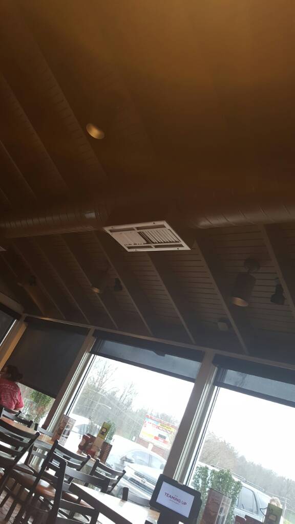

Appreciate the idea of painted joist for industrial look the woman went for it and it'll save me a huge headache bc drop ceiling is a pain by yourself to hang!!
Absolutely. Most commercial spaces are painted these days, even drop ceilings. Have her start paying more attention when you're out and shell find a color she likes.
Heres an example of a tan on the ceiling of a restaurant.
