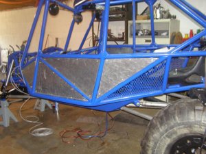

Basement wheeler...
more

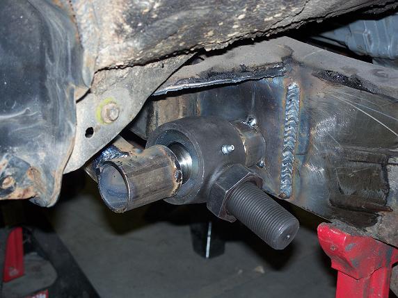

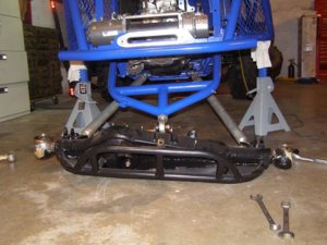

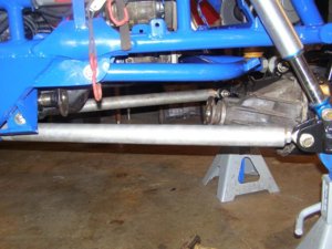

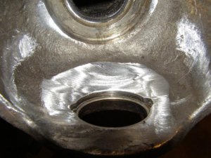

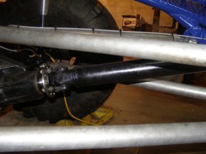

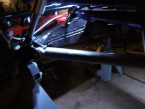

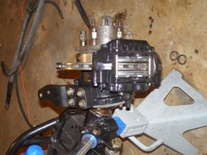

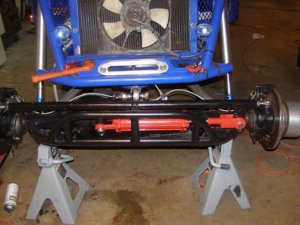

Got the front three link in, detoriot locker.

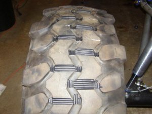

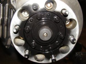

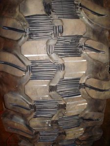

39.5 tsl's grooved up on recentered h1's. Wanting to go up tp 42 iroks or 43 sx2's on alum bead locks.
Started grooving, got a long ways to get them were I want them.

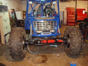

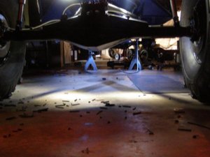

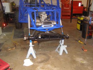

Got more done...Got the front tires on, more grooving on the rears and wiring done. Wheel base ended up being 123"

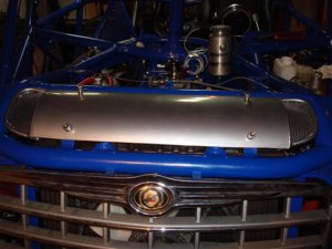

Dat ting look good, what is dat a cacalack grill or sumpin? Get done and lets test her out.....

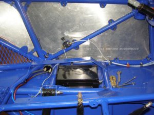

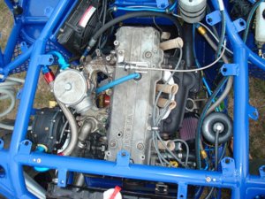

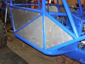

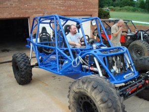

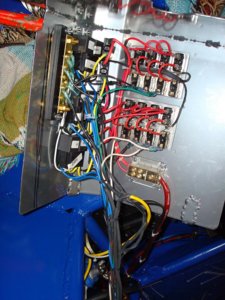

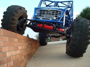

Got my hoses done.(Thanks Austin, Pirtex is the heat). They came to the house and made them on sight. Got it up and running. Here are a few poser pics. Still like wiring the winch, body panels, making the tube to go from the turbo to the mixer, and a few other small odds and ends.
