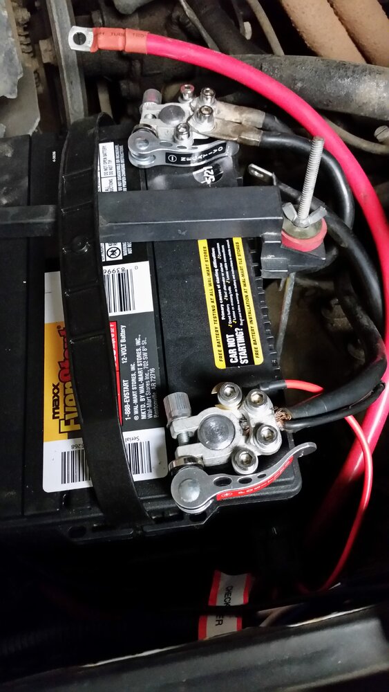

Need some big ass boots for these terminal clamps.
Any ideas? Some way to fabricate something?
I have those on my plain Jane military lugs and they barely fit. Looks like he needs some magnum dong boots to fit over those :D
This.
Need to be at least 3"xx2.5".
Like my magnum dong.

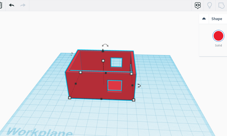

I realized I could solve this the nerd way.
Spent about 90 seconds making a CAD drawing

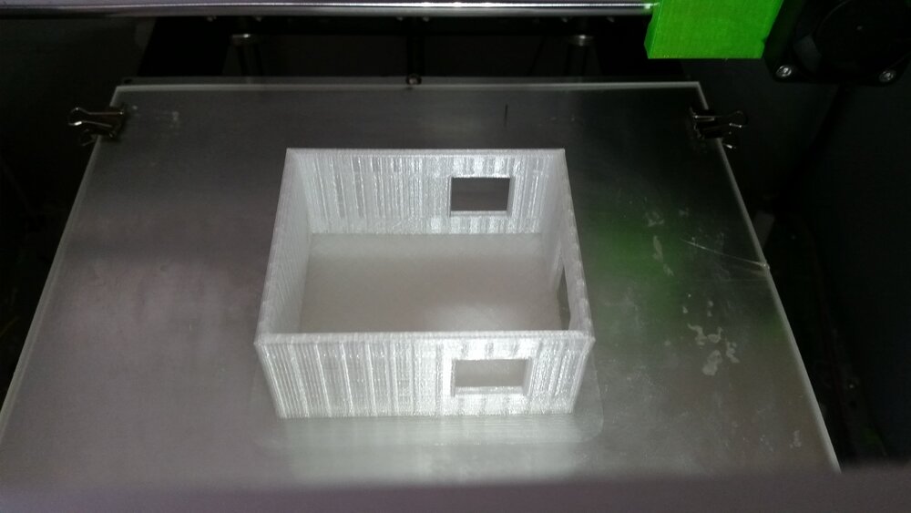

3d Printed a mockup in PLA.
didn't quite fit, adjusted
Printed final in TPU. so it's flexible, nonconductive and can take the heat.
4 hrs later I have this

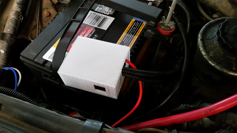

And done
It's a little loose, might add a dab of velcro to the battery to hold it in. But does the job. Plenty of room to add in more cables (the whole reason for the new battery terminal clamp)
Why not rework the spider of wires we see here and install proper terminals and power posts ?
I'm not sure what you're referring to.
The problem is there are, and always will be things that go right to the battery. Like multiple good grounds to the body, engine, etc, or winch cables. That's the whole point of these terminals, they provide a better way to connect multiple things. with a solid connection and have the convenience of the cam-lock connector (every clamp I've ever had eventually has the tightening bolts corrode and become difficult to loosen or tighten).
At the very least, I'd have 3 positive connections - 1 for the starter, 1 for the winch, and 1 for "everything else" that goes to the first fuse distro block. At the moment I have 1 extra for a set of aftermarket lights.
If you have heavy enough gauge wires it quickly becomes very difficult to use a single "normal" terminal.

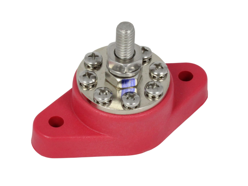

Put all those wires to a remote power post for a cleaner setup ?
I see your point... but at the moment there's only 4, and 2 of them can't be combined. All that does is move the problem to a different place..
I mean yes it makes it slightly cleaner at the battery, but adds more wire and work... and still needs a cover that I'd have to custom make.
Once I get to where I have a ton of extra connections... maybe.
But note its the cam-lock mechanism that makes the terminal unable to use a typical boot, not the lugs.

I'm less concerned about covering the ground side. In this case I did, just bc I could make a 2nd one for $0.10 and put it on in 15 seconds.
