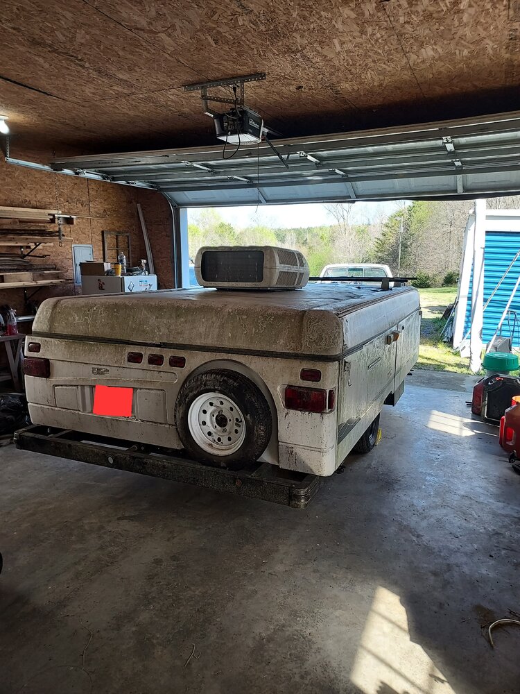

The wifeys mother and step father decided to move from their current house, and had to clear stuff out. His kids didn't want this, so it came to us.
2002ish Coleman Fleetwood Sun Valley: Price: $0.00
Issues: Many
Help needed: All of it.
It has a weird one piece ABS top, that did not weather well, which I've read is a common problem, so I need to figure that out. But a good roof means nothing if it can't be gotten into. From my current research, this lift style doesn't exist. My crank is in the bottom, which would indicate a direct drive lift system, but no. I have a chain system, which typically has the crank mid way up the tail end. Ugh.....
If anyone has any experience working on pop-up campers, please let me know, I need help.

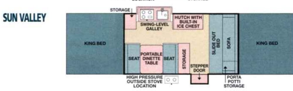

Here's the layout for the curious.

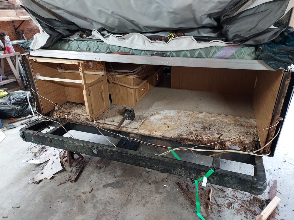

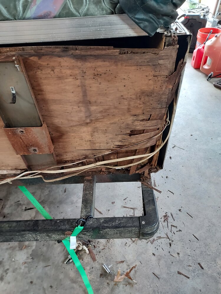

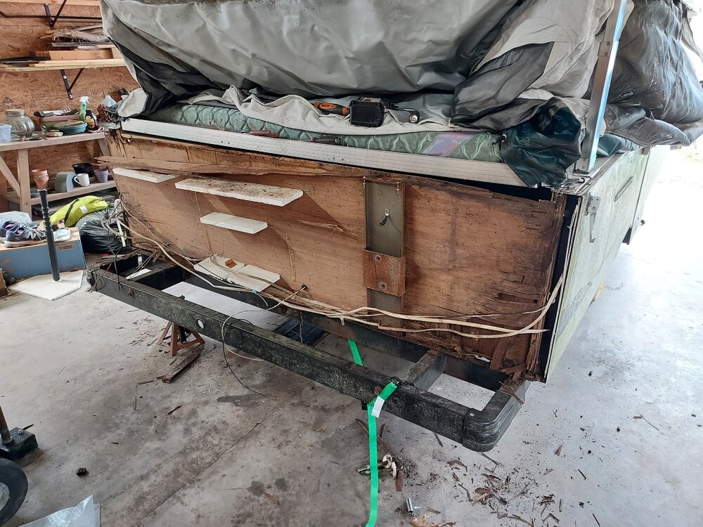

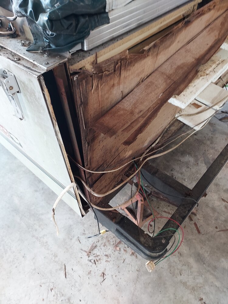

Well two pipe wrenches, and some time later, I got the top up. Removed the rear ABS cover, to find this...
The top is cracked all to shit. Gaping holes everywhere. This is where I have water damage.

I've read so much stuff to do with these roofs, it's hard to keep track of. I've got cracks on the top, the corners, the sides....I'm gonna end up having to piece it off, then either do some aluminum work, sheet metal work, or pay someone to fiberglass it. It is definitely not salvageable.

The Coleman lift is usually chain drive to the cable system ..... and this funky leadscrew type thing.
There is an aftermarket manual lift system that I would go with it it were me.
It's spring to help with the weight and I've NEVER seen on fail.
Cables break, leadscrews strip, sprockets and chains wear.
My parents had a big StarCraft with the manual system and I could handle just fine at 12 years old.
