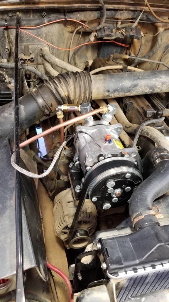

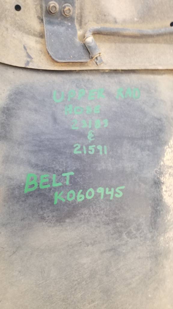

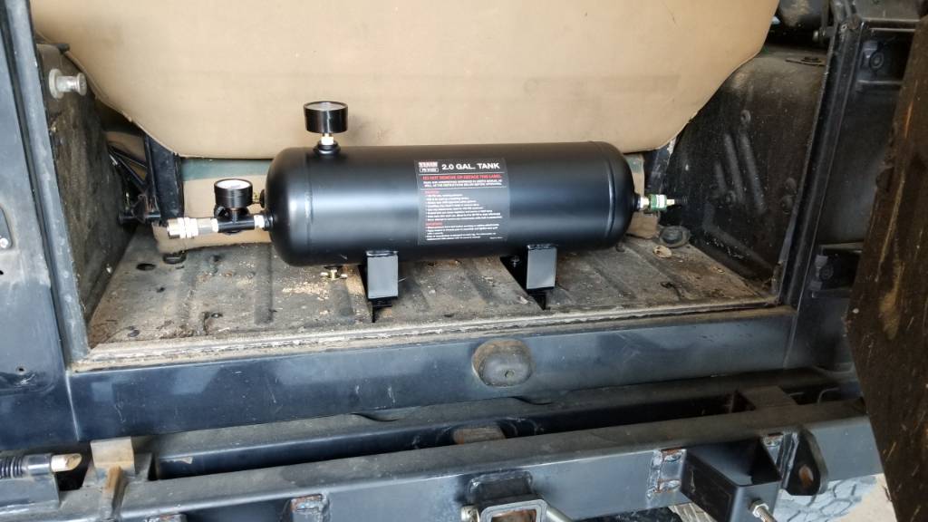

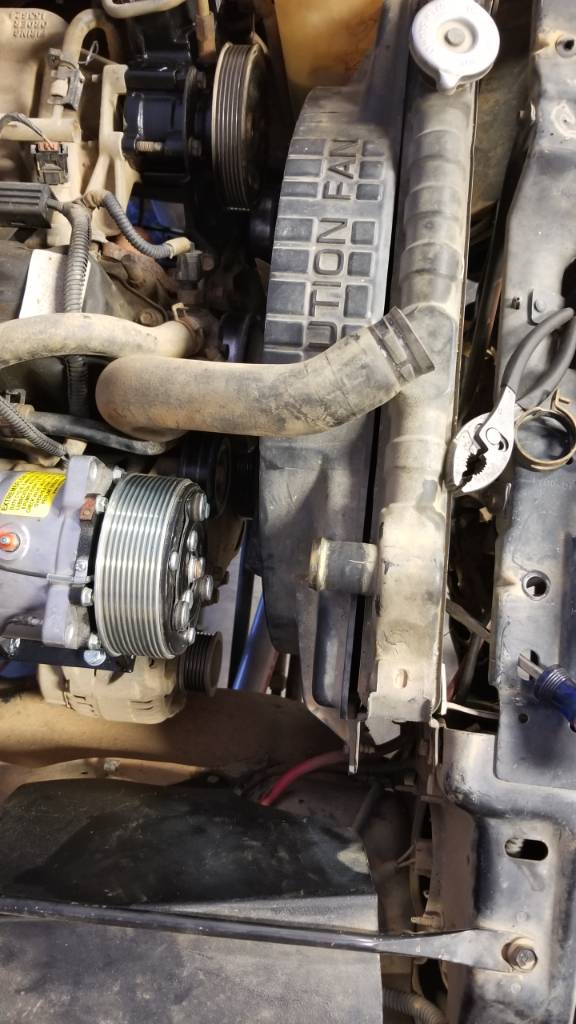

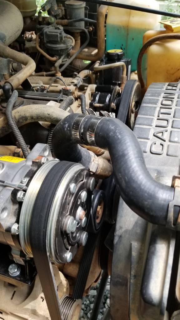

I put an Extreme Outback Products air compressor on my buddy's TJ a couple of years ago. It works fantastic. He has used it for air impact and to air up his tires.
I had to make a mounting bracket for it, modify the upper radiator hose and change the belt to a longer belt but it was well worth it.
They have all the switches, fittings & check valves you need. I just called them up and the guy on the phone walked me right thru everything I needed, placed the order right there and i had everything a week later (i was cheap and did not want to pay the expensive freight)
This is just my opinion.
Here are some of the pictures.

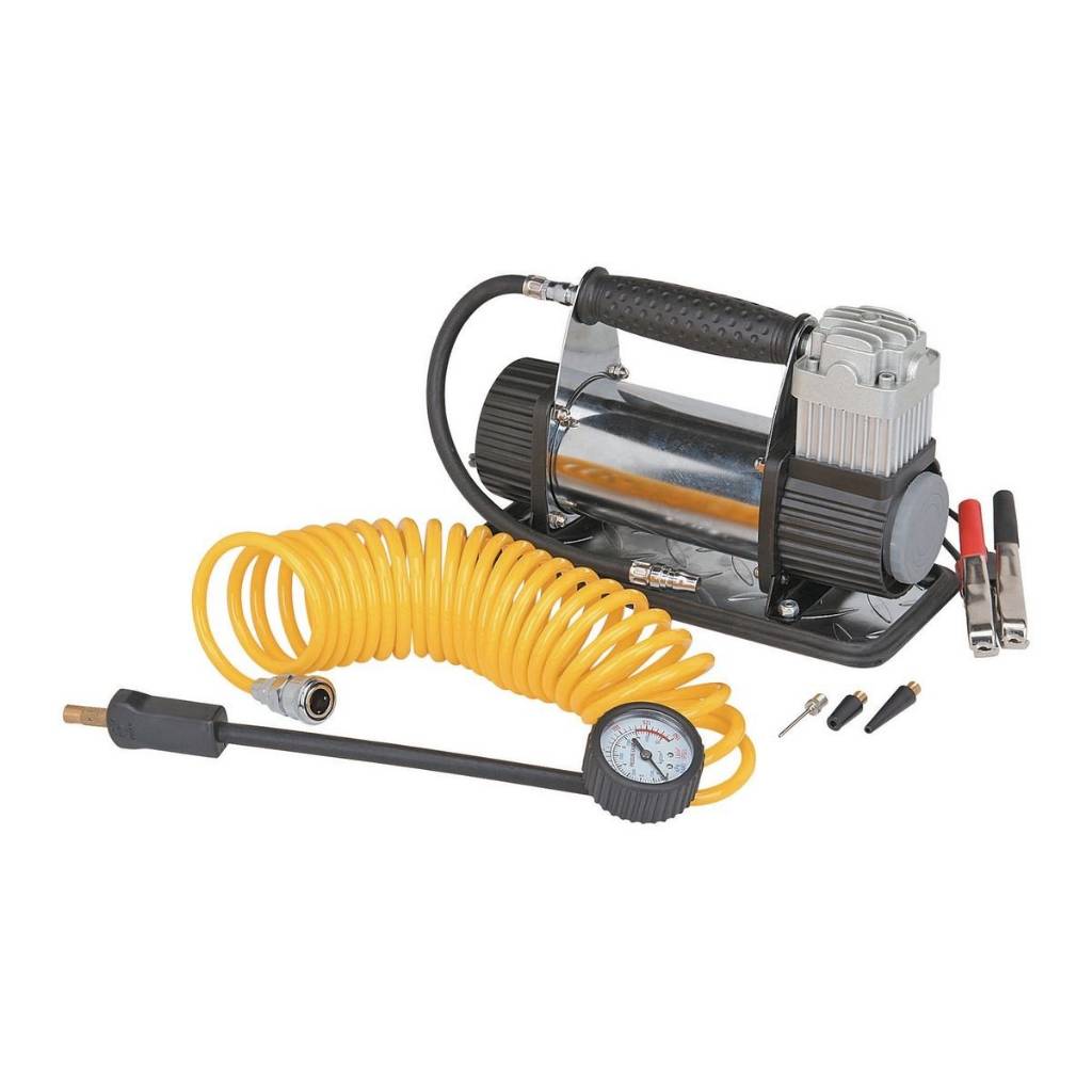

I've run the ol York comp. on mine for several years, only needing to buy a clutch. I use the nerf bars & front bumper, as an air tank. Works great, but takes up engine space & a little heavy. Haven't installed my latest purchase yet! I bought a "Tuff Stuff Xtreme Portable" 12V compressor, off Amazon, for $100. Looks like the HF one, but may have more cfm. Saw 2-3 models at the OBX ride, that were near identical. Even the Expensive Vivair unit, "Looks" the same, & may have the same spec. I Did pick out the highest cfm, I could fine. It doesn't require a tank, but when I switch, I plan to plumb it into my system, for more capacity, & give it a cycle time.

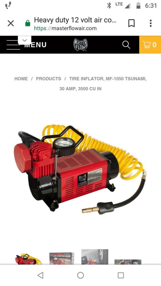

Can't beat the MF 1050. I've had one for many years, like 12-13 and bought another for my work truck. At one time I bought a Viair 400 portable unit that has 100 duty cycle and cost over $300 and the MF 1050 outperforms it.
