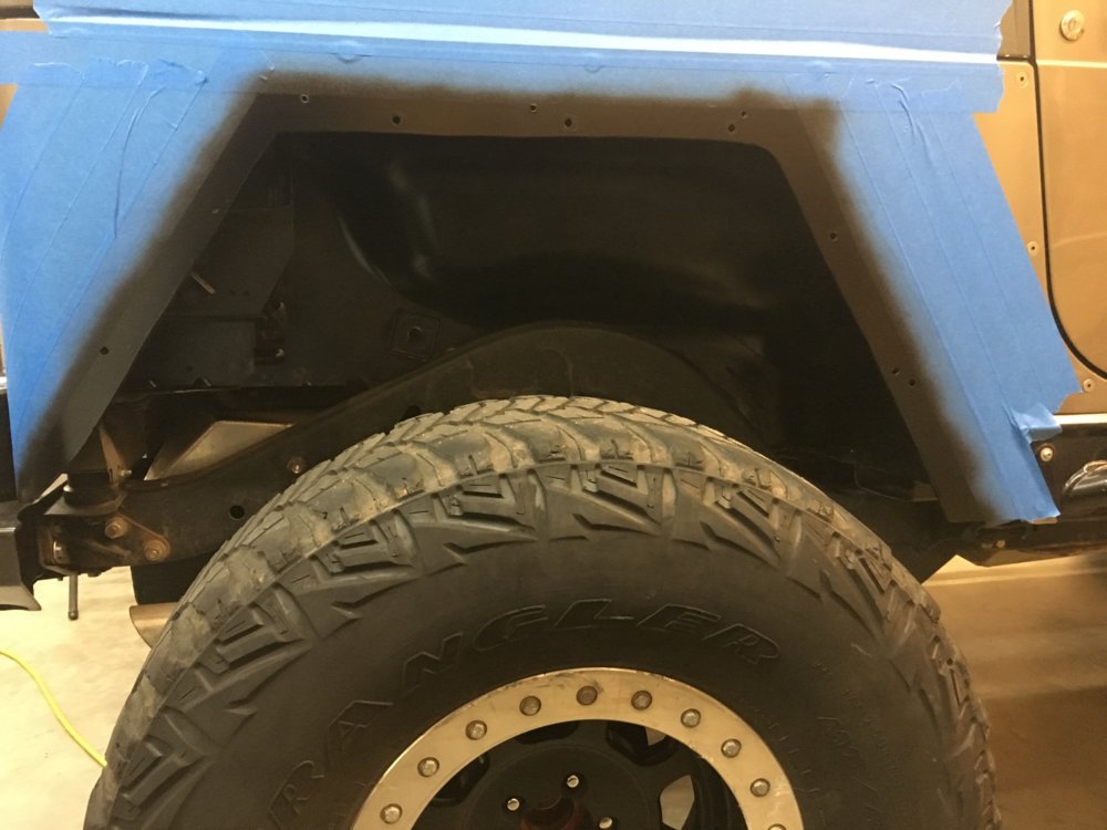

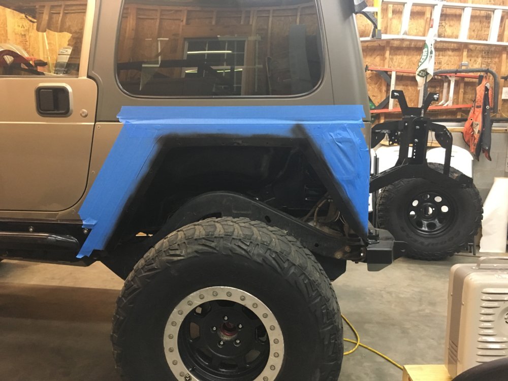

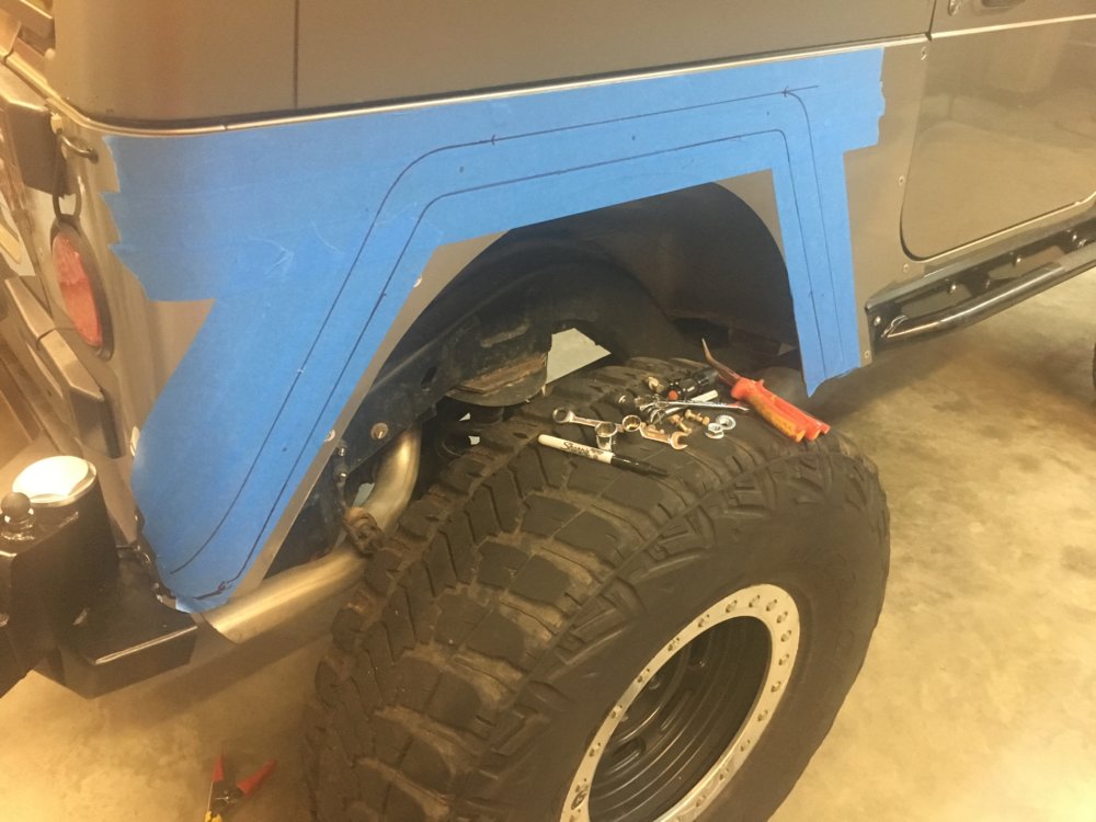

Getting ready to cut the rear armor and body under the armor for more clearance before installing new JCR flares. Thinking of fine tooth sawzall and jigsaw is going to be the best tool for the job. What do you all think?
