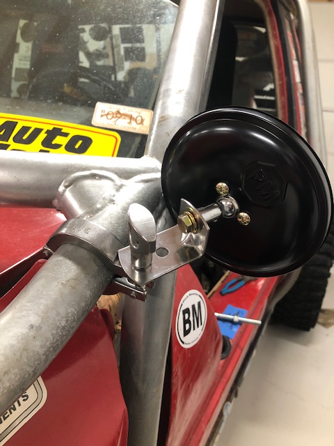

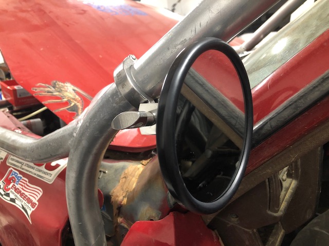

I use a cheap truck mirror and a sanitary clamp aka tri-clamp , tool less removal and adjustment , less that $20
^^THIS^^ Appears that it'd work much better for those of us *without* vertical tube... mines at about 17*, so the RS wouldn't likely allow enough room for mirror adjustment
