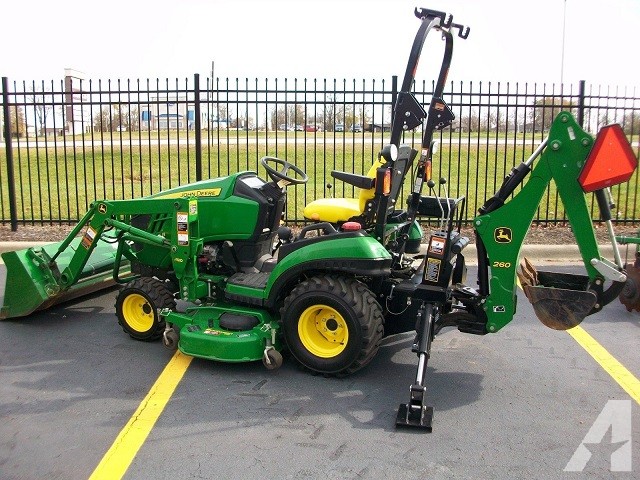

Everything a new homeowner could need all in one package. 1 Series John Deere. 0% for 60 months.
Good lord...does that thing brew coffee and still some shine all at the same time?
Ha...."zero percent loan" :lol: That's almost as funny as saying a politician is "honest" and "looking out for our interests". They just mark just the total price and spread it over the course of the loan, like a surcharge for letting you make payments to them. I think there's a word for it already...oh yeah, interest :D It may not actually be the same thing, but somebody is definitely going to make money on it. They do make it a lot more difficult to look at used tractors when you see what you can get payment-wise on new ones though.

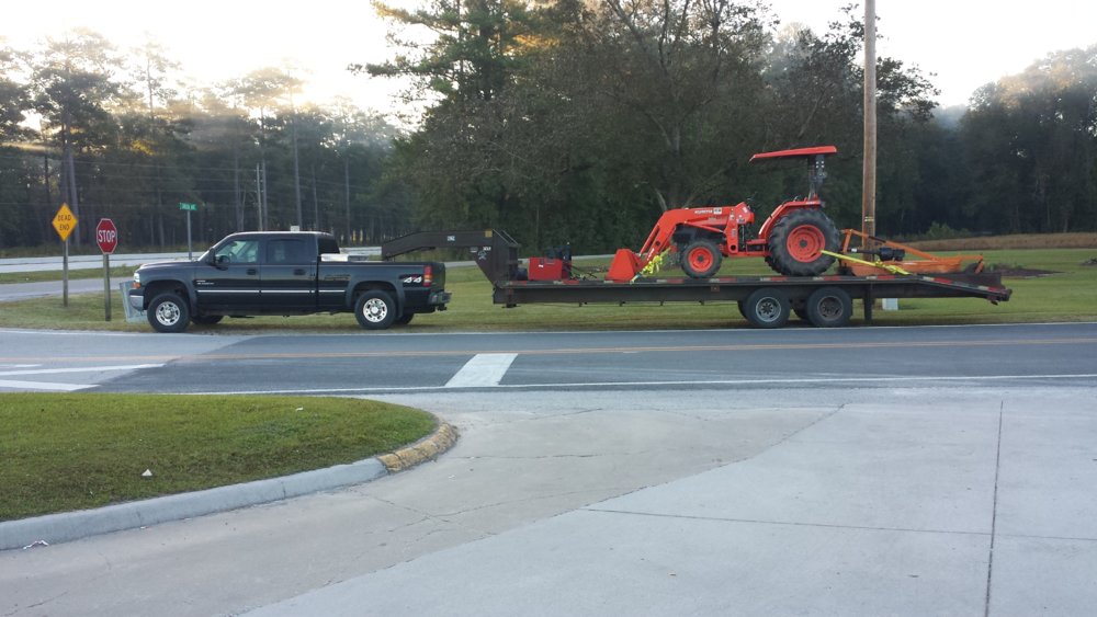

The one I bought was a 2008 Kubota L4400. 4x4, hydrostatic, quick detach LA703 FEL, and it has a canopy. The 4400s are 45hp and 38 at the pto, has one set of rear remote hydraulics, diff lock...etc. It weighs 3307 lbs and the loader with bucket is another 1351, so 4658 total. I gave 18k for it, which may be a little high, but it did also come with a 6' Woods bush hog and with only 340 hrs on it, it might as well have been new as far as I was concerned.
I'm sure you can find something cheaper though.

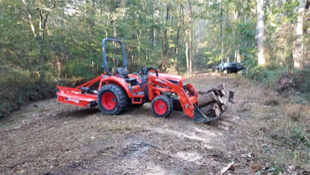

I got a Kubota L2501 last year for my 15 acres. Seems to be the perfect size so far.
Basically I got the biggest "real" tractor they had that stayed below the emissions requirements (25hp). No DEF, no regens, etc.
So far used rake, fertilizer spreader, box blade, FEL, drag harrow, etc and have not lacked for power. Also got the subframe backhoe. It works great for what it is, but no way can it make up for the weight and power of a real backhoe. To do it over again, I'd probably have put the backhoe money into a mini-ex.
I like it.
BTW, tractors are like late model Jeeps....pricing on newer used ones was right up there with new. I looked at a lot of overpriced used crap, then bit the bullet and went to the Kubota dealer.

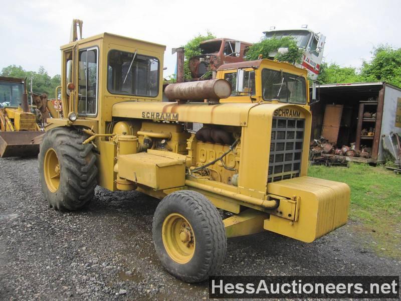

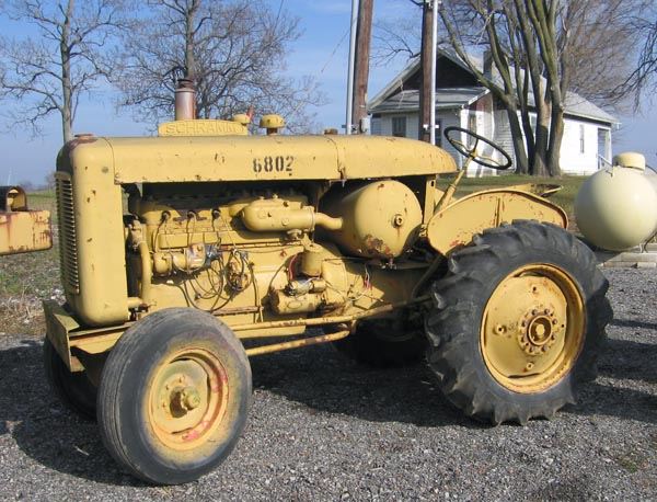

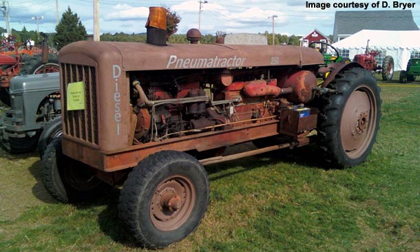

I'll pitch a throwback to my previous employer. They haven't made these things in the past 30 years (moved on to drilling rigs and equipment), but they sure were cool.

Them things are cool as all get out!!!

Damn right. They kept a couple around out there at the facility. We had to fix a water leak that involved doing some digging and busting concrete. They had a pneumatractor with a backhoe. Just like the first pic I posted. All-in-one tool! Used a jackhammer attachment to bust the concrete, dropped that and snapped on the bucket and started digging all with the same tractor. That thing was badass.

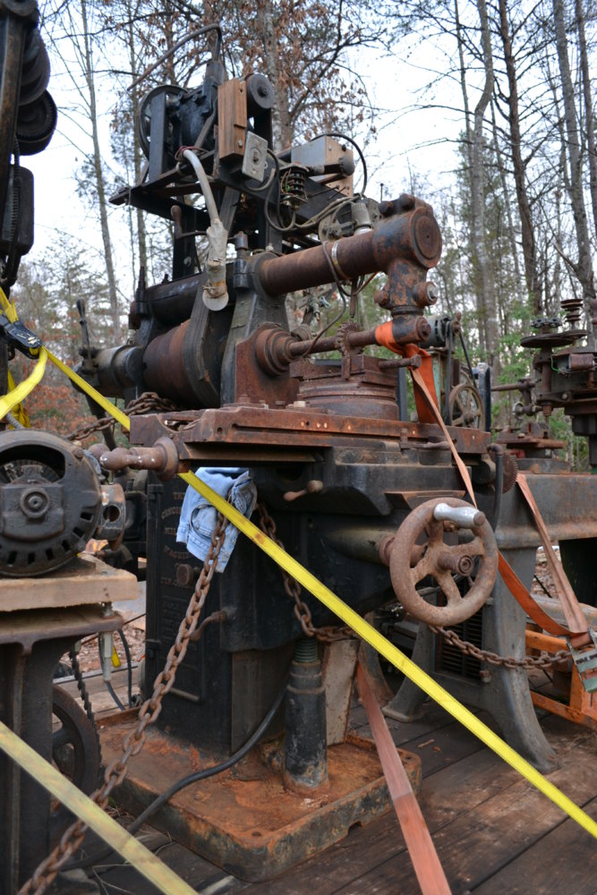

My New Holland L555 is on the smaller end of skidsteers at 45hp and 4500lbs, but it was able to pick up a 36ft long, 16" DBH pine trunk, along with a lot of other stupid heavy crap. I loaded an old Cincinnati #1 Horizontal mill on my trailer with the 4 in 1 bucket on it.

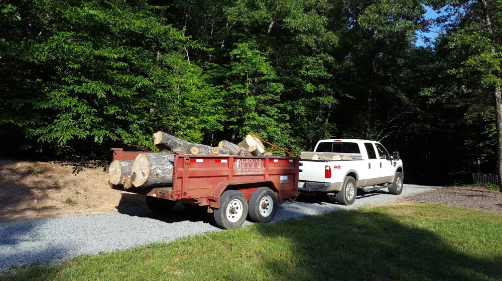

Loaded everything on here with my skidsteer, including the 14ft, 26" diameter red oak.

And yes, that is a car transmission on the top of the mill for the gear ranges...

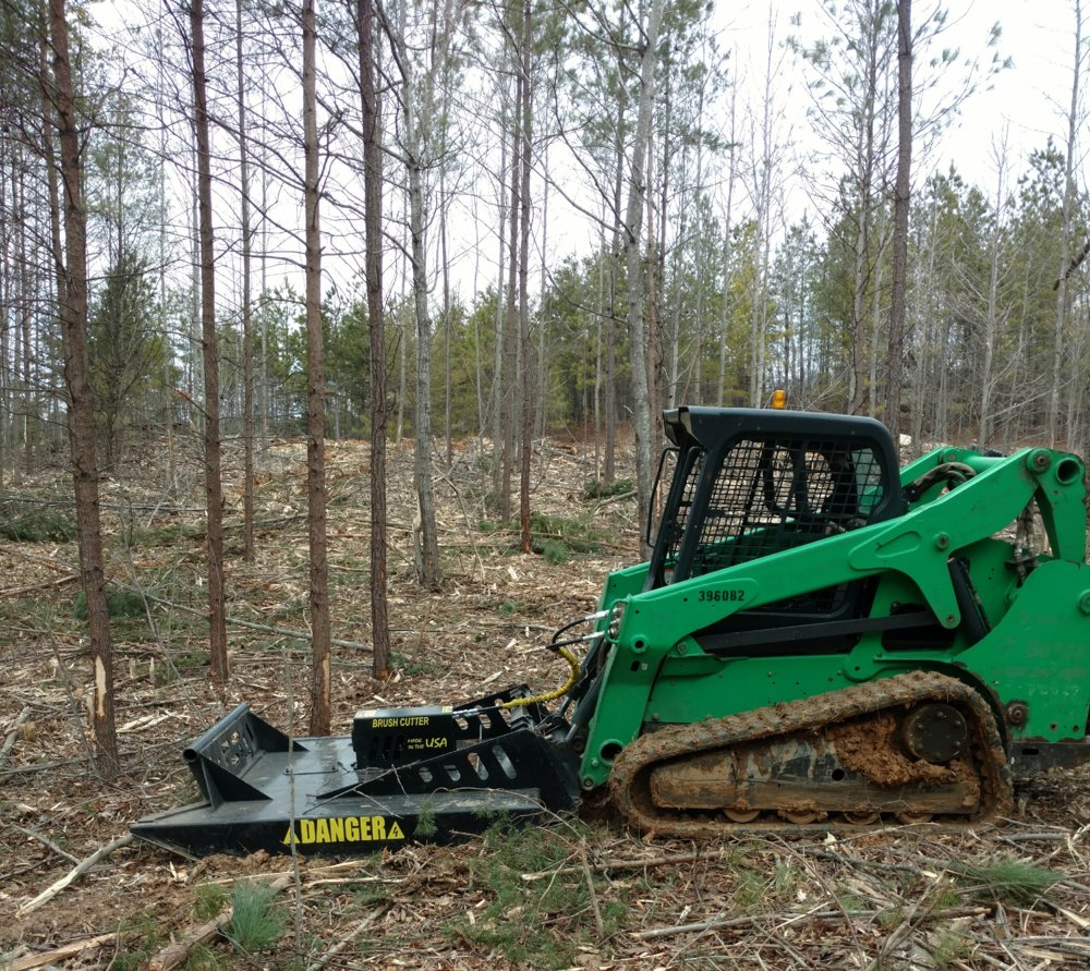

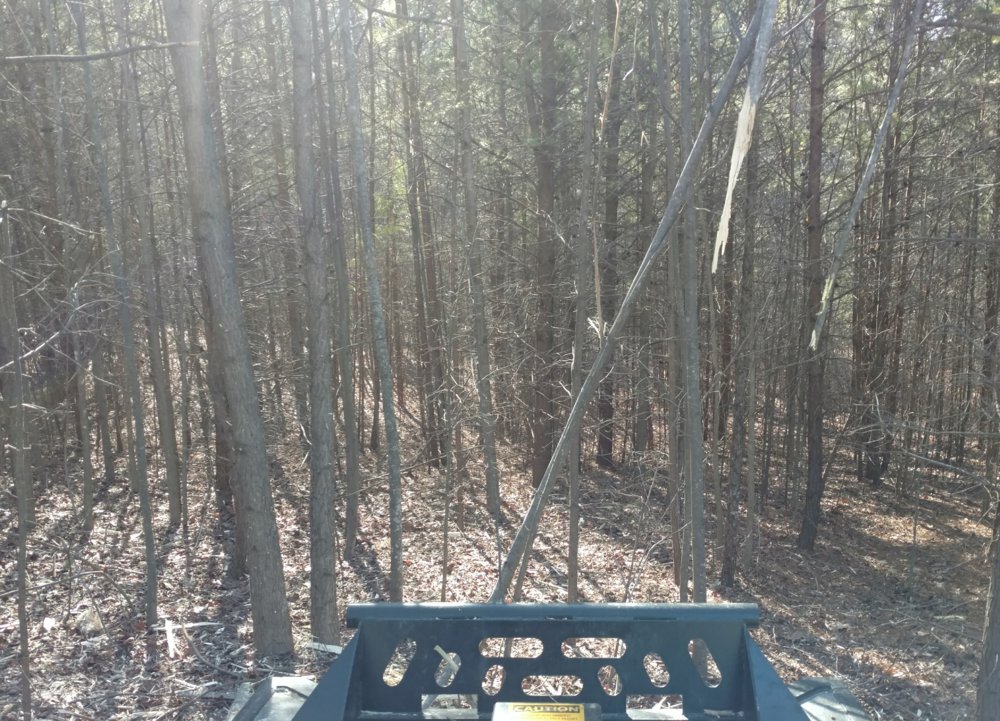

Bushhogging stuff like that ^^^ the tractor is better in most situations.
If you have small trees you want to get rid of, go skid steer as you can raise the hog up and chip lower it down onto the trees to chip them as you descend. On flatter ground you could get by with tires, I could not have done this with a machine on tires.
