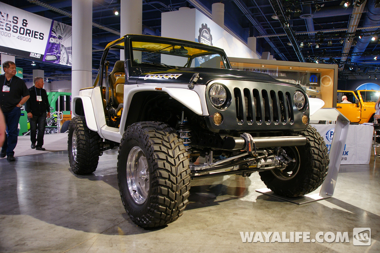

Take as little extra crap on the trail as possible. If your wheeling a small park you shouldn't even need to carry a spare tire since it would be just as easy to get a tug back to the trailer. And as far as a list of items to ditch; tailgate, spare tire carrier, any heavy front bumper, doors, fenders, any unnecessary engine accessories and all wingdings such as lightbars and other "hood ornament" accessories.
Oh and creature comforts don't really transfer to light weight. The more basic the better so no carpet, backseat, radio and replace the front seats with lighter suspension seats.
You could even go as far as replace your steel body with some kind of fabric like on this jk called stitch lol.
