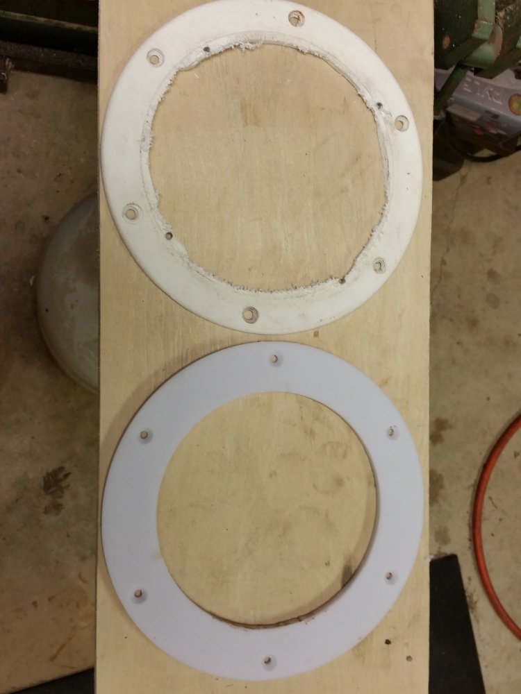

I did make these replacement rings for the front speakers. Left old/right new. But can't use the router table in the boat.

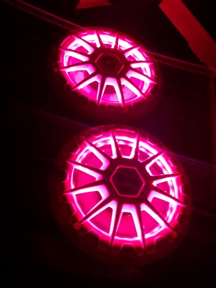

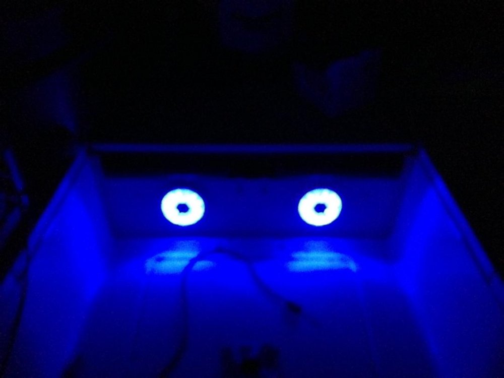

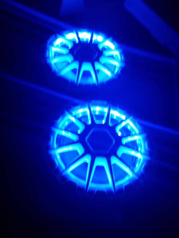

Got my speakers and speaker wire in yesterday. Pretty exciting getting an email at noon saying your parts have been delivered. Hole saw looks to be here on Monday. Hopefully in the boat sometime soon!

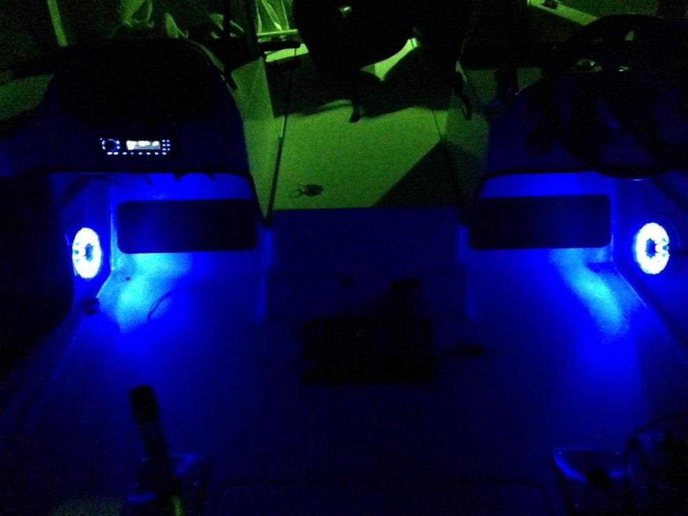

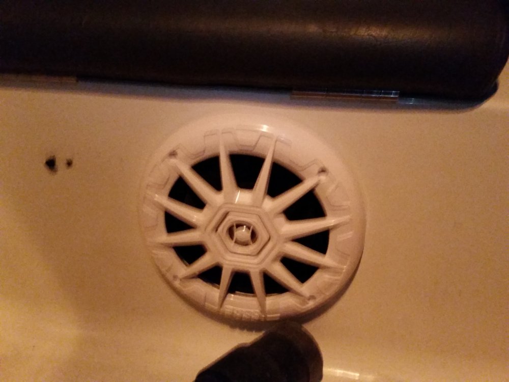

It's all in. Working so far.

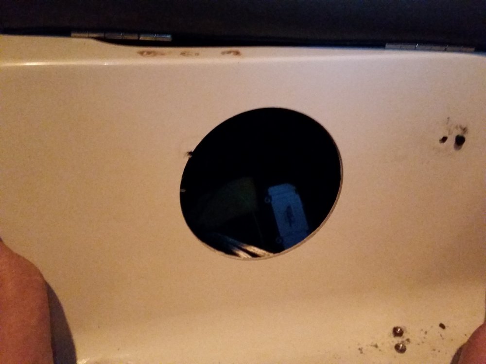

Hole saw worked good. Glad I went that route. Seriously took less than 3 min a hole.
On to the pictures.

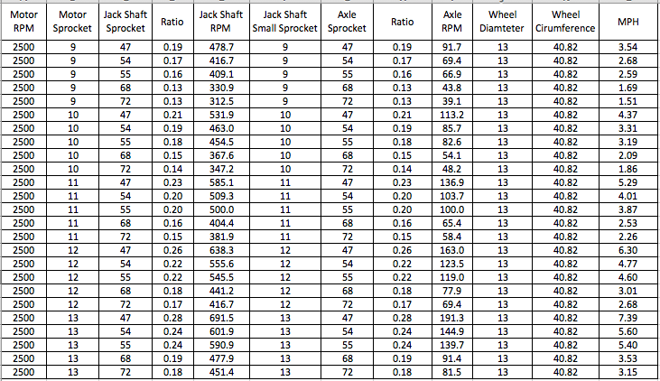

I'm trying to create a powered axle for a wagon. Let's say the max this wagon will weigh is 150lb. I want the wagon to go about walking speed 3.0mph max
Basically I have scavenged a 100w motor from a scooter that turns 2500rpm. I know I haven't really covered all the options with this spread sheet. Nor do I know if the math is right.
Please feel free to correct anything that you see as not correct.
I'm in over my head.
I'm not going through the math because it should be pretty simple, and it looks like everything is intuitively right.
I would recommend going with the largest sprockets for the desired gear ratio. With the larger sprockets the chain links will have a lower rate of angular velocity and angular acceleration as they wrap the sprocket, so you will gain some free efficiency through reduced friction.
So I would pick the 13 tooth if the larger sprocket will give proper ground clearance, etc. The extra sprocket and chain weight won't be worth worrying about.
