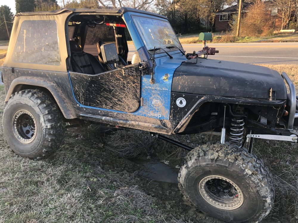

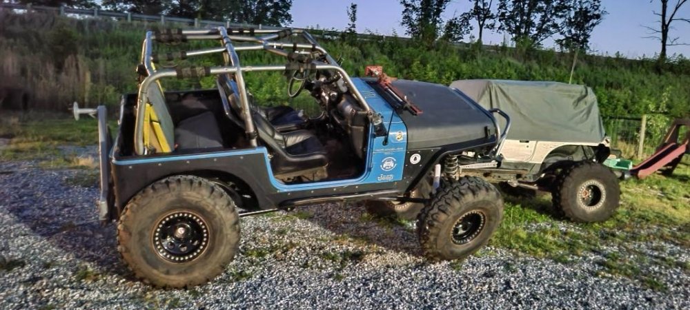

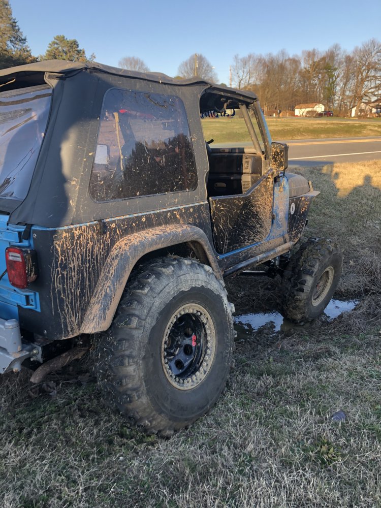

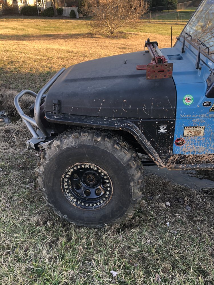

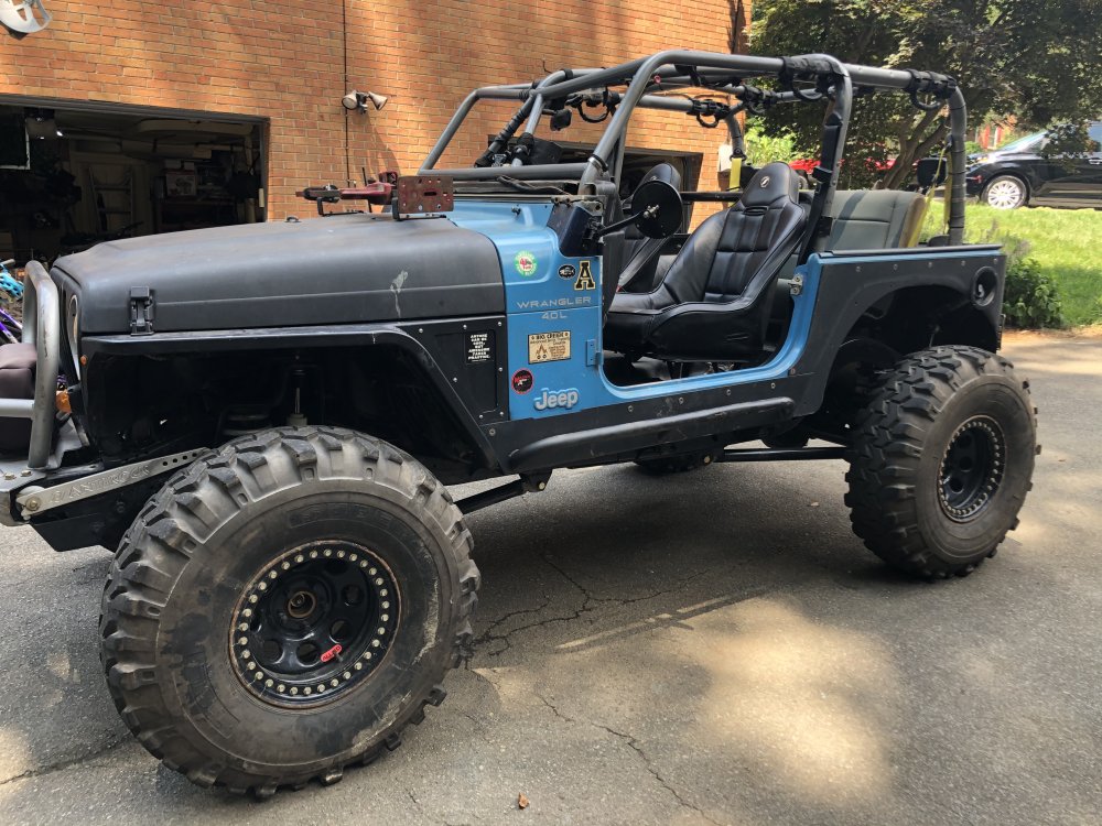

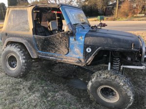

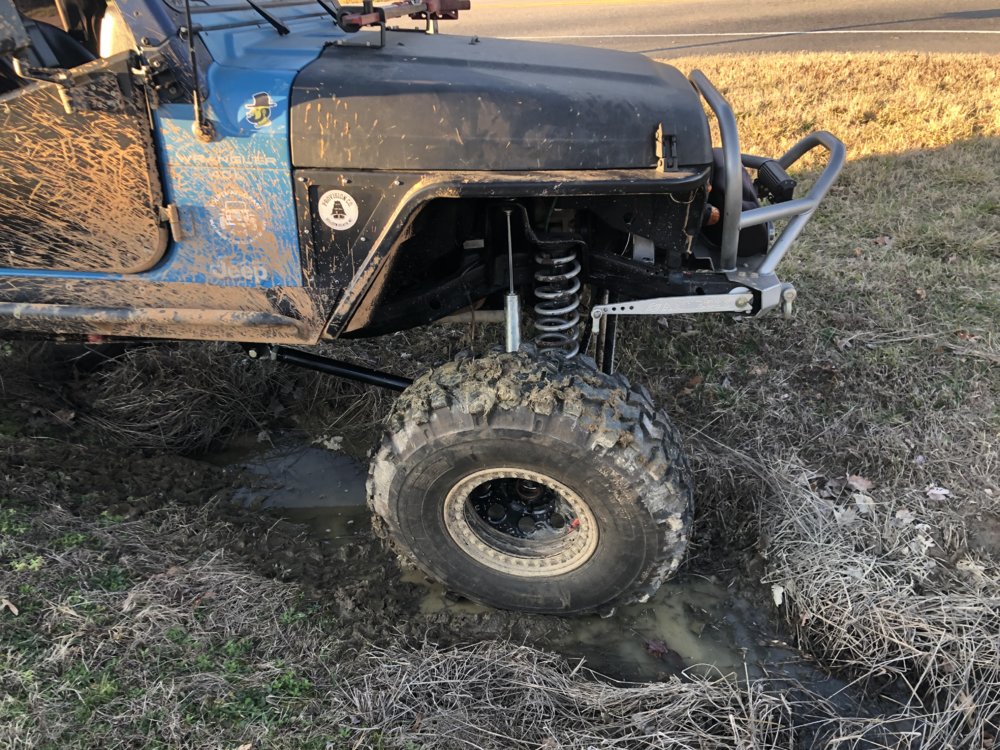

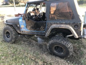

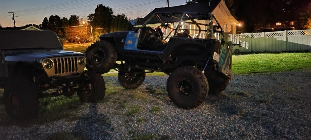

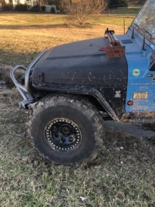

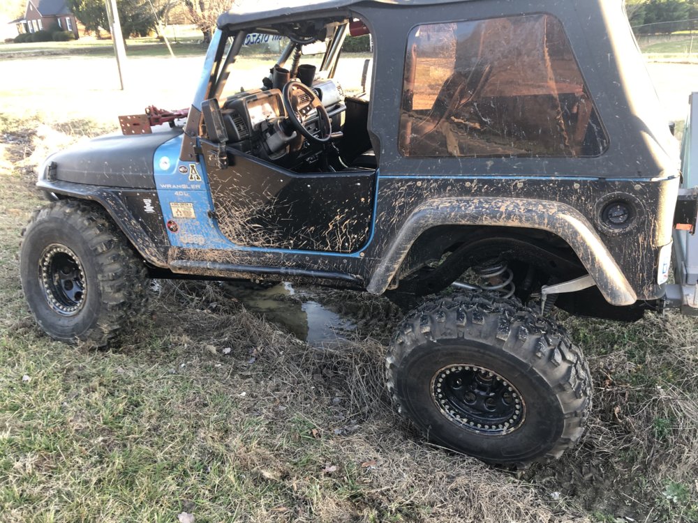

The PO of my TJ thought he was a fabricator. He was such a good fabricator that he welded the front lower axle side control arm mounts upside down. In addition the short arms that he put on there all had rubber bushings. Most of the rubber bushings were seized. Long story short the jeep had absolutely no flex up or down; ask anyone that I wheeled with, it was bad. Well today that all changed. The front is now 3 linked, and the bumpstops are actually needed! Softer springs and some longer shocks will be next but for now it is good.

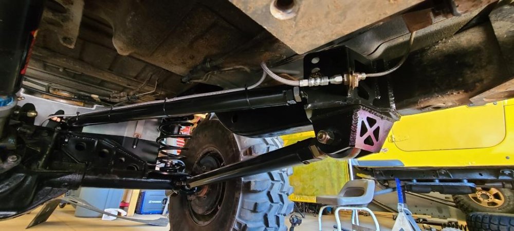

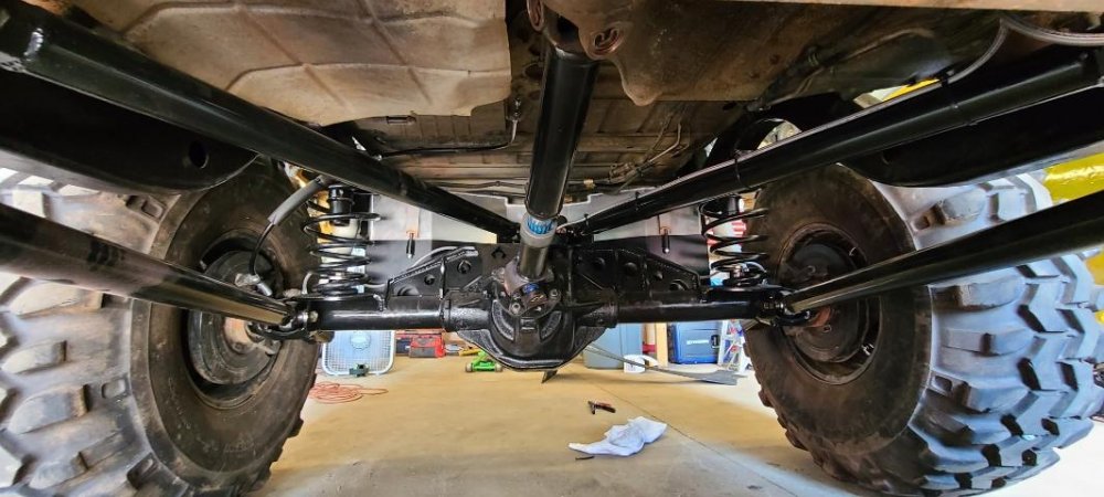

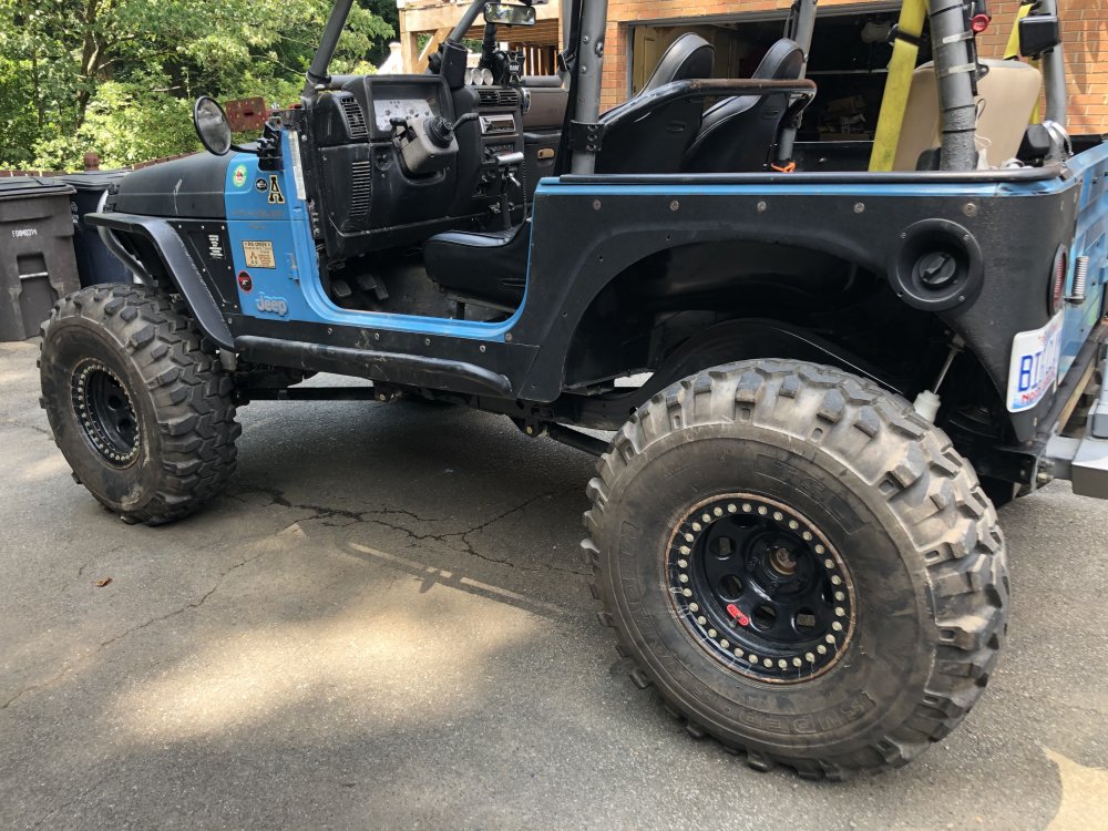

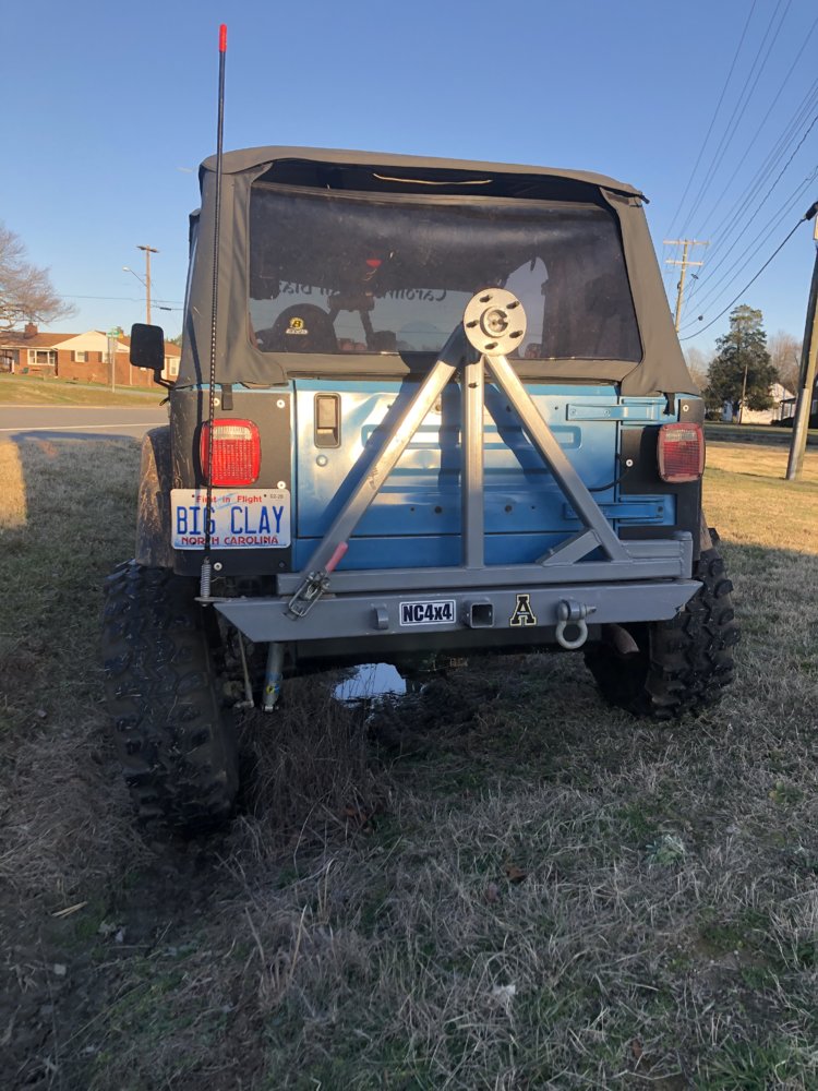

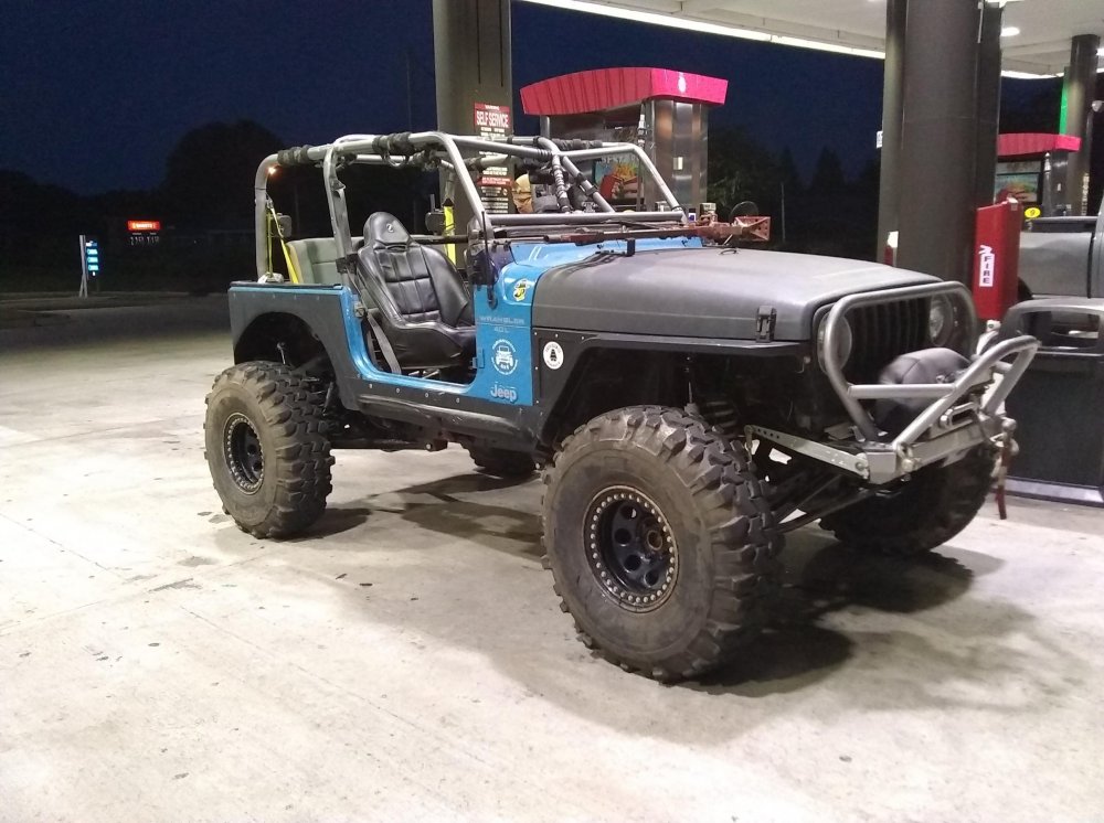

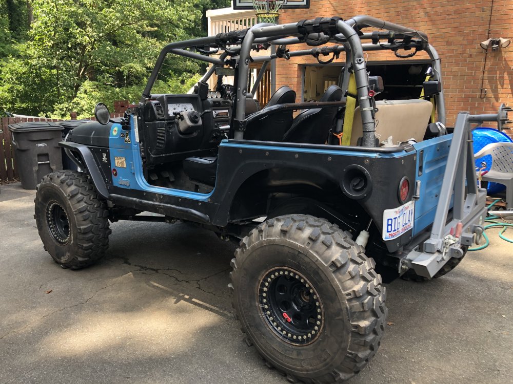

Well one year later and the 4 link rear is reality. Thanks @Chris_Keziah at Rev Limit Fab for the conversion.
9” stretch utilizing the brand new Gen Right 15 gallon gas tank, JK stock coils and a lot of grinding off old crappy “welds” from the PO.
There was some crazy “bracing” someone goobered together on the frame side control arm mounts. Took several hours to get those off!
@adamk has a pic of me attacking a portion of the frame with the BIG grinder, talk about a workout!
