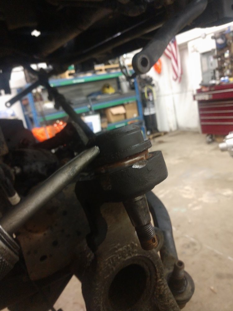

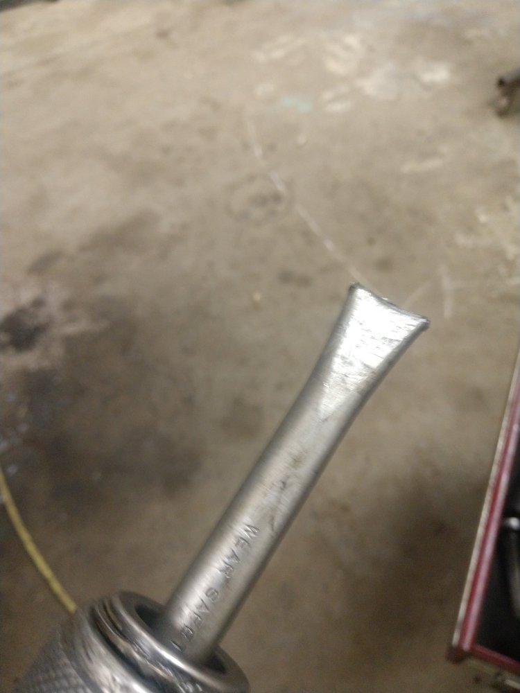

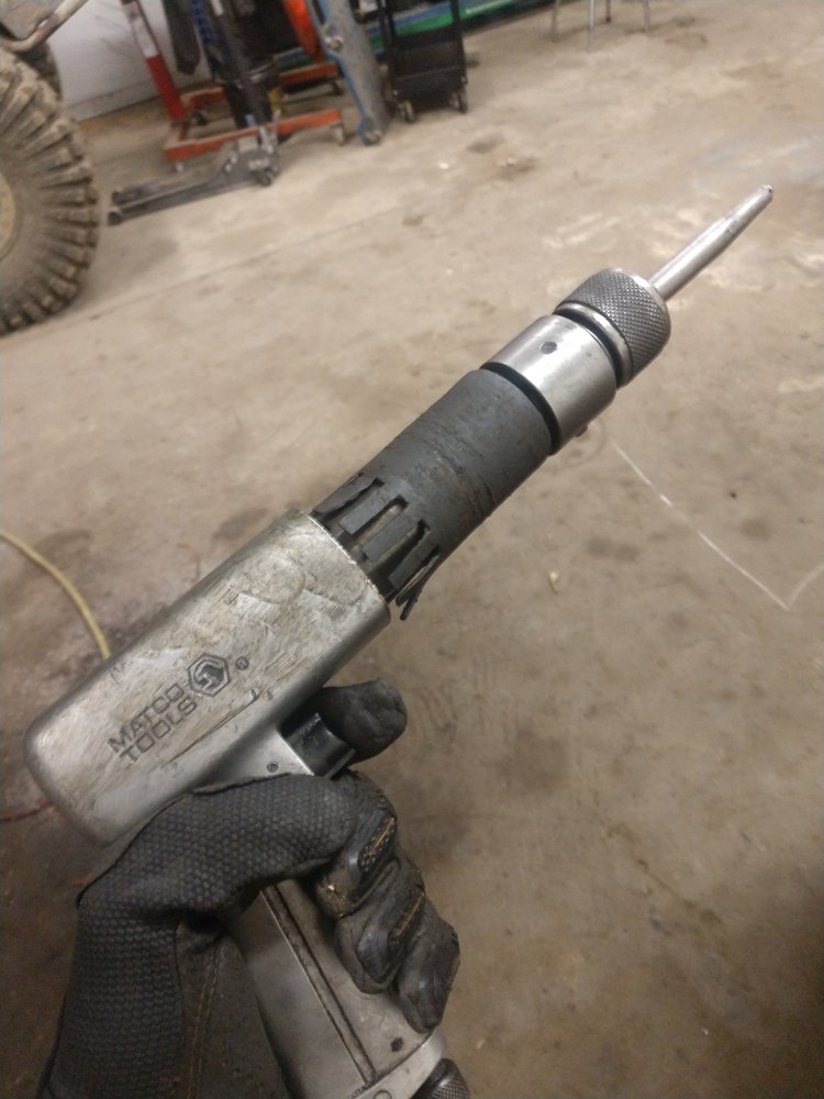

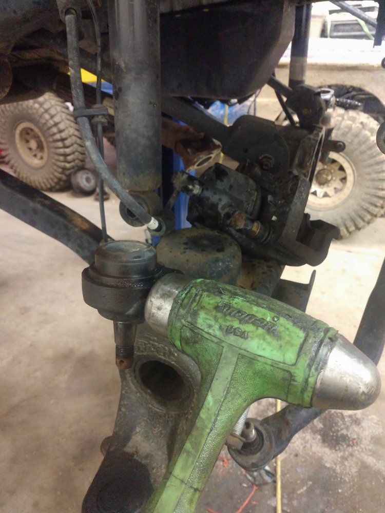

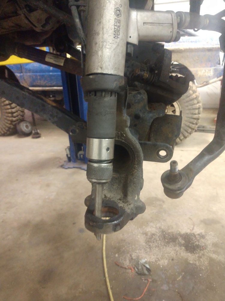

First thing is to smack the sides of the knuckle at the upper and lower BJ. This will jar it a little to make removal a little easier. Then I grab my long barrel super duty Matco air hammer with a blunt tipped chisel. Place the chisel on one side of the upper and give it a few seconds of action upwards. You are trying to push the joint up. Go directly across the joint and repeat. This will walk the joint right out. This takes me no more than 20-30 seconds.

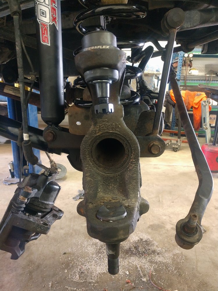

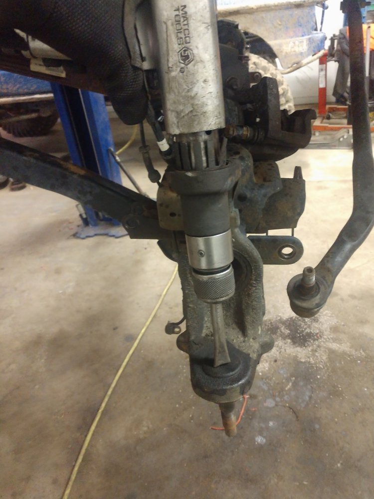

Next stick the air hammer and chisel down through the upper hole and push the lower joint down. Don't forget to smack the C a couple good times just like on the upper. Alternate on opposing sides of the lower and it'll come right out.
I removed both these joints in under a minute. No foolies.

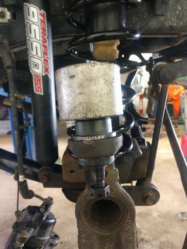

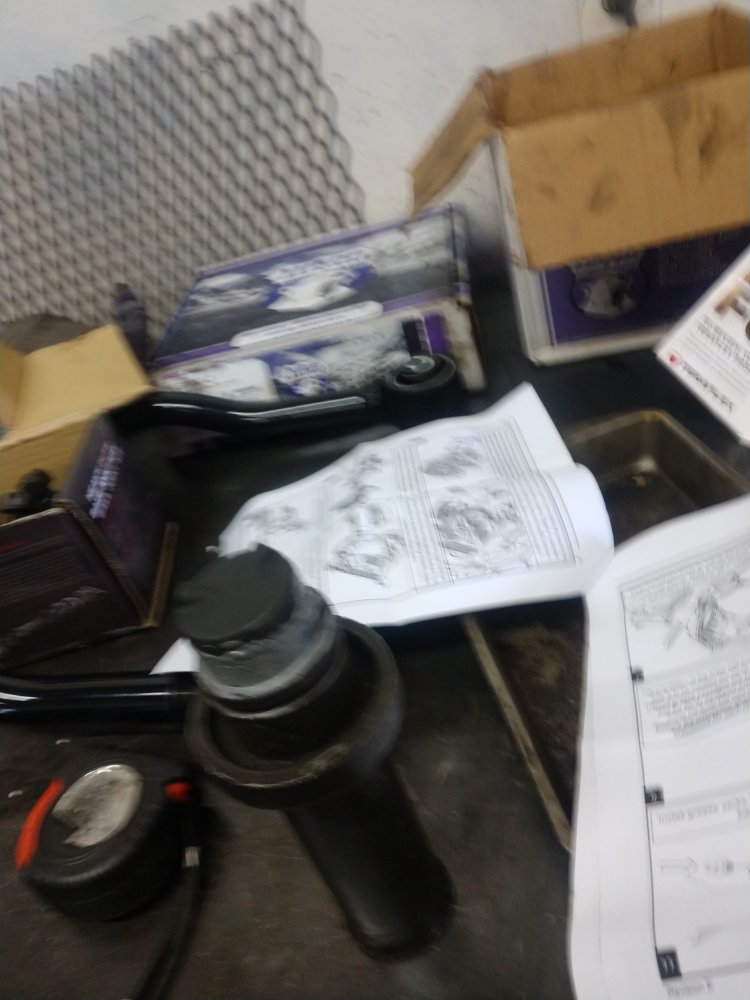

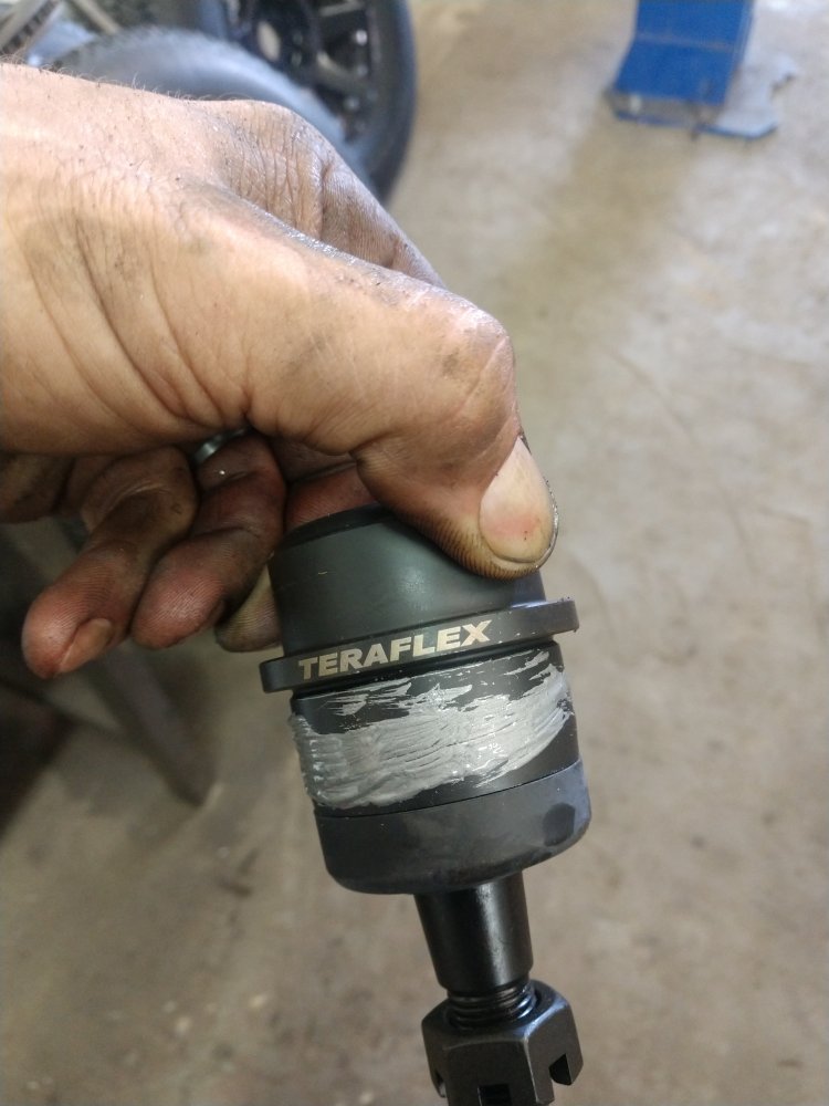

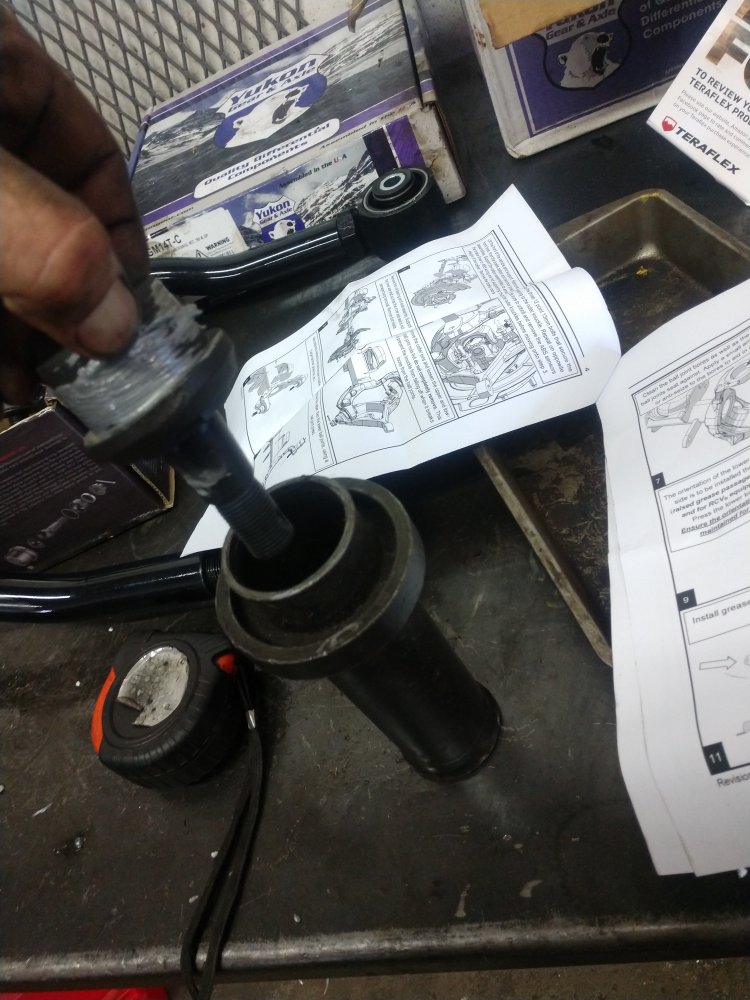

Take your new lower BJ, apply a bit if anti seize to the body. Set it in an appropriate size piece of tube. You want the tube to an inside diameter so the shoulder of the joint has the load applied. Center the joint in the hole, and smack upward with a hammer on the tube. It'll drive right in.
Take the upper joint, apply some anti seize again, set it in the hole. I drive them in with an old Tera aluminum bumpstop. It has a hole on it that lets the zerk pass through so it won't be damaged. Smack it with a hammer until seated. Just takes a few whacks.

Nice write up. Any recommendations on a good air chisel? I have a 15 year old IR from Northern Tool that never seems to be able to get the job done.
I've never been able to alter size or depth (run what ya brung), but I've also never provided BJ service so I guess you guys are the experts.
