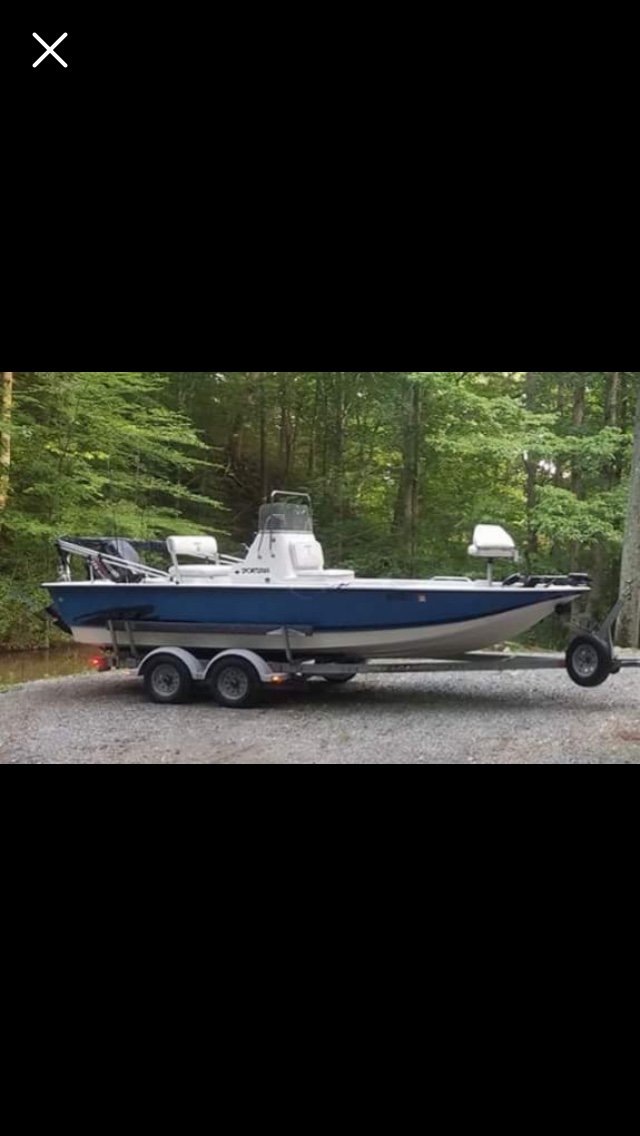

Think I’ve found a boat I’m interested in it’s a 1996 stratos 21ft cc I believe it’s a 2180 model? It’s a bay boat. It has a 96 Johnson 175 v6 fast strike 2 stroke. Has anyone had any experience with stratos cc boats or the johnson engines. From what I can find stratos and 2-3 other manufacturers used the same hull at this time. And there is a possibility that the boat is a full composite construction.
You need to know if thats a carb motor or a FICHT motor. Could be either.
If its a FICHT run. The FICHT technology was problematic and OMC never fully integrated the German technology. Then abandoned it. Parts are almost non existent.
If its the last of the carbs (96 and 97 were split years with both carb and FICHT options) its a damn good motor.
A carbed 175 of that era, properly tuned and running will flat out spank a modern 200 or even 225. Those motors were hosses.
They used an oil injection system known as an VRO (Variable Rate Oiler) that was so far ahead of its time its crazy. It precisely blended and mixed oil based on rpms. Working properly they are amazing. However much like early TBIs lots of "mechanics" didnt understand the technology and ripped it off or bypassed it and just dumped oil in the fuel tank like an old school two stroke. Know the status. If the VRO is still hooked up USE IT.
Its a 6 cylinder engine that uses 6 individual carbs and progressively brings them in. Search for "link and sync" watch a youtube video and make sure you feel comfortable completing the procedure annually. Its necessary. The motors require a little bit of maintenance...but a carbed fast Strike 95-97...damn fine motor. Plan on replacing the water pump every other year. Should cost $150 including labor. They use a plastic impeller and if they fail at speed, the motor will melt down before you have a chance to shut it down. Cheap insurance to replace every other year, imo.

I do believe it’s a carb motor, I was planning on doing a full tune up with new impeller so that’s not to big of a deal. I’ve watched the video on the carbs and not 100% sure I’m confident enough to do it on my own but I got a friend that said it was pretty easy and willing to show me
i saw one of those and several others about the stratos boats, everyone seems to think they are the same as hydra sports and from the research ive done on them everyone loves them and thinks they are solid boats built like a tank. not being a full composite boat isnt a deal killer as long as the fiberglass isnt crack on the decks and all the hatches dont have rot around them.
Get on the boat and stomp around the deck looking for soft spots. Some "spider cracks" are just in the jell coat and do not indicate the boat is falling apart. Also tilt the motor up and down and grab/shake and jump on the motor like your'e trying to rip it off the transom. If the transom bends or there are already cracks anywhere near the transom and the motor mounts, it could be trouble. If the transom is solid it is a boat that will probably last longer than you. I think the "built like a tank" comments are true for that year.

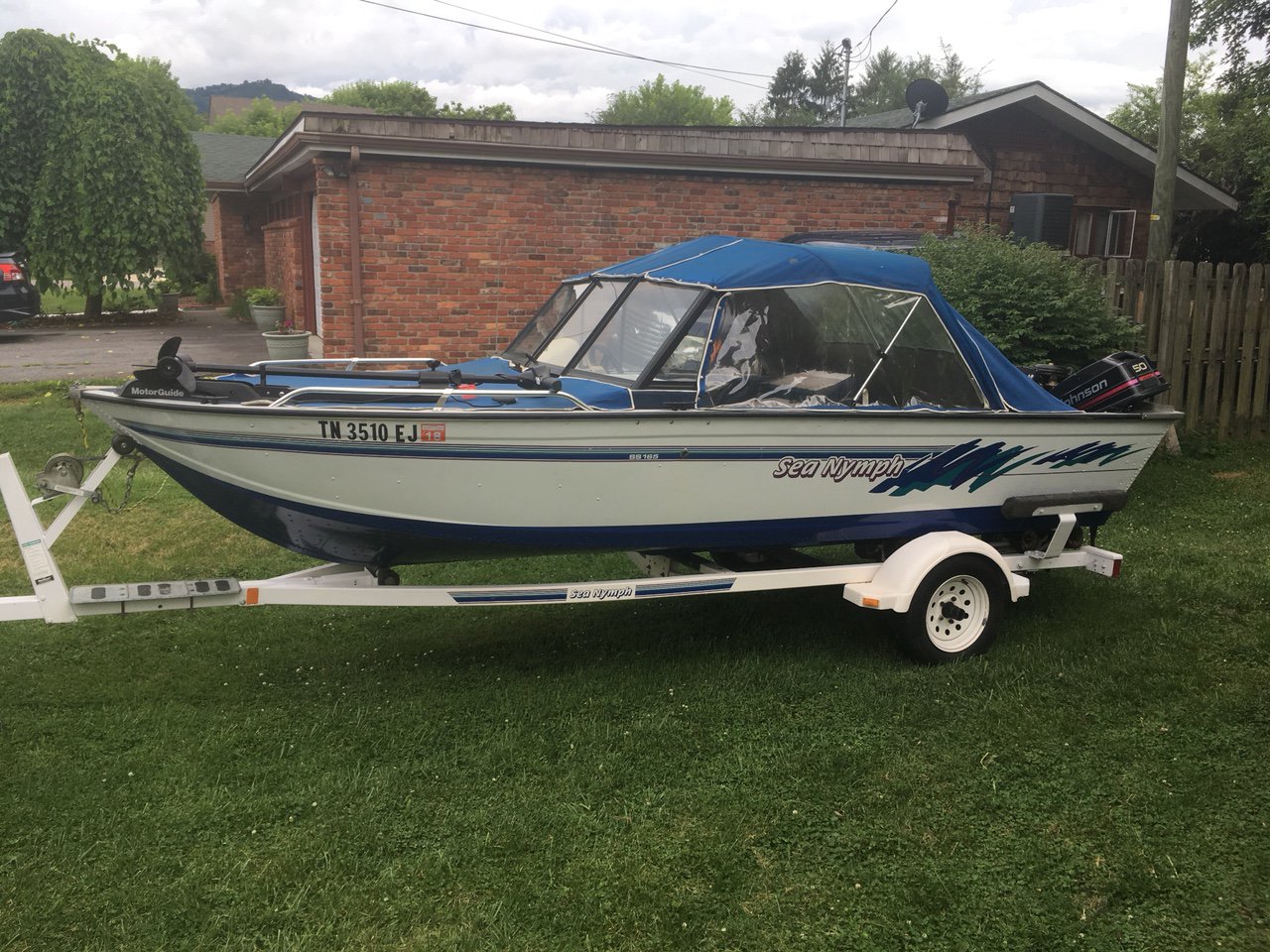

Aluminum boat will be lighter/cheaper to drag up and down the mountains, never rot and perform better w less HP compared to a similar sized glass boat.........the windshield and enclosure will make it real nice for boating/fishing/hunting in cold weather, keeping the cold wind off your face etc. I use my G3 to hunt deer round here. I can access remote lands easily and If I bag one I only have to drag it to the shore/bank and then bring the boat to pick it up instead of dragging them to the boat. Most of the time Its a down hill drag around the lakes/rivers.
I couldn’t make up my mind on wanting a center console or an aluminum boat. This one is all aluminum floor and was the nicest boat I’ve looked at and it was also the cheapest. It also doesn’t need anything while all the others needed a little tlc here or there. The only down side is it’s a 16ft boat but I can deal with it
