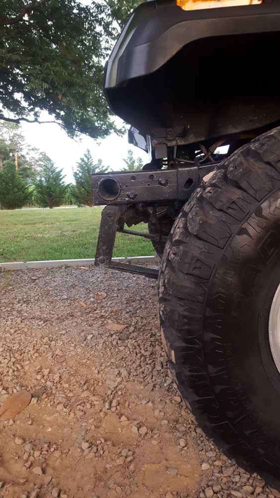

Will try to upload pics in a min. To me it seems like the front shackles are only swung forward a little bit and they more or less go straight on a down travel and then that is it. I an going to see if I can attach a video link, it is the first jeep an you can see where the tire comes off the ground.....

Im looking at it on a 4" phone screen but when it carries the R front it looks like I see a sway bar end link screaming as it does its job. I cant zoom in enough and maintain image integrity to be sure.

It articulates more when both tires are on the ground than in the brief moment when it lifts the RF. Hard to tell from the video, but I'm betting there isn't much weight on the front end at that moment. At least there isn't enough weight to compress the left front and force the right side down to the ground.
How much droop is there under normal circumstances? If you support the vehicle by the frame, how far do the front tires fall away? How far is there between the axle and the bump stop at ride height?

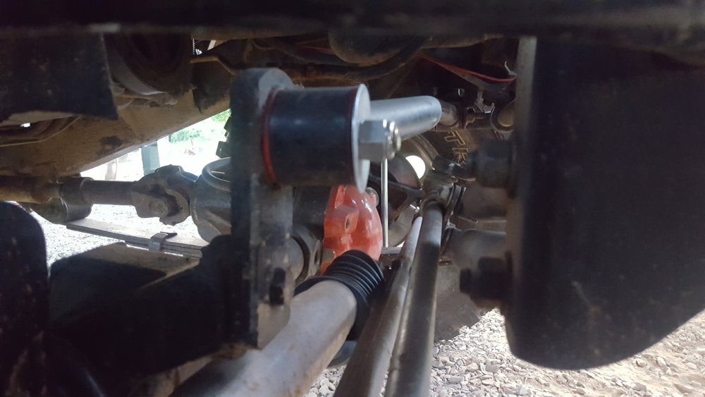

Pics that were asked for...
That Panhard end in single shear with a fender washer on it is very... ...interesting. That's a double shear bushing and should be used in that manner. You could turn that heavy plate into a lighter duty double shear bracket and fix that though...
So again I have always been a toyota guy, this is my first jeep. Can you explain it a little more? How "should" it be mounted? What exactly is "double shear"??....thanks..
