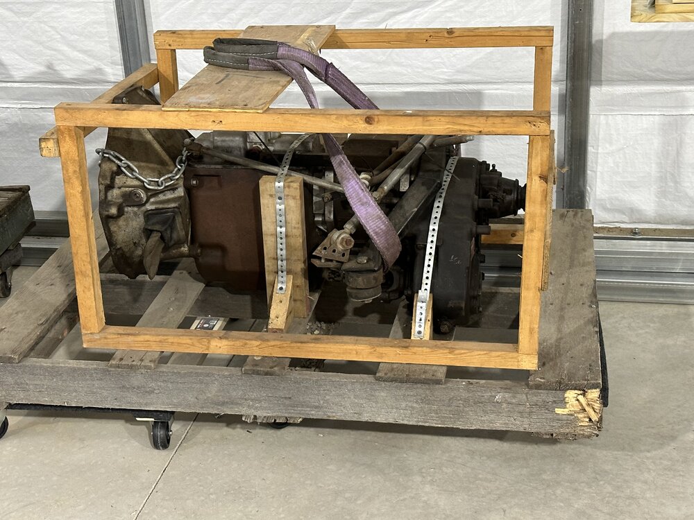

Do you plan to stretch the rear since your going with the doubler?
Hoping I shouldn’t have to, but I’ll cross that bridge when I get there. The range box section doesn’t look to be much longer than the np435 to Dana 20 adapter so I don’t imagine I’ll have too much issue.if you look at the photo, the crossmember bolts to the ears that that Dana 20 crossmember originally attached to, so it’s maybe an inch or two longer. If that.
Doing a little more research into what I have, looks like this is the Wild Horses Super Crawler Doubler kit, Only adds 1 3/8" to the factory drivetrain length. I may have honestly found the listing where Ed bought ( SOLD - For sale: NP435/NP203/Dana20 doubler ) it so I have a little more detail on it. If it is the same one, sounds like I need to go ahead and replace the input and output seals on the Dana 20. No big issues there. I need to get into the axles and check gear ratios to see if anything needs to change. and calculate my ratios. Got the fence put up in the meantime today. Hoping to get back to work tomorrow.
1 3/8" you will be fine. You have till about 4-5" till you start having to mess with things get them to work.

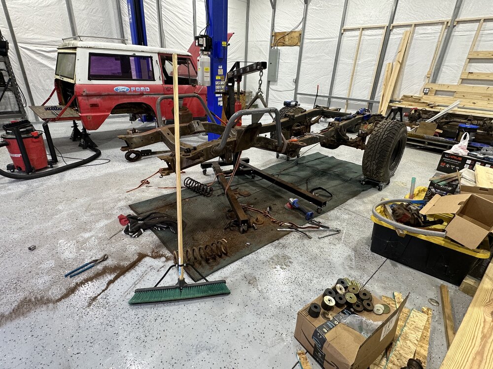

Awesome! Been working on cleaning the frame up today, tore apart the suspension to make room for the 44. Starting to clean that rust off. Thankfully we rust treated most of the frame before Ed passed, but the top needs to be done and the front needs to be done still. Not much work but important either way. Hoping to get a used 3.5” lift to go with the 35s. Need to order new radius arm bushings in the meantime.

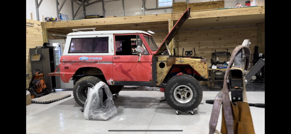

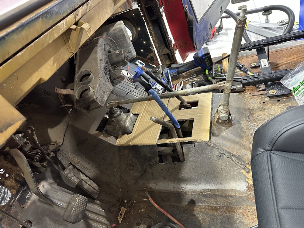

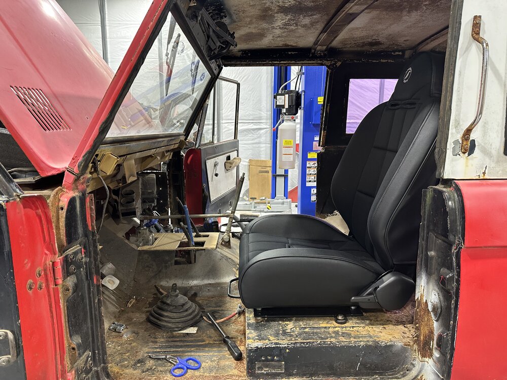

I have been working slowly on getting things done. Got the frame cleaned and swapped the Dana 44 in. Got the drivetrain in and found the intake manifold for the engine. Ordered a carb, fuel lines, pump, wiring harness, etc. Got the seat frames installed. Stripped the rest of the harness and got the body remounted to the frame. Still plenty of work to be done and I've taken a break from it for the holidays while my wife has been home during my normal wrenching time. My stepfather is supposed to be bringing me an air compressor so that I can use my new flange tool to repair the sheet metal for the front end. I cut the transmission tunnel enough to lift the body up without needing to disconnect the transfer case shifters. (It was too tight to get them lined up with the body in place) So I will be building a removable cover for the tunnel and practicing my TIG welding. Got my tires and wheels in and have been fighting to get the front bead seated on these Method bead grip wheels. Hoping to get a chance to work on getting them seated sometime this week. Plenty left to do, just need to get organized again and get started again.
Figured I would throw some of the photos from the past few weeks up.

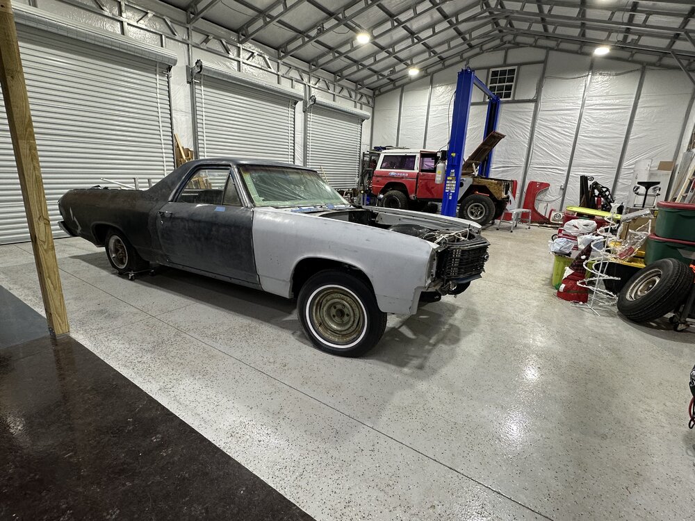

Haven't put a ton of work in the past few weeks. Had to get my El Camino inside after a wind storm tore the shelter down. Got the first piece of sheet metal replaced on the Bronco. Still need to clean and finish filling the plug welds. Planning to buy a small HF sheet metal brake to help with bending the metal for the transmission tunnel cover but haven't found the time to buy it yet. Worked on getting my Gym walls up and got a door for it. Hoping to get some more of the shiplap boards this week to close it in and keep it clean. Still have one more side to replace on the bronco before I can start wiring it and plumbing it. And I still haven't seated the damn beads on these tires yet. Hoping I will have some time again in the coming weeks.

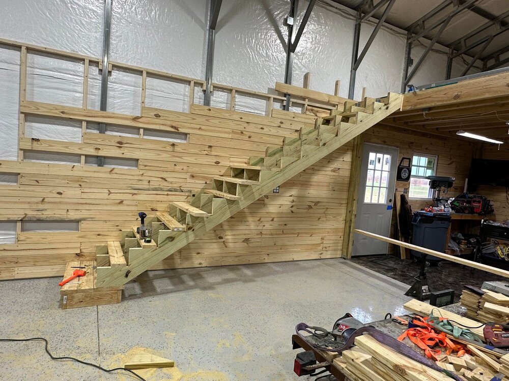

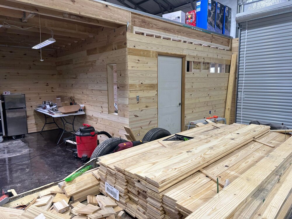

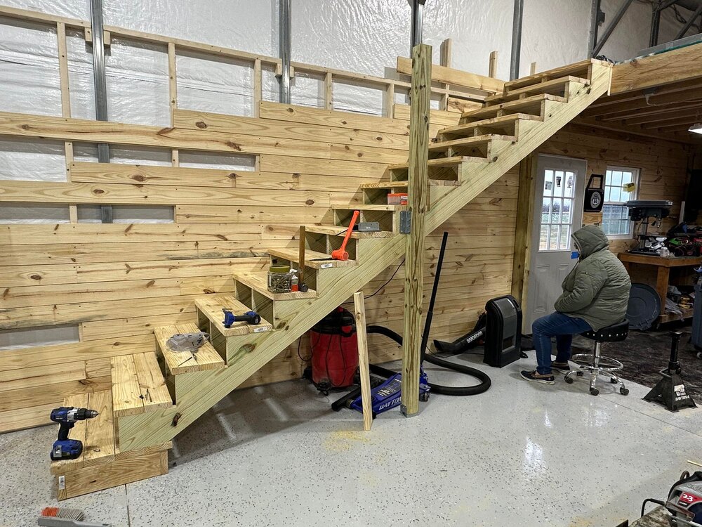

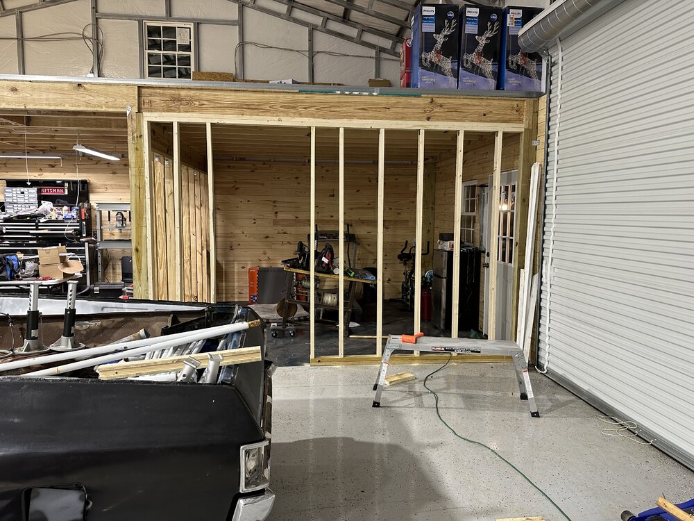

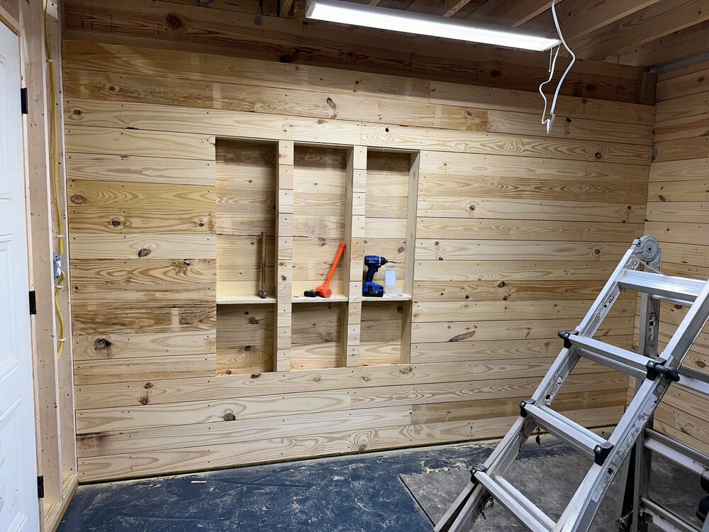

Spent this block of days off working on sheeting the walls for our gym and building stairs to make it easier to carry stuff above the loft. I wasn't looking forward to doing stairs because I didn't want to take up an extra 3 feet into one of the bays, but unfortunately I didn't have many other options that I could see. Still need to finish the railing and the backing for the treads but it's usable for now. Trying to get the gym finished and sealed up so it's more comfortable, then hoping to start on the other panel for the bronco after I get some general maintenance done on our DD's.
A friend was in a similar situation, so they mounted the top of the stairs to a large hinge, where it can be raised out of the way. He mounted a boat winch and pulley to pick it up and hold it. I think he he moved it once or twice to make sure it would work and hold, and ever since he just stores stuff underneath.
I was considering something like this, but ultimately, I ended up deciding that for the amount of work the net gain wouldn’t be enough for the extra cost and work. I was looking into either that style or something that would accordion flat against the wall. But I felt like I was over complicating something that wouldn’t gain me much extra space. I can still use underneath for storage and may eventually insulate and baffle it for a quiet room for an air compressor.
I'm glad this came up. I plan to have an office in my building and use the top for storage. Stuff to think about.
Another option could be, to move the stairs to the outside. Would require an additional door.
I’m glad it can help someone. Feel free to ask questions. I’m pretty sure it’s fairly overbuilt, granted I haven’t had anybody like @rockcity come out and tear apart my design so it may collapse at any moment 😂. But until that happens I’m confident in it.
That’s something I had not considered and would be a great alternative to have considered at the time. It would have allowed me to put the stairs in a spot where you don't have to avoid the rafter when coming to the top of the stairs. I can always take the stairs down in the future and relocate them if needed, but for now these will work fine I think.
