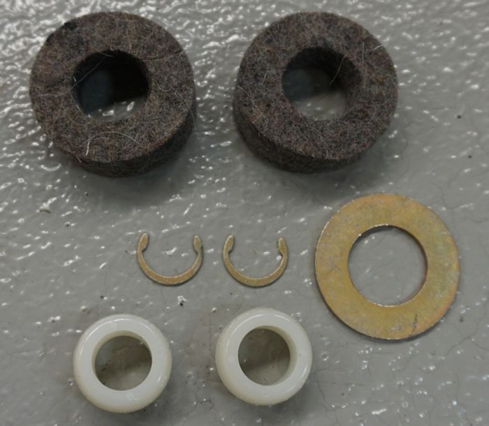

Make sure the z bar isn't shifting side to side in the mount, that can make it feel sticky. You can get all the parts to rebuild the bushings for the frame mount and z link from the bronco vendors.

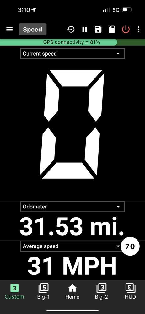

31.5 mile trip on the bronco now that it’s legal! Lost a gas cap after I left it loose to vent the overfilled tank and forgot to tighten it before I got on the road. 🤦🏼‍♂️ and had my clutch rod fall off the pedal because I forgot to put the pin in it. Always fun when the clutch pedal hits the floor at 50mph when you go to shift. Holds 55-57 mph pretty solidly steering wasn’t super sketch but wasn’t perfect either. About what you’d expect at 50+ years old. Getting some of the kinks worked out and getting used to the clutch and trans. Still some fine tuning on the carb but felt great to cruise around.

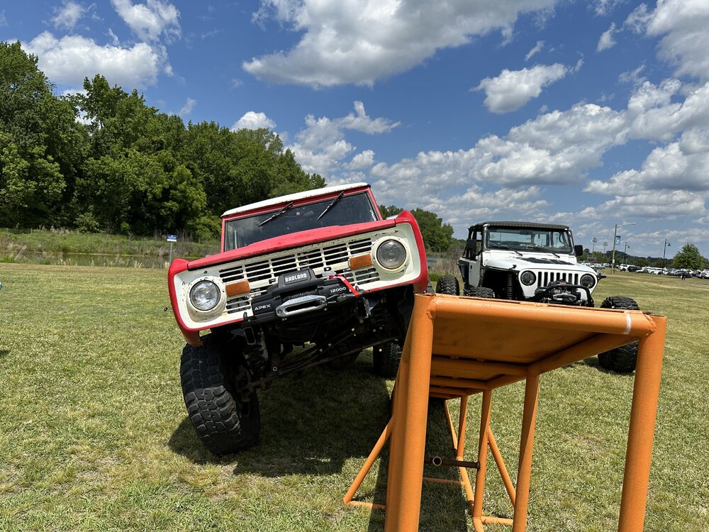

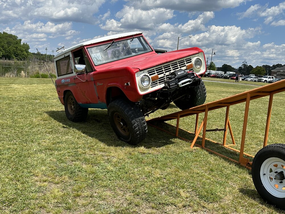

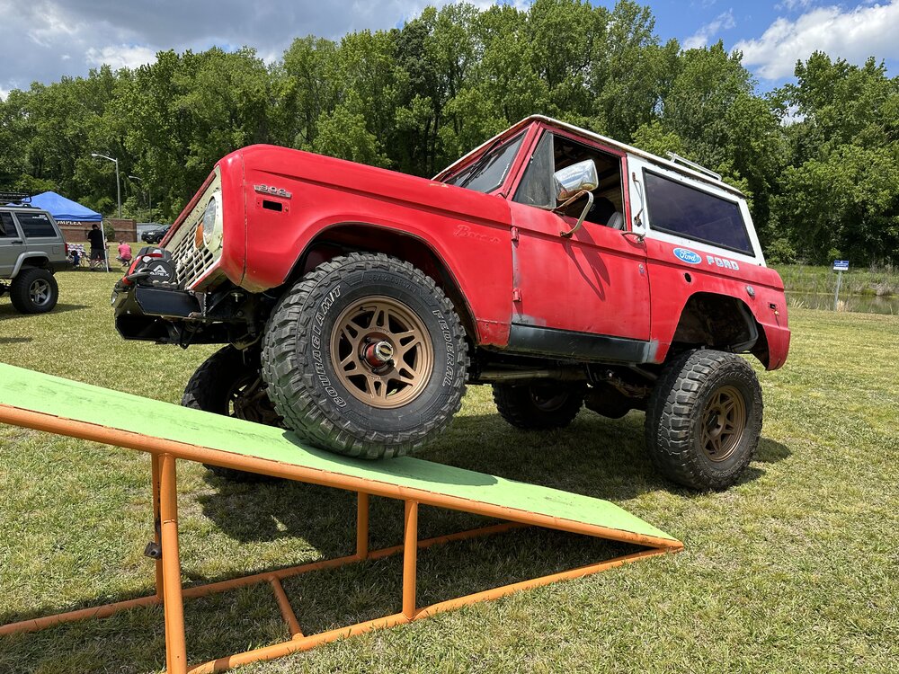

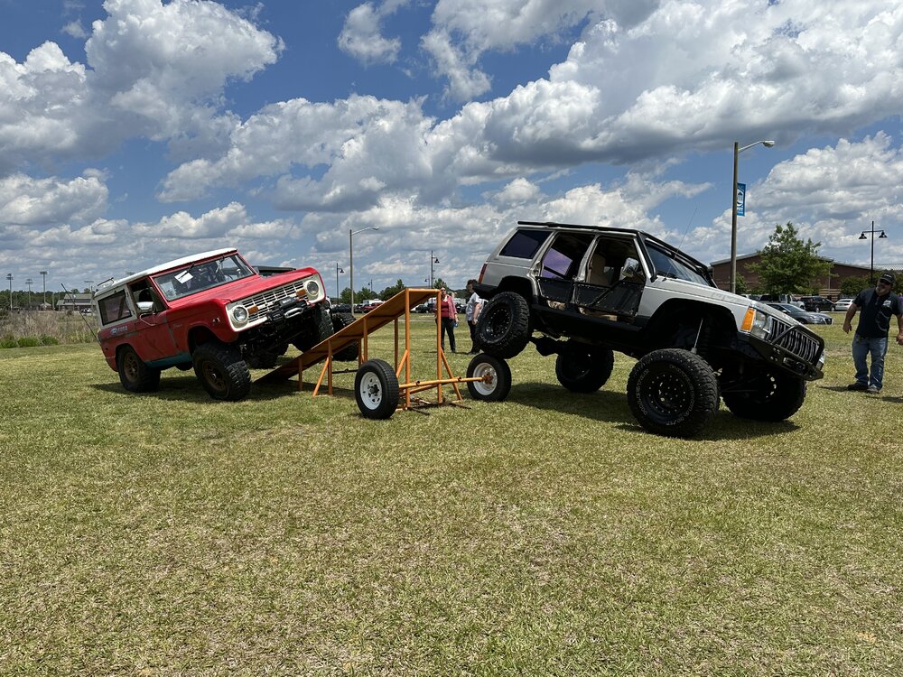

Took the bronco out to the local CC car show and got to flex it on the RTI ramp they had brought out. Got some wipers, side marker lenses and harnesses and a hood prop so I wouldn’t need to keep propping the hood against the windshield. Also worked on a little painting to see how we liked the intended color for the bronco. Gotta keep the wife happy. Figured since there was still a few weeks left until we go to uwharrie for Memorial Day weekend I would throw together a rear recovery point. Nothing crazy just 2x4 .180 wall with a HF receiver welded into it. Felt good to weld thick stuff again. I’m not a professional welder nor do I call myself a welder but it felt like it got good penetration, but I may go and put a wider pass on it before we go just for safety. It’s still nerve racking to drive it around but it’s been doing well. A little over 150 miles so far and 13.5 mpg. Not too bad overall.

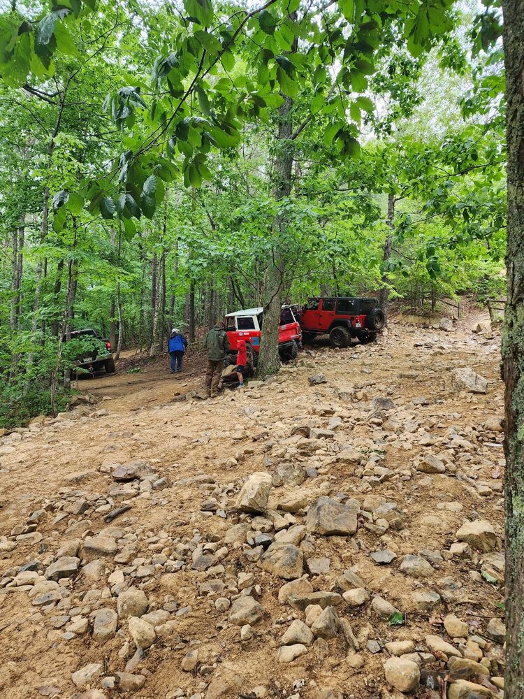

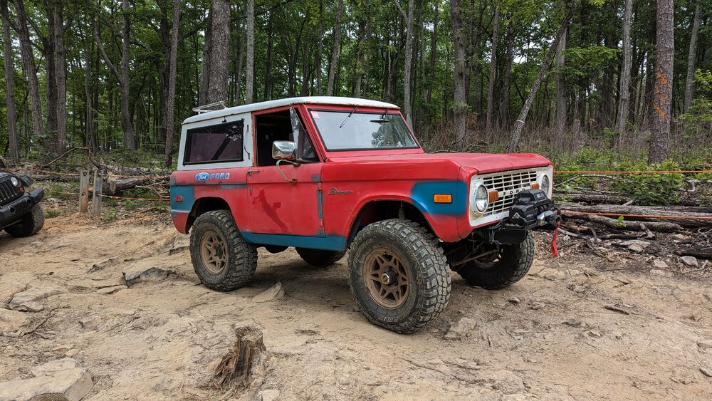

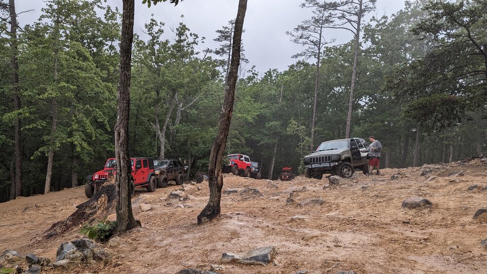

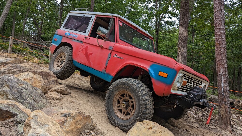

First trip to uwharrie was a success! A few hiccups. Fuel pump connections kept coming loose. They are a push on style connector similar to bullet connectors. Frustrating but not a huge deal. Also managed to shear the cotter pin for the pin in the clutch pedal linkage so that was an interesting fix. Other than that my only major issues were that I tapped the fuel tank 2 times because I left the skid off. Not intentionally but I ran out of time to get it on and wasn’t thinking. Ran wolfs den, lake view, falls dam, lower half of Dickey bell and back side of Daniel. I didn’t do the hill climb on Dickey because I didn’t want to risk anything and it was starting to rain. We were turning around at that point either way. Did good on back side of Daniel despite the rain starting to pick up. All in all, a good weekend. Plenty of things for me to touch on before Veterans Day when I’m going out again. Already have the bronco stripped down partially to start working on getting the paint updated to the new color in the meantime. I will also probably work on getting some bump stops and the new (used) springs swapped in.

Throw a front lunchbox in it, and it will make a world of difference, without changing the road handling at all.
That’s what I’ve been debating doing. It was crazy slick out there but it still did pretty good and did everything I asked of it.

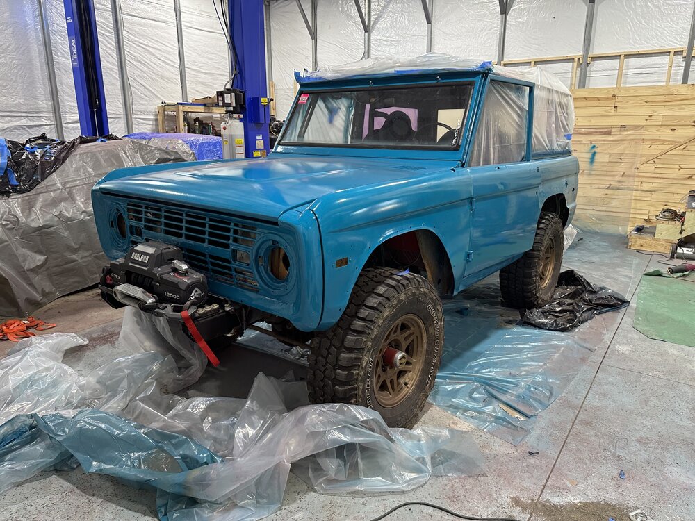

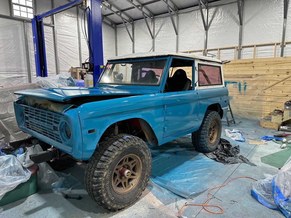

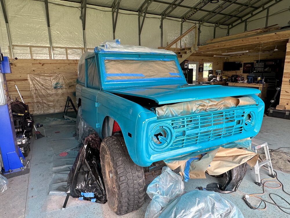

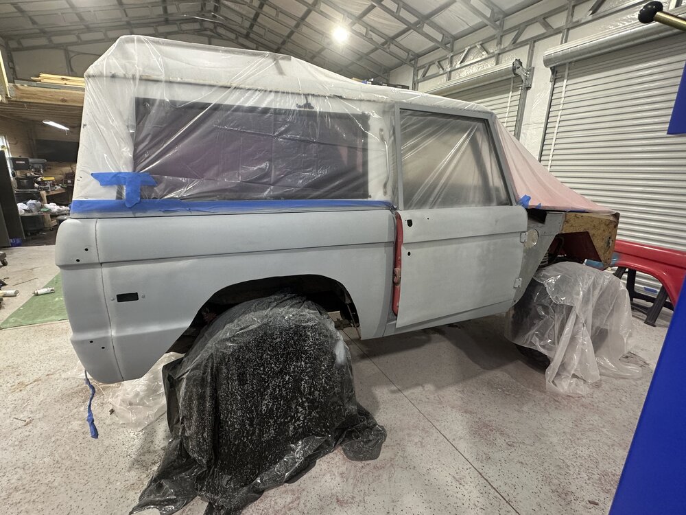

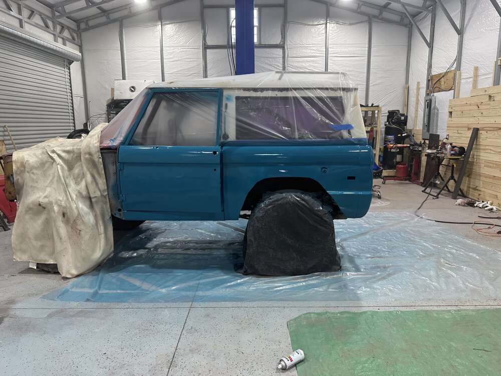

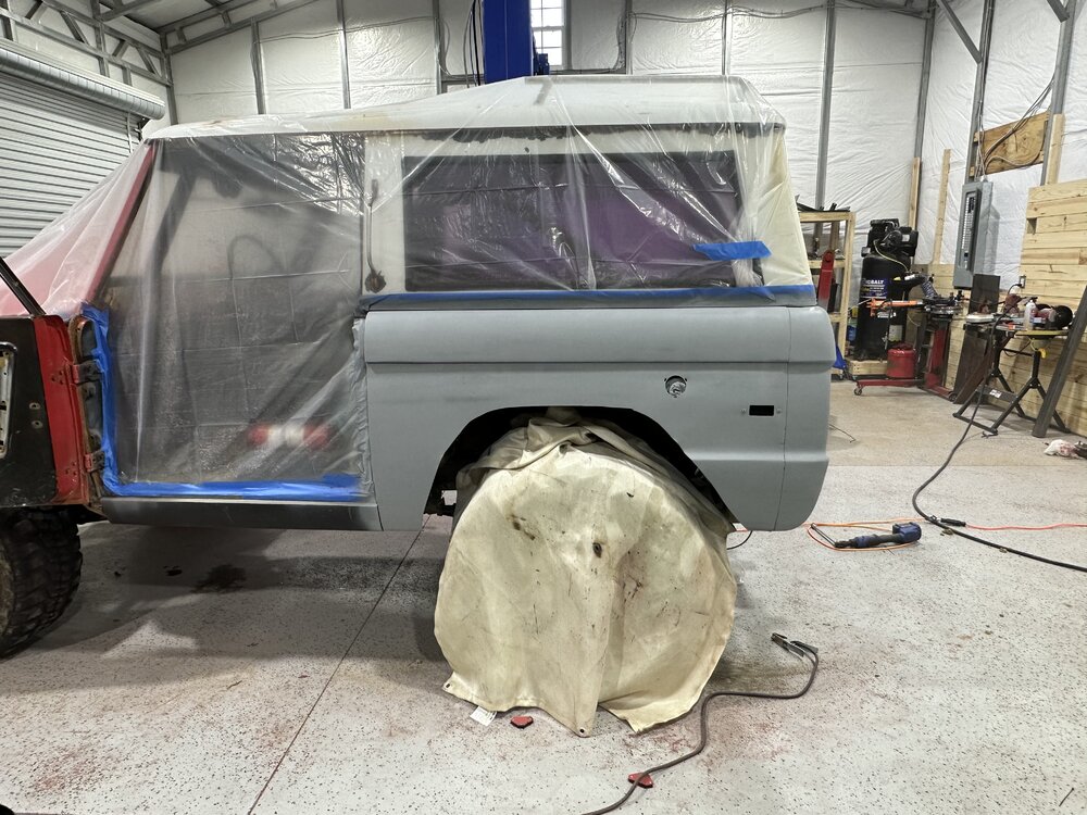

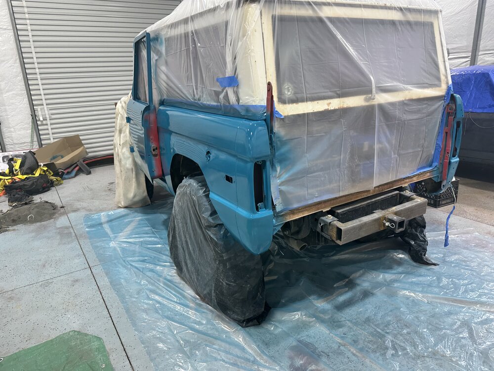

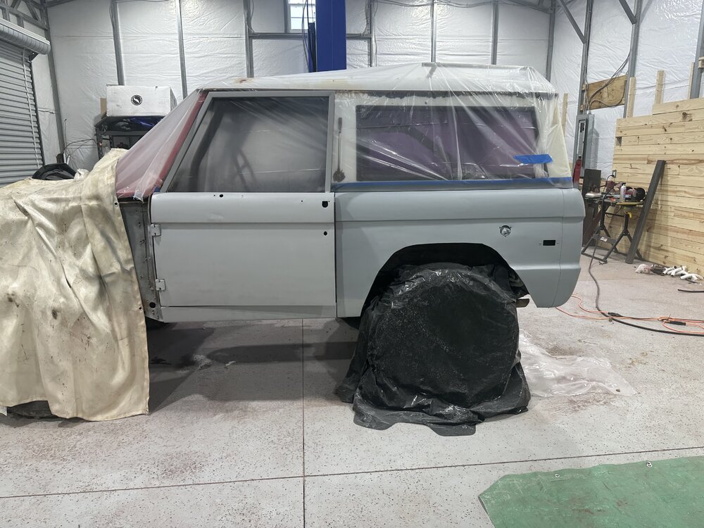

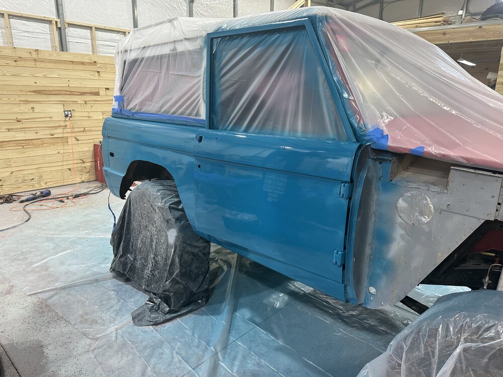

Quick update on the rattle can paint job for the bronco. It’s a solid 30 footer so far. Will probably end up shooting some canned 2k clear over it after some wet sanding to try to get rid of some runs and rough spots but it is looking good so far for a wheeling rig.

Oh, I figured out a portion of my bog while at uwharrie. I kept having this dead spot between just over idle and full throttle. Ended up bumping my accelerator pump linkage up to the top slot and now it feels much better! I still need to get it on the road and check it some more, but for now i'm happy with it.
I still need to get the panels finished but looking great so far. Some rough spots. I have the 2k clear and am debating between wet sanding and buffing or wet sanding and shooting with clear. Haven’t made the decision yet. It doesn’t sit outside very often other than when we are on the trails or for a few days when we get back then it gets parked in the shop for insurance reasons. Is clear going to be worth it? Might just spray the 2k around the fuel cap to save the paint from fuel? Haven’t figured out that much yet.
You can always rebuff/ spray a new panel with no worry of color match if you don’t clear

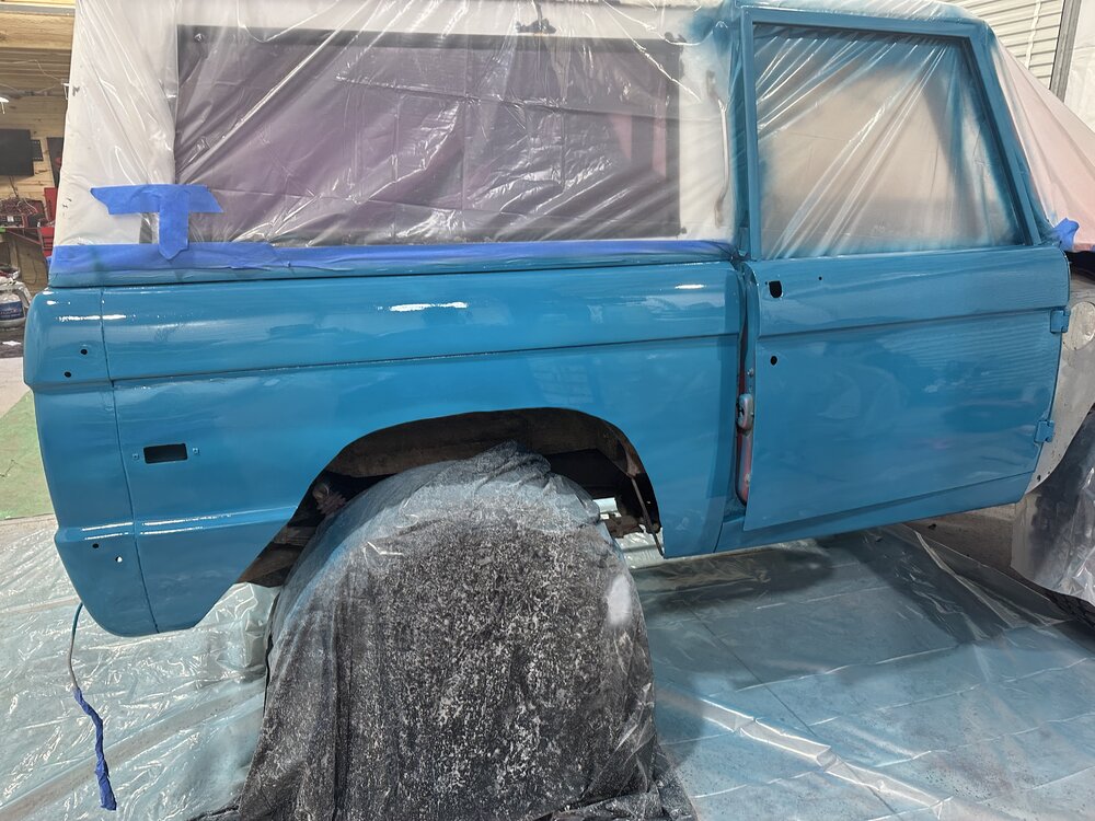

Well I sanded with the orbital and knocked the gloss and rough sections down m, wiped it all down and today put another solid coat of color on and some clear. Looking good from what I can see. A small section on the hood where the spray paint changed color but that’s to be expected. Looks great from what I could see before I had to exit for it to air out. Hoping it looks good tomorrow when I start unmasking.

Can't wait be careful you'll soon have it to nice to wheel!
That’s why I didn’t want to get it professionally done. At this point I know I can always touch it up myself for $30 to do an entire panel. Looks good unmasked for the first time in a couple weeks. There’s a few runs and a rough spot or 2 but overall not bad for what it was.
Looks good from here 👍
